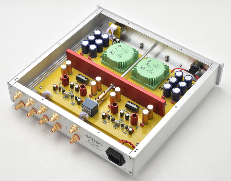

Inexpensive preamp kit on Ebay
Good idea.
You have the schematics at the first link of post #36.
Also take a look at this.
Isn't it pretty ?
Patrick

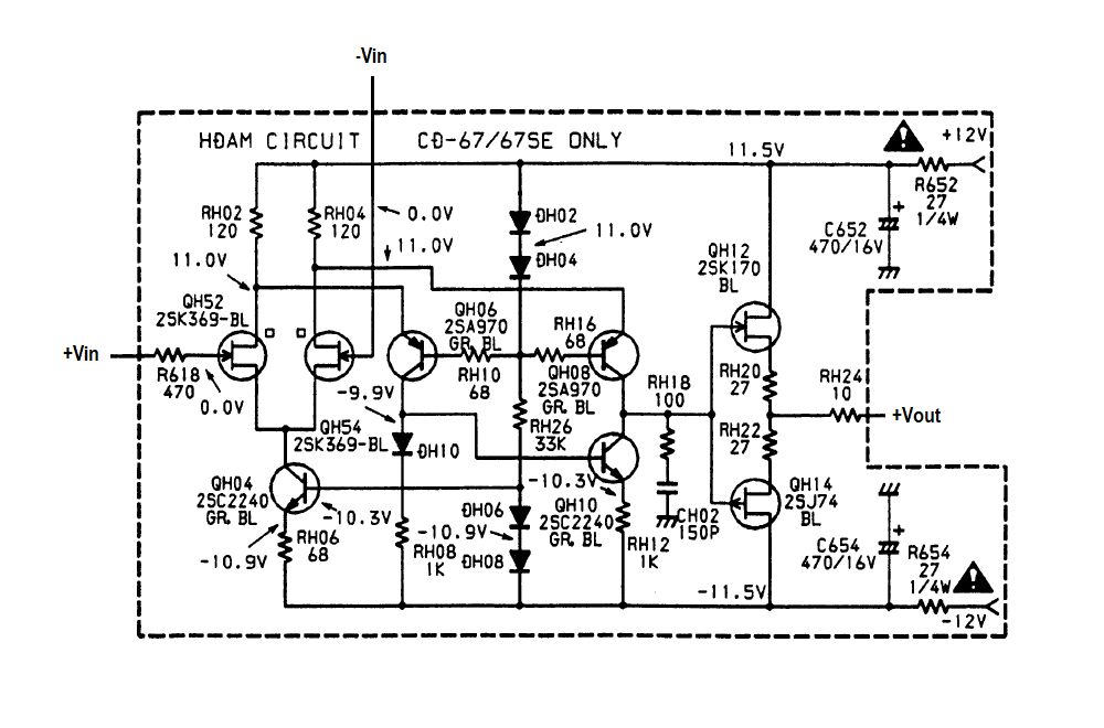

Let`s have a look at making our own PCB since it isn`t available. The parts are and I would like to make some improvements.
Chris & i are already working on a proper schematic drawing. My second all SS circuit drawing, i am figuring some stuf fout (like how to represent the LSK). I can fumble my way round a tube circuit but i have yet to get asolid handle on SS.
Once we have it buttone dup i’ll post it so others can start thinking about it.
dave

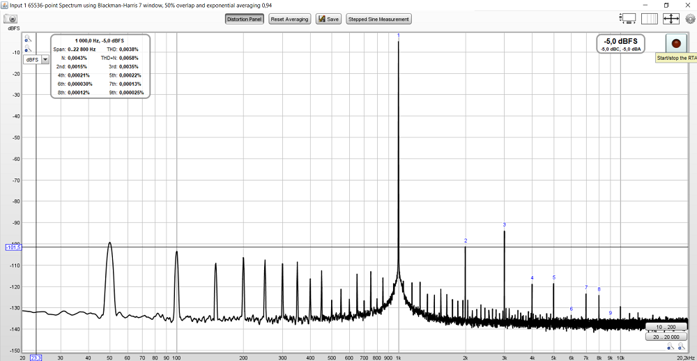

This was originally meant to be a portable headphone amp with Sziklai output.
It does 0.0015% H2, and 0.0035% H3 at 0.57Vrms into 32R at gain = 10 with only 25mA bias, which is ridiculously good.
For another project, I took out the Sziklai and just used the output emitter follower as a line amp.
JFET input, all active devices available readily at Mouser / DK, very low current consumption (<10mA).
No loop negative feedback. DC stable to +/-1mV without servo.
Just to show you what can be achieved without resorting to unobtaniums.
Patrick

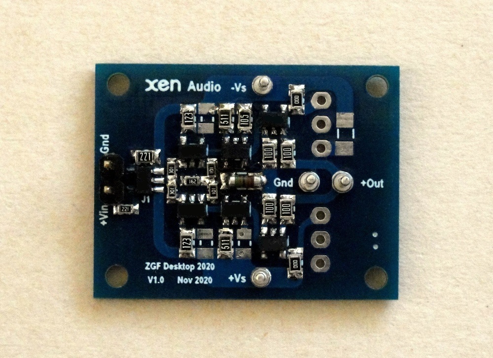

Hi Patrick,
No problem. We are talking about an alternative to that kit. All the parts are available and also easily substituted.
I would suggest that using increased bias current to optimize the distortion performance would be reasonable, removing low current draw from the design requirements.
How does everyone feel about a surface mount version? All the current devices that are good seem to be in this format.
