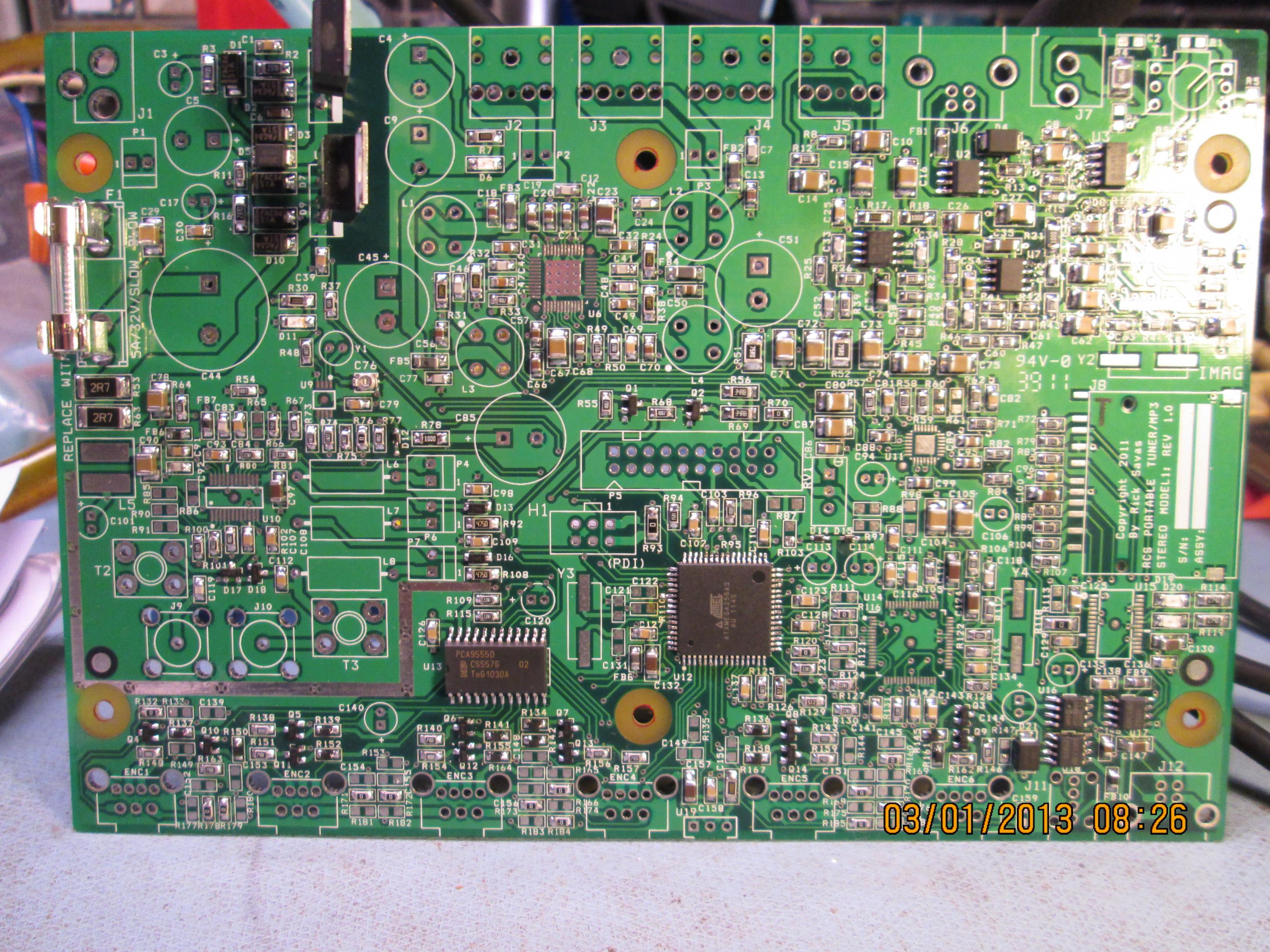

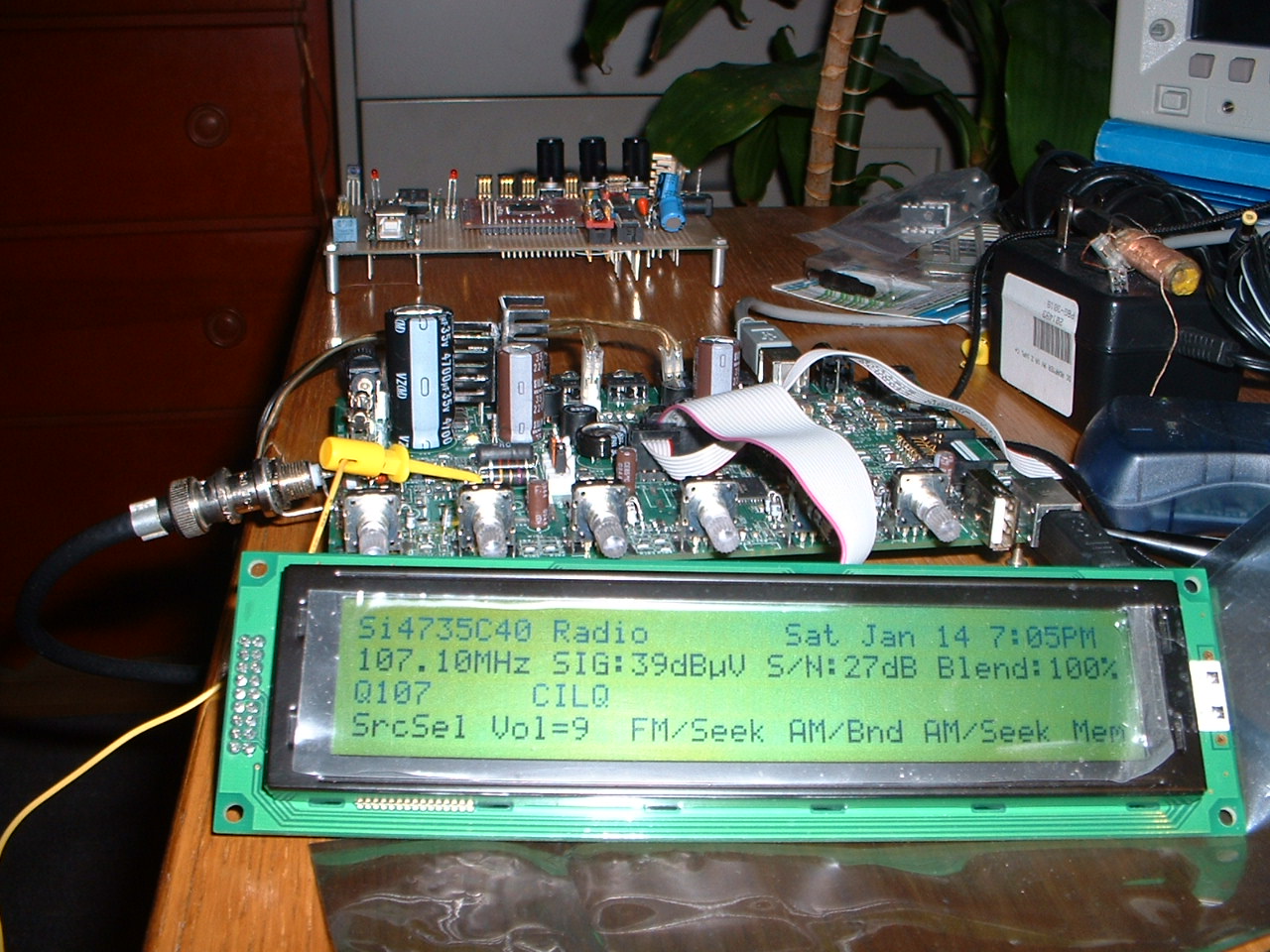

Yeah it has tons of non-volatile memory, a big super ecap, Atmel xmega MCU.
It is a AM/FM/SW radio, MP3 player, USB codec, RTC, headphone amp, TI class D speaker amp. Maxim discontinued the MAX9729 on me. Only two portable radios like it in the world.
I gave up, got bored of writing code.
