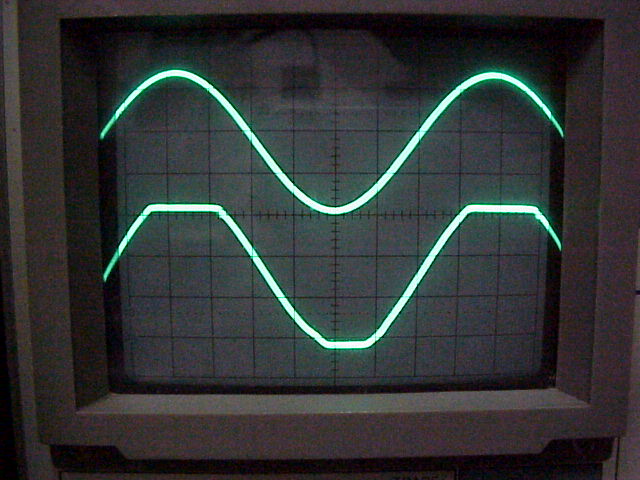

Netlist and/or Edwin
did you guys look at the output of the amp using a scope? If so how does the waveform look in proximity to clipping at say 10 kHz looks vs. at 1 kHz?
grataku said:Netlist and/or Edwin
As I remember; I looked with my old 20Mhz scope (Hameg) from 1hz to 200Khz from sine waves to square waves from low to full power and all looked about the same to me. They even clipped the same regardless of the frequency 😉 The only difference was in amount of power and the loss of dB because of the higher frequency. All into 4 ohm and 8 ohm power resistors.
When using a square waves the rising and lowering times of the squares looked the same at 1khz 10Khz and 100Khz... I use 10pF instead of the 5pF. With 5pF I got overshoot on the square wave.
Edwin

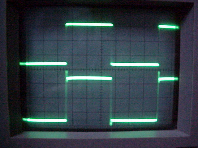

Grataku, what waves would you like? Squarewave to see the pattern, or sinewave to see the clipping? Or both?
/Hugo - will take some pictures. 🙂
Netlist: How would you qualify these results? Are you happy with them, or do you think that the performance needs improvement?
Also: I sent you a message through the forum yesterday, did you receive that?
Amp looks cool though 😎

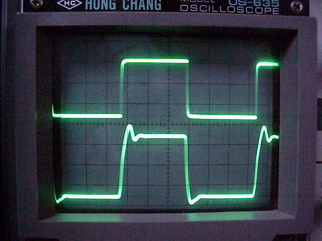

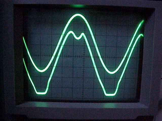

Hugo,
I don't recall getting any emails from you, is it something we can discuss here or do you want to try again? 😉
Thanks for taking the time with the pictures and all, it's very helpful.
The reason why I asked about the waveforms is because of the strange clipping with sharp 'features' I am seeing at and above ~10kHz/8ohms.
At 1 kHz I would say my sinusoid looks a little bit cleaner than yours. But in general it's pretty much the same. It basically looks like the little singularity you see on your top wave at the right edge where the flat edge meets the sine waveform.
Could this be a characteristic that is intrisec of two stage designs where the distortion increases enormously close to clipping? I don't know I am asking.
One piece of good news I can give you is that the clipping I see in your 1 khz/8ohms sinewave could be made alot more symmetrical and the distortion in the bottom half could be substantially reduced by putting pots in place of the sensing reistor like edwin did and adjusting away. I did the experiment. Maybe I am too optimistic. 😉
If I can make another observation, the square wave could improved by adding an additional 5pf in the feedback, that should kill the ring down you are seeing.
When the board was made we should have probably built in the feedback caps as traces, that way, symmetry in the phase behavior of the feedback would have been closer, we didn't know enough at the time and chad and I where too eager to print out those 800 boards. I did make my feedback network using a pair of 5pf silvermica per side and I did match them up.

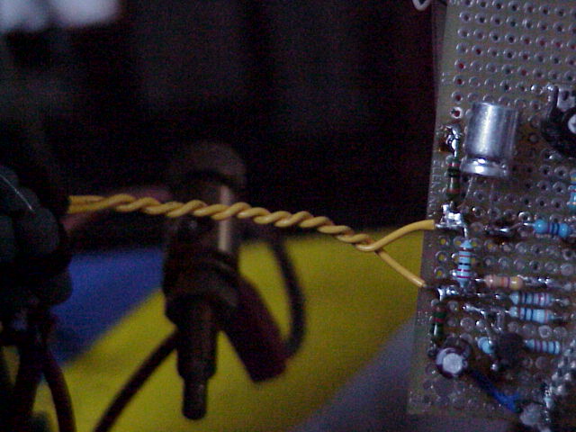

Netlist said:10Khz 4ohm
try to raise the capacitor to 10pF ! You can do this by putting two of your 'old' capacitor in parallel. So if you have them flying around it is worth a try. Your square wave will clean up with this higher value! No ringing whatsoever ...
Edwin

The squarewave in the 10Khz and up region can be better and I will work on that. Nevertheless, the amp sounds great.weeghel said:Netlist: How would you qualify these results?
