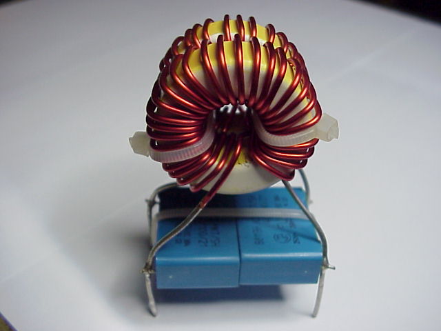

Is (3) more likely when two transformers ares used? (one for each rail)
Moderator
Joined 2003
1) Is not the case.
2) Is not the case unless 1mV DC average is too much. When the hum occurs the DC doesn’t rise. Max DC is 2.235mV measured over a period of 30’.
3) I can’t imagine both amps draw unequal currents exactly at the same time when not playing any music. Dc at the output is quite stable and within specs range.
The hum occurs definitely when my neighbour is welding.
I am however not able to measure big differences in the AC power condition then.
So how would a filter network look like?
I found an example in Elektuur, showing 2 100nF capacitors and a 30µH choke in between. I made it a time ago but never used it.
/Hugo
Disabled Account
Joined 2003
A filter like this one will block mains DC (C1/4 and D1/2/3/4, the rest is EMI filter).
Another thing you could try is using a Zobel snubber on the secondaries, as described here (while I've used this to get cleaner power, in one case is shut up a singing transformer; but good luck calculating the correct values if you don't know the parasitic capacitance and inductance of the transformer, maybe trial and error...)
