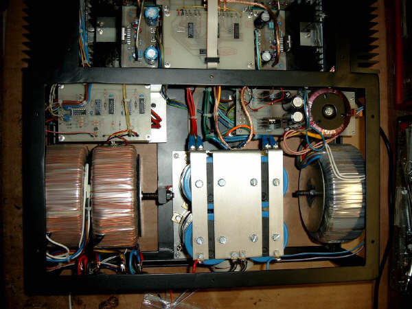

Just like a few other people who send their picture to Desmond,
my AlephX's are now too in the 'Gallery of Fame'.
It's a great pleasure to see them there.
Thanks to the whole Passdiy team
/Hugo

Over the past few weeks I noticed strange behaviour from the toroids. You all know the buzz a toroid makes at start-up, drawing a lot of current for a few seconds.
This buzz comes up randomly now, when the amps are powered up. Maybe it has always been like that except I only start notice it a couple of weeks ago. Suddenly both transformers start to buzz, very equally for about 5 to 20 seconds, then the noise disappears and comes back few seconds or minutes later and so on. Doesn’t matter if they play or not. There's no vast timing for the effect, it can happen twice in a minute, or twice in 10 minutes, more or less. Both amps are hooked up on the same power line so I started measuring it. Voltage varies between 228-236V. Frequency is a stable 50Hz, +/- 0.01Hz. Positive and negative dutycycle point is 50.25 and 49.75. DC +/- 1mV. I also measured the current trough the amp but it sits there nice and stable at about 6A all the time.
The funny thing is that no difference can be measured in all these conditions when the Buzz comes up. I then connected one amp to another socket from another circuit. Same problem.
Any thoughts?
/Hugo

I might have found the cause.
My neighbour has a big electric welding machine.
His workplace is located in a part of the factory were we live and taps from the same source.
I also noticed that when the transformers is buzzing, the dutycycle changes more from the ideal 50%. From 50.3 to 50.8 .
So if I would change the recifiers, could that solve (part) of the problem?

william
There are three typical causes for intermittent mechanical hum
from the transformer.
1) Your circuit might intermittently draw very large amounts of
current. This is not very likely.
2) Your AC line might have some DC type noise on it, which
saturates the transformer. Lamp dimmers and other Variac
type controlled equipment are the usual culprit, and a filter
network is the usual answer.
3) Your secondary system might be drawing, on average, more
current from one rail than the other, in other words, different
+ to ground than - to ground. If the secondary windings are
mismatched and you are using only 1 rectifier bridge for the
two polarities, this can cause the same kind of saturation as
in (2). This is common when there is high DC offset at the
output through the speaker. Besides balancing out the draw,
you can also cure it by providing one rectifier bridge for each
rail polarity, assuming that you have dual secondaries and
not just a center-tapped secondary.

1) your right
2) not possible with a balanced ac power
3) this was the cause for quite a bit of mechanical humm from my Ono where the plus draws more current than the minus side but it doesn´t work for my Aleph with two bridges per channel and quite low (30mV) DC offset
Any explanation for the bad influence of connecting a 9V AC transformer to the same 230V power line????
william
