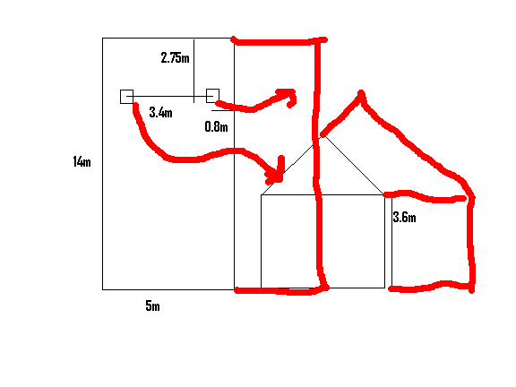

About the speakers and their placement: They now stand about 0.8m from each wall, but there are 3.4m of space between them. (Always measured from cone centre.)
One would expect a 'hole' in the centre when listening. That is not the problem. The lack of bass when sitting in the sweet spot is the most annoying. When walking trough the room, the best place to hear the low frequencies is standing just near the sidewalls, but that’s far away from the sweet spot. Moving the speakers closer to each other doesn’t approve things for the low region.
As I said, it’s a strange room. Picture attached.

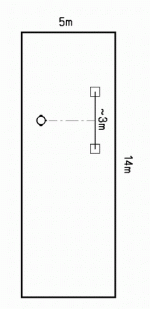

Hugo,
that`s a huuuuuge room!
Unfortunately the proportions are indeed very strange and not very good for audio.
Once I have heard a really expensive High-End setup (in those days) with Backes&Müller (not my favourites) activ speakers in a very similar sized room and placement and it was just bad because the room acoustics spoiled everything.
Attached a picture (correct proportions - more or less) of how I would try to place them (or to begin with).
The location where the speakers are at the moment are highly unsuitable regarding three things:
- the very early reflections from the very nearby located walls

Cocco,
since you are redocorating, how about this?
The question is: would a different pair of speakers that could be positioned more correctly in the room sound BETTER than a badly positioned pair of 800's?
PS. If you ever watched the american football commentators you'll know why this is funny. 😉
Nice comments and ideas.
First, these monsters way over 150kg (300 pounds), so walking around with them is not the easiest task. (certainly more than half an hour) 🙂
Second, the proposed place by cocolino could be an option but they then stand on a wooden floor with a cavern underneath which again wouldn’t be to good for resonance. But, it could be worth trying.
An ultracurve is proposed too, but as I say moving them around is not easy.
So, the width of the room is 5m. Lets suppose we place the speakers as proposed. They should be at least 0.5m from the wall, I assume. The speakers themselves are 0.6m deep. That’s already 1.1m.
We then have 3.9m left. Counting the seat where we listen another 0.6-0.9m we would have the sweet spot in the perfect place. Hmmm…something to consider.
/Hugo – will call grataku to redecorate

Hi grataku,Cocco,
Hey..... that`s just great ...actually much better than my suggestion!
How comes that I have not thought about this!?
Hugo, what do You think about this slight modification?
I believe WAF will be delighted!!!
I´m convinced that a decent $2000 speaker but well placed in an optimized room beats any bad placed super-duper-ultra 20k$ speaker in a really bad room by far.The question is: would a different pair of speakers that could be positioned more correctly in the room sound BETTER than a badly positioned pair of 800's?
I have heard it and I have heard this 800`s in an unsuitable room at a Hifi-Show - I left the room after 3 minutes.... and in another listened & enjoyed a small 2-way system (Sonus-Faber) more than half an hour!
And no, I have no clue from American football and neither know what`s "redocorating"? 😕
I know, but that`s not such a big problem when the floor is even (otherwise I admit You have a problem) - use a (worn! otherwise W(AF) again...You know...) towel and put it under the speaker - You should be able to pull them (maybe with some assistance of WAF pushing) - that`s the way I move my 150kg sub - works fine (I can move it even alone this way).First, these monsters way over 150kg (300 pounds), so walking around with them is not the easiest task. (certainly more than half an hour)
Well, wooden floor might bring problems but probably another placement cures more that the wooden floor can harm.Second, the proposed place by cocolino could be an option but they then stand on a wooden floor with a cavern underneath which again wouldn’t be to good for resonance. But, it could be worth trying.
Moreover should this placement turn out to be really better and they can stay there, another slight modifcation can help here.
Easiest way is some kind of decoupling through soft materials or more extensive as they are not too far from the wall now (I guess 1,1m baffle to wall in the back is fine) some kind of steel construction anchored in the back wall on which they can stand. Or hang them from the ceiling. Just some first ideas🙂
One thing is for sure - You get rid of the early reflections this way.So, the width of the room is 5m. Lets suppose we place the speakers as proposed. They should be at least 0.5m from the wall, I assume. The speakers themselves are 0.6m deep. That’s already 1.1m.
And as You don`t sit in the middle of the room anymore but with the wall in the back, bass should be better too.
As the wall behind You (listening position) would be a little near now (inevitable in this case - but ...
Next step could be experimenting with some absorbers to fight standing waves if they still are a problem.........but hey that`s an Aleph-X thread .... we are in the wrong department 😉
Anyway, when You actually try this be prepared that Your system will sound so completly different from what You`re used to that it may take a while until You can judge if this is actually better or not.
