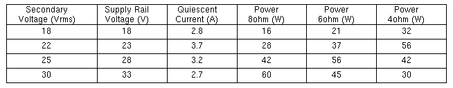

JLH Class A: which version?
This version needs a few small mods, which have all been discussed in the text. In fact, I think some of us will have to work on the schematics and incorporate all the mods into whatever schematic we want to build, and keep posting the schematics here and making changes, before we finally freeze on the schematic. I am no longer sure we can simply pick up the schematic that Ashok had pointed us towards, and blindly build that one.
One of the reasons I like this version more is because of the parallel OPS transistors, thus allowing me more safety margin in case the cooling is not up to the mark. (JLH was a Britisher, who may have been quite clueless about Rahul's Lucknow summer. 😀 ) With a Class A, there's no point going in for forced cooling, because there's no point striving for the ultimate in sound quality and then raising the noise floor with fans. Hence, the cooling is always one area where safety margins will be useful. I have a few thermal switches; I'm certainly going to use them on the heatsinks for any Class A I build. 🙂
And if we build this higher-powered version, we can actually get upto 60W into 8Ohms, or 56W into 4Ohms (with a lower rail voltage). That would allow us to power some larger speakers for useful SPL levels. See the table I've attached below.
What say?
Is it still 10W after the 2003 mods? I remember that the 1969 version (the original) was 10W, and the later one in 1996 had a 15W rating and a symmetrical power supply. The latest updates are here. In this page, you'll find the schematic that Ashok had posted earlier, plus a higher powered version:Rahul said:Power output is in range of 10W....
What say?

Rahul, can we look at the higher rated versions ? Are we going to agree on one version or are we going to have individual preferences obliged ?
