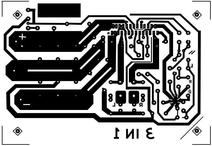

1. LM 4780, regular NS application. However with some creative wiring can be configured for bridge (bridge adapter needed), parallel or stereo. I've explained it in some detail halfway down my post. Each finished amp needs two chips, in pure dual mono.
2. D-K orders can be taken by me. I think only the chips are needed from there, and possibly output MFRs. Rest is readily available in Mumbai.

I also don't want a readymade PCB design. The only one I've seen which I like is the Brian Bell/Peter Daniel design, but I think that's too expensive for the group buy (I bought two sets for myself, but that's by the way), but it's nice and compact and is reasonably easy to put together. The PSU PCB is minimalistic which is good, but needs MUR860 (I was thinking chassis mount briges) and gets very fiddly once you start adding large caps and snubbers.
SO I need a collaborator, not staright copying.
OK I should have clicked the link before shooting off my mouth, I see it was your design.
I need it to be double sided. The chip is very fiddly and a compact layout is a must, not possible with single sided.
I think we should switch over to 4x3886 and use P2P to achieve the same objective.
