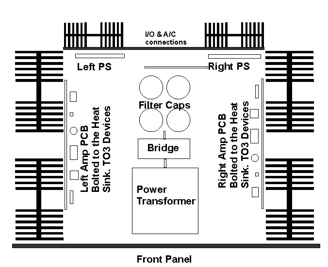

I have attached a proposed layout. This has been playing in my mind for almost a year now. Have a look.
Rahul:
The above addresses some of your views too.

Boss we are gonna use TO3 devices. More traditional approach of mounting the MJ's on the heatsink, rather then a "L" Bracket should be adopted. But I agree that the PCB should be mounted on the Heatsink with 4 suitable spacers.All the OPS power transistors must be along one edge of the PCB, for heatsink mounting.
Track to the grounplane should be as short as possible. Even a seemingly short length of track has resistance.Wide tracks, largish solder pads, and multiple links to star ground wherever needed, so that one can eliminate any ground loop type problems.
Yes.With this mounting strategy, I'd prefer to have the RCA sockets and other things off-board.
Each Channel will have its own power regulating board. For both the rails. So total 4 boards for the '+' and '-' rails. Even the transformer will have two secondary of 25volts each,So I too would like a PCB for PSU.

Looks cool. I'm in!I have attached a proposed layout. This has been playing in my mind for almost a year now. Have a look.
The chassis layout will not have much of a bearing on my plans, unfortunately, because I want to build active speakers, hence my chassis will combine multiple amps of various types. But this is incidental. The point is that I'm in. Slurrrrp! 😀

TO247 pads on PCB provide easy adaption to any type of transistor mounting ie wether direct on heatsink, thru L bracket or TO3 on heatsink.
Ashok now what ever they say abt India shining I see experience shining. Fantastic layout. One more point of interest that these heavy version of heatsinks are available in plenty at Agra and small sections can be combined to cater for all devices ie in output or the power supply. We can easily get an ms section frame made. All heatsink cut to one size and mounted all around. Finish it off by a cover and a good Al dial. Simple and practical.

That was just a quick rendition. Our final design will need to be much more polished. It will be.small sections can be combined to cater for all devices ie in output or the power supply. We can easily get an ms section frame made. All heatsink cut to one size and mounted all around. Finish it off by a cover and a good Al dial. Simple and practical.
The Heatsinks housing the OP devices will be thermally connected to each other. "L" type AL angle will be bolted to the top and bottom. Left and Right Heat Sinks will be bolted to the AL front panel and again a "L" channel fabrication in the back.

I'm in for 2. The chassis layout looks cool, really mean actually, with the heatsinks on all 3 sides. If it is a dual mono will there be space to put 2 transformers next to or behind each other.
