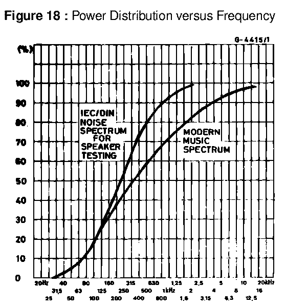

Hi Sunil
High: 15 to 20 watts approx
Mid: 40 to 55 watts
Low: 100 to 120 watts.
I'm sure your active XO has gain setting for individual freq band. You mentioned that you have changed that 2 way XO to a 3 way. Did you cascade one stage or did you add an additional stage to the existing design. Quite easy actually either way.
I'm sure your tri-amp project will be come out with flying colours. Keep posting the details so that we can all learn.

On the contrary, with separate amps you may get uncomfortable that the 1kHz to 2kHz range. Our ears are most sensitive at this range to any perceived peak in dB and/or phasing...with an average loss of about 5-10db in the average furnished living room with the speakers about 10ft away I was not going to get very good, clear, loud sound, around 90db.
Yes you are right. Messing around with the so called golden band is not advisable. But my only worry with this thinking is how to find squawkers that handle things less than 700Hz nicely. Back in my younger days I had a wonderful book called "Build and Test your own Speaker System" or something like that. It proffered a thumb rule of xoing at 800Hz for an 8" woofer and 500Hz for 12". I built many speakers with that in mind. They sounded quite nice at least those days, when we mostly listened to loud Led Zep or Deep Purple things.The x/o is crossed at 3500 & 200...These crossover points don't fall in the critical range of hearing, or so I hear.......
Yes and No. The time alignment theory by voice coil placement at best is erratic. Not a problem by itself when you consider what bigger mistakes one can make by aiming for that socalled symmetrical placement idea relative to the other enclosure.Even if they were time-aligned would'nt there be phase alignment errors with the cone of the midrange having to move a lot more than the tweeter. Is this a valid argument ? Isn't this a problem by itself ?
Actually a bigger problem occurs within your amp, where the entire spectrum of music is fighting for a fixed power handling capacity and looking to out put the same level.They are not going to contend with each other for power on loud passages or during dynamics.
Since you like to listen to music at a robust level consider the following power bands amps for tri-amping:This is why I am keen to get a low power amp for the tweeter, something that is sweet & won't be harsh at the volumes my hearing-impaired brain likes to listen to

A good rule from a more modern source (Vance Dickason's Loudspeaker Design Cook book) says that if you build a 3-way, you should either have one decade or at least three octaves as the minimum gap between the lower and upper xo frequencies. This means that one-decade gap translates to 300Hz-3KHz, or 200Hz-2KHz, and so on. Three-octaves is a little less.corbato said:It proffered a thumb rule of xoing at 800Hz for an 8" woofer and 500Hz for 12". I built many speakers with that in mind.
I find this diagram useful to understand music power distribution across frequencies.High: 15 to 20 watts approx
Mid: 40 to 55 watts
