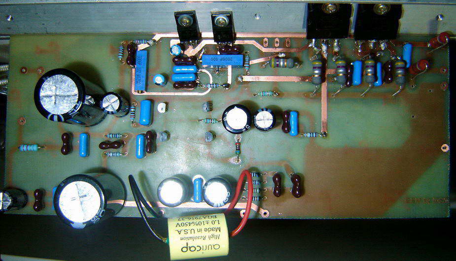

hi.... im Eddie....
well my name is Edgar but can call me Eddie... i prefer....
as i can ill post... more picts... n comments...

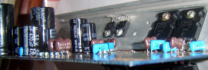

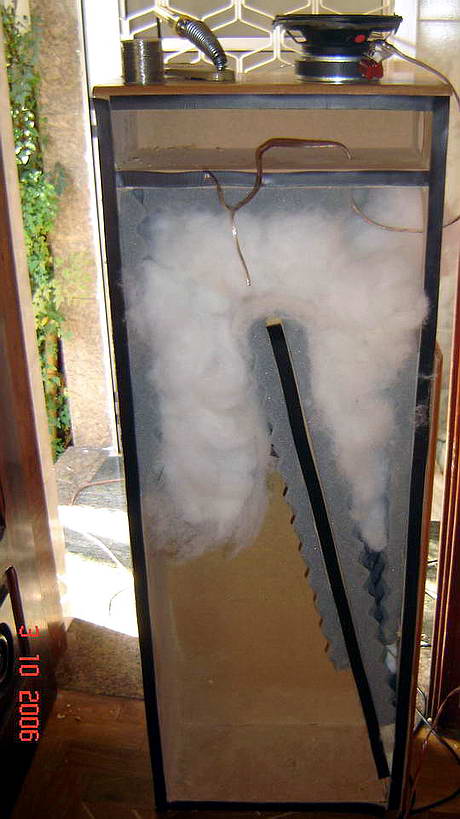

i just finished... my ML_TQWT...
the pads....
1,2 - audio input
3,4,5,6 - power supply w/ 40mF
7,8 - cap 1uF Auricap bypass
9,10 - choke
dun know.... if this Toshibas r fakes.... but ill test... n report u...
im using in this tower....
tw Hiquphon OW1.... w a solen cap of 4.7uF
and a mid made by a Paulo Ramos...
Akron KB6 with a inductor of 0.3mH 13AWG

having some troubles... to make the choke of 2.5H.... and sure... to fit all the project into a cabinet...
cause....
its 2 toroidals, 2 capacitive banks w 40mF, a motorized pot to volume and a IR circuit to control the pot....
eaoyama said:
the caps.... w value 22pF 220pF, 47pF 100pF... are silvered mica...
the 100nF n 220nF 680nF... r metalized polyester
all resistors r metal film....
resistors 0.47R n 2.2R n 1R r metal oxide film....

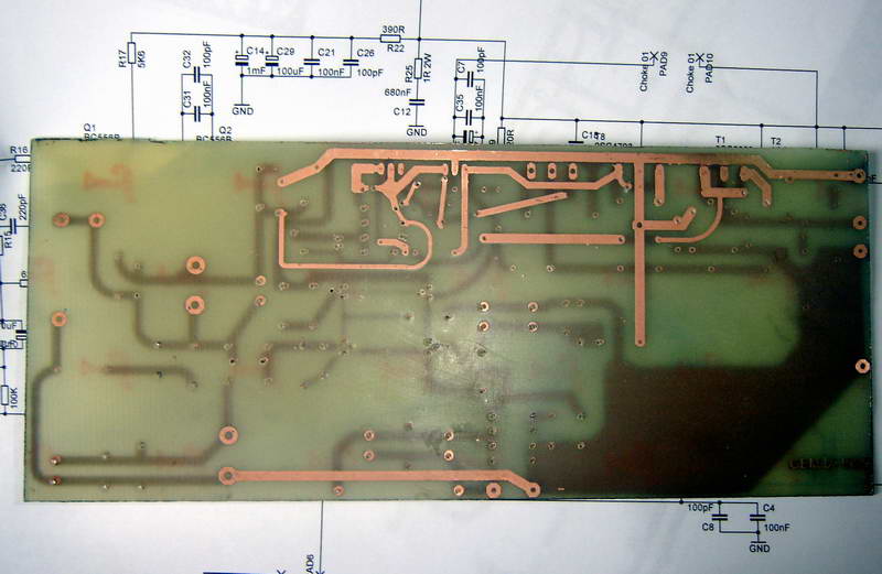

Eddi ! Your schematic contains errors, one is the missing connection between collector and base for t10. Also emitters of q1/2 are not connected.
If you built that schematic, the amp will not work at all.
