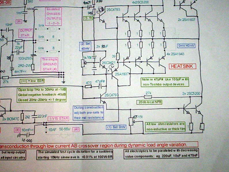

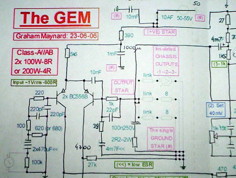

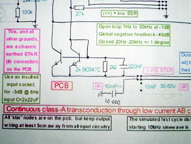

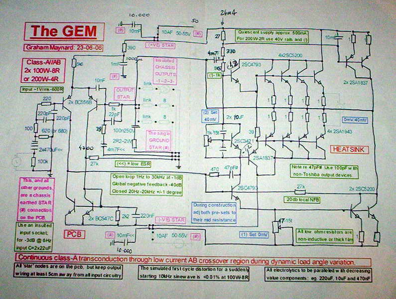

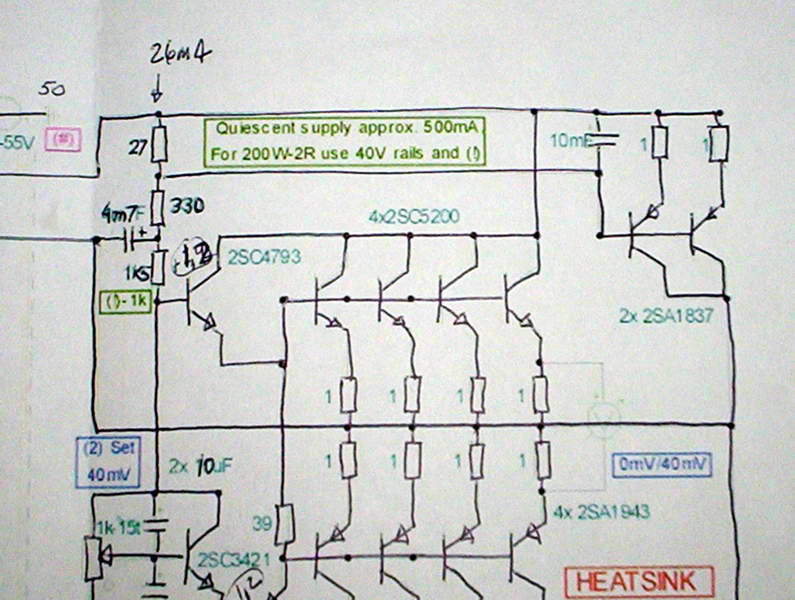

I have a printed version made in June 2005 that is very nice
In near future i will publish.
It is a GEM version, by Graham, using transistors in the positive rail, and those are for the class A amplifier...they are complementary.
This is something less good in audio quality, but better to construct compared with the enormous Choque proposed by the last diagram published.
Do not tell the people...our secret...but Graham will not feel happy as i will show some schematic that was superated by his last published version...well, this may produce good results..he may enter to defend his design, not happy with me..... but all forum may have his valuable presence...i will loose his respect and friendship...but you all will have Graham again...good business in my point of view.
I cannot publish immediatelly as my Scanner supply is damaged.... and i have only a single printed page about it....i have not a computer image file, a digital data about that schematic.
Near future i will be back here to publish.

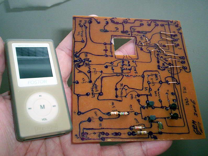

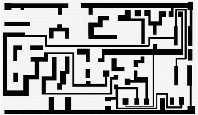

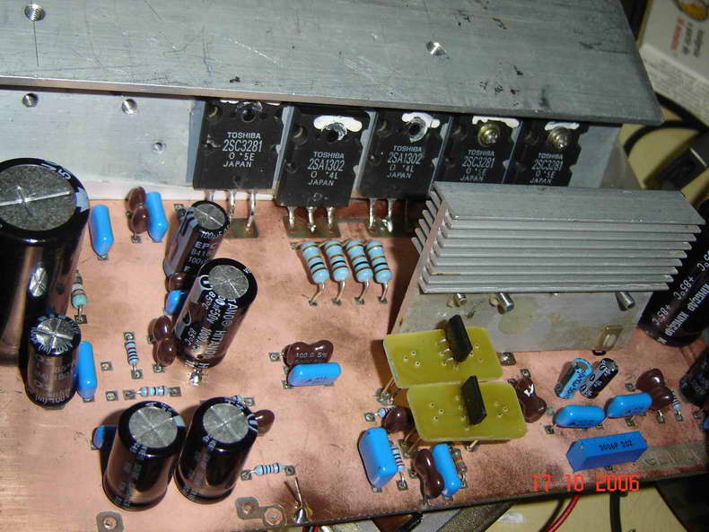

I will try another GEM model...but i have 4 in the strip to be made
I have started with a fast board...the awfull jumpers will go downwards de board...also the lines draw over the board are only a reference to assemble...they will be cleaned when finished.
Here is the board to be made...will delay a week or more, as i have others amplifiers to construct and listen.

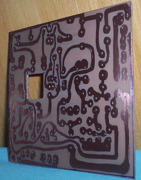

Normally i do not use layout or something alike
Watching the schematic i go drawing over the board....and them the component holes are opened.... finally, watching the over diagram the real copper lines are traced with a permanent pen under the board...referenced using the sketch and the component holes.
Finally to the acid...this waste not more than one hour...and more 2 hours to assemble, adjust and listen.
The acid i use is concentrated...it is heated in advance to the use and it is shacked during the corrosion.
The hole you see is for the bias transistor, to touch the heatsink without long wiring.
The Voltage amplifier, drivers and AB output are around the board, soldered over the board....the extra class A output is connected using 3 inches wiring.

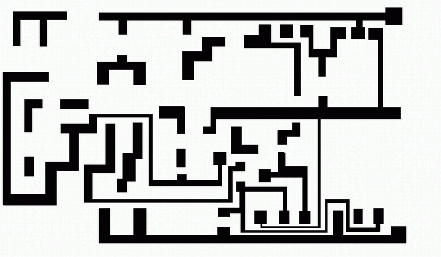

Imagine the pcboard as made with transparent glass.
This way, i am showing you the parts, and at same time the copper lines..... board made transparent to easy understanding.
The ground is the line that has 7K8 resistor (8K2) conected to first transistor base.
Upper line is positive and lower line is negative.
The amplifier work in class A, so the current must be ajusted to 1.5 amperes...if not possible, go reducing to adequate to your supply, and checking the base to emitter voltages, that may be around 600 milivolts.
I do not remember if i constructed this one...maybe yes, maybe not.
Will be more safe to include a capacitor....silver mica or ceramic, from base to colector, mounted near the voltage amplifier transistor...the BD139.
Drivers can be also BD139 and BD140.
Also you can use 2N3055 or TIP3055....in the reality.... the NPN you find will work there.
Of course better transistors may work better..this amplifier is not the last model from Graham...the opposite, it is very old, and has a lot of room to modifications and improvements.
It will give you the chance to make your own unit...and to have a lot of fun.
regards and good luck

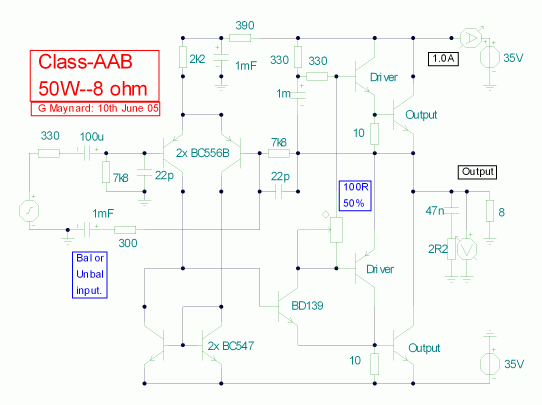

Here is another board lay out .... watching over a transparent board...this is the image's position...observing from up... looking the components...and imagine the board as made with transparent glass...so..you will be watching copper line.
