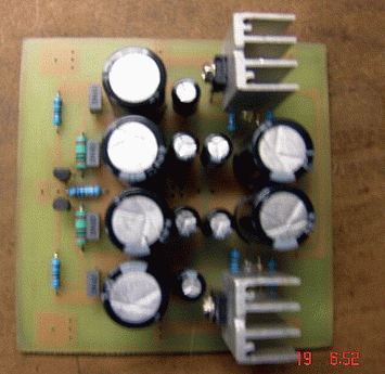

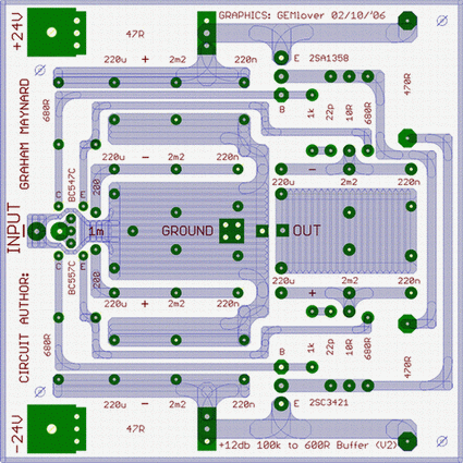

back with news....
this is my pcb in dual layer
more picts
look at the choke.... its a 2.5H w 0.25A........ n i put a resistor to limit the current...
ill post my impress later...
cya!!!
cya!!!

I am showing you the image of the assemblage....the Voltage amplifier transistor will be substituted, this one is a Television set transistor that has low capacitance...but i do not like the gain.

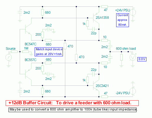

Last inform about the buffer.

Carlos,
I like to use a Grahm to buffer, because with one resistor I can put gain in this.
xD
Thanks for this schematic,
Felipe
xD
