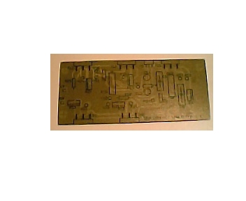

Very good work Barry, those cameras need dailigth, but i can see quality
As i have those kind of cameras and i know they do not define.
Pretty boards, and you decide to use Hi Speed Diodes and pretty big electrolitic condensers....good that...the amplifier need big filtering because of consumption is big too...not to produce low frequency noise into the rails..i am using 15000 each rail..i can see that you are using more...Goood.
Now Barry, GEM is very near to be guaranteed 14 times!
Oh!..i was forgetting.... better to use a resistor in series with the extra NPN transistor...the one is always in classe A...with 1 ampere or more flowing...the adjustment there is not so easy.... carefull with your movements...and fix your meter cables, measuring DC voltage over this resistor extremes.
You can use the one you have...0.1, or 0.22.... 0.33 ....0.47 or even 1 ohm...and use ohms law to calculate current.... fast switch on and off...and install limiting current rail resistors.
I am using a 200 Volts and 16 Amperes unit in that position.

I had posted my version of PCB for the GEM in post #322 of this thread. I assembled the board and tried to test it this forenoon. I was seeing +14volts DC on the output. I simply could not up the bias from what minimum current was flowing ie., 23 mA.
I checked thoroughly and guess what I found!! All driver and Vbe transistors of mine are in TO220 package - 2SC4883 and 2SA1930 - the pinout being BCE; but I had assumed that the transistors that Graham used were TO126 and have done ECB pinning on the PCB.
Fortunately there was no smoke or any visible damage. I am going to snap the Base and Emmitter leads and criss-cross them with insulated wire to make the connection to the PCB. Let us see if this works well since I am hoping that nothing is damaged.
SO IF ANYONE IS USING MY TRACK PATTERN FOR HIS OWN PCB, please bear in mind that the Driver and Vbe transistor pinning is ECB.

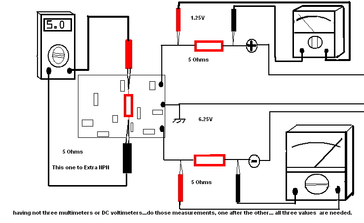

Samuel, as Graham is busy, i will try to help you
Install a 1 ohm resistor into the Class A extra NPN transistor, the one that always have around 1 ampere crossing it.
Because of ohms law calculations, when you have 1 ampere crossing some resistor, will appear, as consequence, a voltage that can be measured by our standard multimeters....you have to adjust to measure something around 1 volt..... then you remove keep the resistor for a while.
You may have, already installed, series resistor connected to positive and negative rails...series connection related the supply...let's imagine that you used 5 ohms resistor.... you will measure voltage developed over it, and this voltage is the entire current that is flowing into the amplifier....in the reality, each resistor will show you half amplifier current consumption...the upper half...and the lower half...observe that this current corresponds to lower amplifier halve... will be measured over the negative rail resistor.
Will already appear there 5 volts...because 1 ampere is crossing this resistor (ohms law).....
Now you must adjust the other trimpot, the main bias trimpot...the one at the amplifier middle, to introduce MORE, 250 miliamperes of consumption to both rails...this is the class AB biasing, and it will be started with bias zero...and you will increase till have this current.

Here is a Sketch, if you already know, i am sorry .
But there are others that do not know how to do it.
To avoid that Doctor Boerer Detailer enter to say that Multimeter polarity is wrong.... i already observed that.... so...users!...if pointer did not move forward...invert polarity please.
regards,
Carlos

Yes, i think so Samuel...the 5 ohms choice was a 7 amperes limiting choice
To avoid unbalance output voltage, do not include speaker for a while.
You can use 0.22 ohms, 0.33 ohms, 0.47 ohms, 1 ohm, 2,2 ohms, 3,3 ohms, 4,7 ohms....in other words, you can use the one you have in your "precious material box".... the lower it can be, better to keep amplifier balanced related output voltages...because, using 5 ohms...if hardly driven, as a mistake related bias adjustment, small voltage will reach amplifier using this junction emitter to collector...using others, not so big value, despite dangerous, are more precise method, that will let you in peace, not needing to retouch adjustment again when removing those auxiliary, series protective resistors.
Again, the voltage developed over the resistor have to be divided by this resistor value, expressed in ohms...to obtain the current without the danger of open the circuit that can cause accidents, as wiring have some spring capacity to produce shorts!... some position "memory".... the desire to return to it's normal position, the one the wire was before you move it.
Using those resistors i told you, the voltage you may adjust, measured over the included resistor that is in series with NPN, Class A, output circuit.(Colector to emitter circuit)
0.1 ohms................ voltage to be measured is 0.1 volts, or 100 milivolts
0.22 ohms.............. voltage to be measured is 0.22 volts, or 220 milivolts
0.33 ohms.............. voltage to be measured is 0.33 volts, or 330 milivolts
0.47 ohms.............. voltage to be measured is 0.47 Volts, or 470 milivolts
1 ohms.................... voltage to be measured will be 1 Volt
2,2 ohms................ voltage to be measured will be 2,2 Volts
3,3 ohms................ voltage to be measured will be 3.3 Volts
This is the "exclusive" class A transistor 1 ampere biasing... above values, are made for beginners, not exactly for you, but for many guys that will print that to turn easier their work without calculators or brain made basic Mathematics.
As positive supply rail will have 0.250 A, or 250 miliamperes...that is 1/4 of the class A biasing current....all values of voltage you will have above, will need to be divided by four.... when voltage measured was 1 volt..... your real result, beeing positive rail, will be 250 milivolts (O.250V).
Yes!..i know you are not an idiot...the purpose is not to explain basic electronics to you, as you may be experienced, this is directed to young diy students, beginners...so explanation is so...so...so....so...let's see..hummmm, detailed.
regards,
Carlos

Carlos and Graham, first of all I must express how much I appreciate your attentiveness and patience. Thanks a ton.
Setting up the GEM is quite different from all other amplifiers I have made thus far. Normally only adjustment of the Vbe pot and output null is required in most amps.
Graham, any of the causes you have cited cannot be ruled out. Oscillation - it is a possible case. With 22 ohm resistors in series with each supply line followed by insertion of 1.5Amp fuses in parallel with these resistors (yes I was lazy to desolder the resistors) still gave me 1.2mV DC at the ouput. I placed a multimeter in series with the positive supply (switched to 200mA DC range) and this was showing overflow at every instance of being powered up but everytime settled down to 43mA DC.
This is where I made the blunder. Without monitoring the current of the lower NPN transistor I tried to adjust the 100E Class A trimpot. The ammeter in the positive line would show an increase of current till about 100+ mA and go to overflow (ie., above 200mA DC). I backed off everytime and each time this was repeated the results were identical. There were no signs of heating up nor was the output offset varying from 1.2mV.
I backed off the bias, the ammeter in the positive rail was showing 43mA. I tried to measure the voltage drop across one of the upper 0.1E resistors. The moment the voltmeter probes made contact with the resistor leads, the negative rail 1.5Amp fast blow fuse broke and both the 22E resistors went up in flames. I immediately pulled out power to the test jig.
Hence, I think it must be oscillation that caused the current to abruptly jump from a little over 100mA to over overflow in the 200mA range each time and the voltmeter probe must have caused a burst of oscillation even at minimum current draw.
I will post a picture of the assembled board. The layout and assembly are too good to cause any oscillation. Even the 0.1E resistors are made of 10 x 1E (2Watt) carbon film resistors. The only two causes could be (i) none of the big caps were bypassed by smaller electros nor film caps even though I have made provision for this on the PCB and (ii) power and small signal grounds have been separated by a 10E 2Watt carbon resistor; so, in the first case high inductance of the big electros could be causing the oscillation or if it is the second case, differential ground potential may be causing the oscillation since this is a high bandwidth amplifier!!
Graham, your recommended method for setting up bias is slightly different from what Carlos is saying. He insists that there should be a resistor of say 5E between negative rail and Emmitter of lower NPN transistor OR between Collector and output node of the same transistor and to measure the voltage drop across this resistor.
Whereas you are recommending 6Amps fuses in series with 0.22E resistors in both the rails and to measure voltage drop across these. I personally (and for no particular reason) prefer your method, but you have advised that the bias should be backed off, the resistors removed and bias set up again. This is were my problem is; once these resistors are removed, I cannot any longer use the voltmeter but have to use the ammeter and the range I am restricted to is 200mA DC.
If I resort to Carlos method, isn't 5E a slightly high value and the wattage has to be quite high. I have lots of 0.1E, 0.15E, 0.22E, 0.33E (all 5 or 10Watts) but they are either fusable type or wirewound and both types exhibit inductance and are known to cause oscillation.
Have I understood both of you correctly or am I missing something?

Hi Samuel,
You are describing an amplifier bursting into RF oscillation as the bias is increased.
This alone can destroy output devices due to the oscillation causing cross-conduction.
I have just studied your pcb layout as per Post#322.
It looks as if you have taken the thick output track alongside the input devices.
This would be likely to cause oscillation in *any* solid state amplifier that is capable of sounding good; ie. capacitive coupling between output and input.
** I did write warning that there should be a gap of say 2"/5cm between the input devices and any parts/wires connected to the output. **
(With correct layout, devices and screening, the GEM circuit is also capable of being used as a high definition video signal distribution amplifier.)
I'd rather use stripboard to achieve a properly functioning amplifier, than having something that looks smart but which compromises performance !
It is also my view that a layout should be tested before time and trouble is taken to fabricate it as a pcb. I was even worried about all the wire lengths on Carlos' 'quick-board', but he did keep small signal input and voltage field generating output connections apart, and thus reduced the chances of capacitively induced RF oscillation.
Sadly, your construction was incorrect from outset, as was Barry's initial pcb suggestions. That is why I drew out a suggested veroboard layout and went on to get Barry to repeatedly change his. I did not realise you were continuing with that layout.
Cheers ......... Graham.
