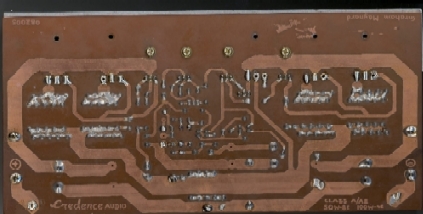

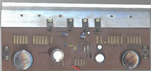

Thanks all for your insight and comments.
As Graham says it does appear that the amp is bursting into oscillation when increasing bias current. Perhaps, my PCB layout is not what it should have been for the GEM. However, most of my other PCBs are also "generally" designed along the same lines and I have had no problems.
I am not going to throw away this PCB. Perhaps, I will try to shield the input pair with a copper foil grounded. I suspect, the 10E resistor that separates quiet and noisy ground to be one cause of oscillation due to slight potential difference between the two ground points. Adding lower value capacitors to reduce inductance is also a must try.
I am just attaching a scanned image of the PCB. The power transistors have been removed for checking. (Incidently I found only one 2SA1943 to be shorted and all other transistors are intact).
You can see on the track side that output is close to 1" away from the input components and the two are separated by what now is "quiet ground". Once I short the two ground points this will also be true ground.
I will post my findings after the next test run. Thanks.
Hi Hugh,
Many thanks for your truths. Hope All's well with you.
______________________________________
Sadly there are those here who have made comment about things about which they have not first gained *direct* experience of;- ie. this amplifier.
I have deliberately chosen to keep the Gem signal path free of the 'compensation' arrangements that are so often necessary with other designs;- ie. 'compensating' capacitors or series resistor/device capacitance arrangements.
This amplifier is different, and thus it needs different construction arrangements too.
If the stated construction requirements are followed, it will run as intended - without oscillating - but this leaves no room for interpretation based upon experience with other designs.
I have just had further communication from Daniel Bosch. He also suffered oscillation, but now reports excellent drive into Apogees from 50V rails. He says it has been worth all the effort and will provide more feedback soon; I think triple AB outputs. He adds that he can't wait to have two monoblocks up and running.
He also concurs that my rules for construction *must* be followed, and suggests I re-emphasise them;-
1) input ground star earthing with short individual connections
2) power rail star connections directly from the 10mF - no shared supply feeds
3) a central output node star connection from output devices to nfb and output terminals
4) keep output star/wires away from input; input and speaker cables also.

Hi Samuel,
Making a single input ground should get rid of most of the oscillation risk, though I still feel that there is potential problem due to the small signal devices being surrounded by output stage voltage field.
This is where say 22pF of VAS C.dom compensation might be able to reduce gain at frequencies (rf) where just a few pF of stray coupling can induce positive feedback.
Still keeping my fingers crossed for you.
Cheers ......... Graham.

Hi All,
I used to communicate much via -diyAudio-
However, because of assumptions, attitude, non-constructive, erroneous, irrelevent, 'who supposedly said what' nit-picking, plus personally aimed non-technical argument (which the moderators still do nothing about), this has been the *only* thread I have followed for some months now. I no longer read the main index pages either, because I sure don't need the hassle that some members seem to delight in propagating almost every time I try to make useful contribution. I already have more than a full share of real-world problems to cope with at the moment, and thus tlf9999's Post#427 (which are like his personally named and unfounded hits on my contributions as in the JLH 10W class-A amplifier thread Post#1292) on this hitherto positive and good humoured thread, caused me to fully unsubscribe it.
My sole reason for remaining here has been to assist constructors with this circuit, and, because home based computers cannot mimic voltage field or circuit current induced oscillation, I remain interested to see what other versions might arise through hands-on development.
I have needed to advise Samuel that he might need a 'conventional' VAS base-collector compensation capacitor because he has constructed using a convenient layout, which leaves the input devices surrounded by a VAS/output stage voltage field.
The Gem can be made to work using conventional compensation, but, as *previously stated plus discussed and repeated* through this thread, it runs without need for additional components for signal/NFB path compensation. I eventually managed to draw out a suggested stripboard layout and posted it, whilst presently, we are of course still waiting for Barry to test his pcb.
Those who construct as stated, should be satisfied with the results.
Hi Hugh, David, PMA and Sheldon,
Your Posts give me hope.
In the past I have enclosed the entire small signal devices pcb of my JLH based amplifiers in an aluminium box.
Barry's pcb 'floods' the ground connection and thus double sided might not be necessary as long as the small signal transistors are mounted facing away from the power devices and output wiring.
