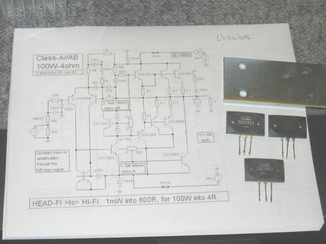

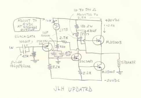

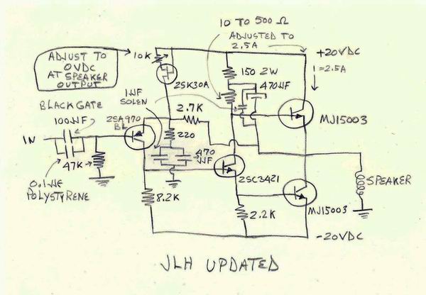

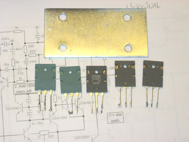

Comparing GEM and JLH
Hi everybody.
Carlos, you are very kind and i suspect you to be a kind of amplifier too...Ha! HA! very kind indeed... 🙂
As you said Carlos, It take time to compare. 😎
This time i have compared an updated JLH (schematic) with GEM.
The JLH is fitted Motorola MJ15003 at output, 2SC3421 as driver and 2SC970 as input transistor. I have cranked the bias at 2,5 amp so it run hot. Nothing was changed because it is the reference unit.
On the GEM, i have tried 3 different output transistors, two different drivers transistors and two different at input/current mirror.
I have used one channel only of JLH with speakers in parallell to be mono like GEM.
I have checked amplifiers power/frequency response with square waves to see oscillations. As measuring do not give clues on sound, i just checked to see if amplifier worked properly.
We were three to listen sometime but i was often alone because it is a long work.
JLH: very good, soft and detailled sound. Smooth on highs.
If you crank bias, it is better in controling bass. Very pleasant to listen on long runs. Not too bad with less than good recording.
Something difficult to describe when we listen to this amp: a little magic in it. Not perfect, a little coloration in sound (pleasant?)
Tireless unit.... Genius unit!
Usefull in Canada: heating the room... 😀
The GEM with MJ15003(output) MJE172/182 (drivers/VAS/Bias)
MPSA06/56 (input/current source).
Stable: no oscillations.
Great bass control, good midrange and good highs.
A little tiring on long runs. Very sensible to recording.
Sound very good on good recordings.(rare)
I don't know why but seems less dynamic than JLH. The three listeners agree with that.
I have cleared the 0.1 ohm resistors just to see if amplifier sound change. Bass is better controlled!!! Mid and highs a little bit more transparent... More dynamic! Curious thing for an amp with so much feedback the effect of those little value resistors....
This is the best transistors arrangement for bass.
I replaced the input /current s. transistors and the amp tend to oscillate. (2SC2240/2SA970)I had to move wiring to stop that. Need better construction! Sound become more transparent so i keeped those. Bass is less good: more airy, less punch/control. Why?those transistors have higher hfe and are more linear so they should be better....
I have replaced drivers/Vas/bias transistors with 2SC3421/2SA1358 and oscillation tendency is gone.
Improving midrange and high: liquid midrange, a little hard on high on long runs too... Very precise amplifier! We need better recordings.... 🙄
Finally i have replaced output transistors with the Carlos prefered ones: Sanken 2SC2922/2SA1216. (With emitter resistors removed.)
More transparent, better mid than MJ15003, more airy highs.
A good balance! Bass is less good than with the Motorolas...
A little tiring on high . Dynamic like the Motorolas.
Bad recordings are more disturbing with the Sankens.
Good recording are overall better with these ones.
Sibilant on occasion. (on a recording i am listening often with another amp and i have not this problem)
Changing the Sankens for Toshibas 2SA1302/2SC3281.
Installing 0.1 ohm resistors and 5 transistors...
Board is becoming a mess....
The better for midrange and high. Better bass than Sankens!
I don't know why! Better dynamics than Motorolas and Sankens!
Why?
The more detailled version: outstanding on good recordings.
Very precise amplifier. You will need good source and good speakers: not too agressive= this amp is fast!
Stay a little tiring on highs on long run.
I have adjusted bias as recommended by Graham: touchy ajustments.
I have ajusted bias to 1 amp class A and to 250 ma class AB and all versions become smoother but produce a lot of heat: i had to put a fan.
A very good design and outstanding performer if you use good recordings. Not as tolerant as JLH. Graham has told me that before. 🙂
Thanks Graham for a so good design.
Thanks Carlos for help and jokes!!
Thanks Barryblue for board design: it will help to construct neat boards: mine was constructed on copper side of universal board.
I must say that i have ring tweeters so this may have not helped with that kind of amp.
I use feedbackless amp on these speakers and they sound very good, very fast and not hard. 😎
Hope this "reporting" will help those who want to build this amplifier. This is a very precise amplifier! Hope recording will be better in the future... The pleasant amp are not necessary the more precise ones!!! 🙂 🙂

Hi everybody
Thanks Carlos and Graham for the answer.
Just a schematic correction: the current source jfet is N and must be a P.
I often use 2SK30A for current source.
My mistake: i apologize!
Should be J175 Fairchild or Motorola.
Any pnp transistor as current source will do the job too.
Anyway it is about the GEM, not the JLH.

Hi everybody

I am just waiting for a one of two components to complete the PCB as published here. The heatsinks are now due Wednesday and in the meantime in between family committments I have completed the PCB artwork for the PSU and the Power section of the GEM. Graham - I know you prefer the point to point approach but I thought I'd see how it went on a PCB........ I have decided to move a coupple of components around to improve the grounding and after that I'll publish it if anyone is interested?
It is my intention to show photos of the build units but at the moment our digital camera is not well so I am a bit stuck. As soon as I fix it I'll load up the images onto the forum.

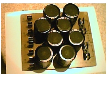

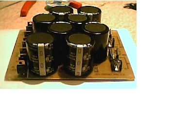

Some photos of the work so far
I finally have a digital camera to show a little of the PCBs progress.
I say PCBs because I continued after the original GEM PCB to make a PSU and a small PCB to carry the rest of the components not fiitted to the original PCB.
Here is a photo of the PSU board with dual banks of 4 * 10,000uF caps and fuses fitted. The decoupling caps for the large electrolytics are fitted on the bottom of the board.
More to follow
More to follow
