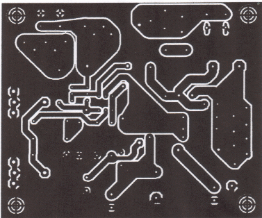

Hellô dear BarryBlue, i need the dimensions...i made a scanning with 178 x 147 mm
And the one, result 850 Kilobytes.
This one published is not correct dimensioned.
If someone is interested, i can upload the bigger file, it has better JPEG quality.
That's what i could do for a while Barry.
Tell me if it is enougth and inform the board dimensions.

Reduced to 9 x 8 cm
The dimension on the previous post from Barry seems to read 9 x 8 cm.
Here I attached the reduced and contrast adjusted file. Hope will help others. The edges are not straight. I might re-sketch it again.....it will take a long time. I want to know wot program Barry used to generate the pcb artwork.
kb
Here is 90 x 80 milimeters, in GIF format.
Tell me guys, please, is this one good enougth?
Only 300 dpi this one,...because if i increase it in resolution, it will exceed the forum limits.
I have a GIF, made with 1200 dpi, size is 94.1 x 79.0 mm, and data is 8.7 Megabytes....if someone wants....i can upload.
Also if someone wanted the Bitmap (45 Megabytes...oh pain!) i can upload too.
But really, i think the size is not so important, as we can order the printer, to produce the size we want when adjusting the printer parameters...and if the image present some error in side proportion, we can resize it, changing the sides ratio too, stretching the horizontal without move the vertical or the opposite.
But this way is easier, producing the correct size, the user will have only to order the highest possible printing quality and order the original size.

Carlos,
The size is marked on the side of the overview file and is 98.672 * 83.086 mm. Sorry that I didn't make it round numbers! :eek: I hope the chicken tastes good.....
Kambule,
The CAD package is Target 3001. I use the Light version which is about 50 Euro/US$ and is limited to 400 pins. It includes Sim/Router/schamtic and Layout.

Congratulations BarryBlue, our mission is completed, now we can wait more guys
That will inform us that are doing some, separating parts, etching boards and doing the GEM.
I feel good to publish your final art work...very pretty boards, and i am thanking you in advance, for the boards you have the kindness to offer to me and Graham for free.

Hi Folks,
Well after a rather long and protracted effort last night my first GEM PCB was delivered.
The reason it was long was that someone in our family had used my stock of Staples Picture paper that I used for PCB work. So after a rather frustrating time trying as many type of paper we had in the house I stubbled across two sample sheets of Epson Photo paper that came with a rather cheap printer a few years ago.
Well it wasn't as good as the Staples reference paper but it was usuable and shortly after midnight was the proud owner of a piece of laminate that equates to several weeks of my time and rather more of Graham's.
I can't wait to get it built!. At the moment the heatsinks are on the longest leadtime (Ebay and a long story) and are due next week.
So I started on the PSU that Carlos published yesterday. If I can strech the Epson paper out I'll see if I can christen another new PCB soon.
