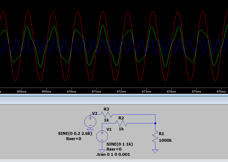

I know what you're getting at, but the sum of the 1 kHz and 2.6 kHz sines is periodic at 200 Hz, the sum of only the fifth and thirteenth harmonics, with the amplitudes of the 200 Hz fundamental along with all other harmonics being zeroEarlier I talked about the non-linearity being constant, as you'd consider with regard to amps, speakers and many things. If you try reconstructing using non harmonically related signals, the linearity (would have to) varies.
For a memoryless system (think amplifier that is much faster than any signals of interest) (transfer function is simply y = f(x) with no calculus necessary for the system description) driven by a single sine wave it is straightforward to derive the amplitudes of all the harmonics in the output from the Taylor series of the transfer function. And similarly straightforward to derive amplitudes of intermodulation products for signals that are sums of multiple sines.
For a not memoryless but time-invariant dynamic system, (system requires integrodifferential equations for a time domain representation) (think amplifier whose frequency response is nontrivial with respect to the frequencies of the input and associated harmonics of interest) there is an analog of the Taylor series called Volterra series which is very tedious to derive but enables a similar but perhaps not so straightforward calculation of distortion parameters

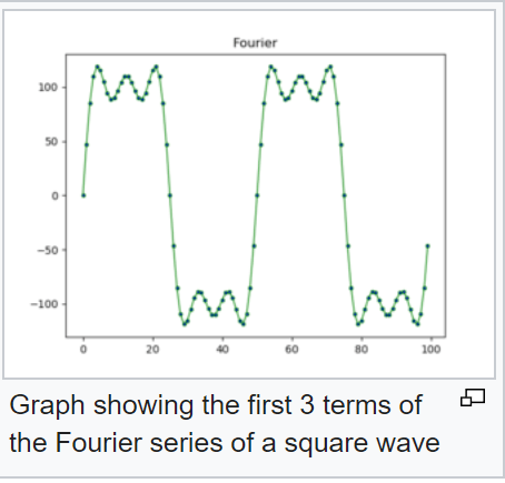

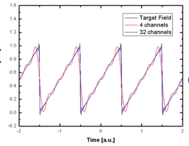

Look at an extreme case of a square wave. That's really a sinewave with lots (in theory, infinite) odd harmonics added. The more you add, the more it converges to a square - but you must add the harmonics with a very specific level that decreases with order. But it's all very symmetric.
Now take a very asymmetric wave - a sawtooth. Can't get much more asymmetric. And, you build a sawtooth by taking a sine wave and adding lots (in theory, infinite) even harmonics at a specific level and phase.
Jan
