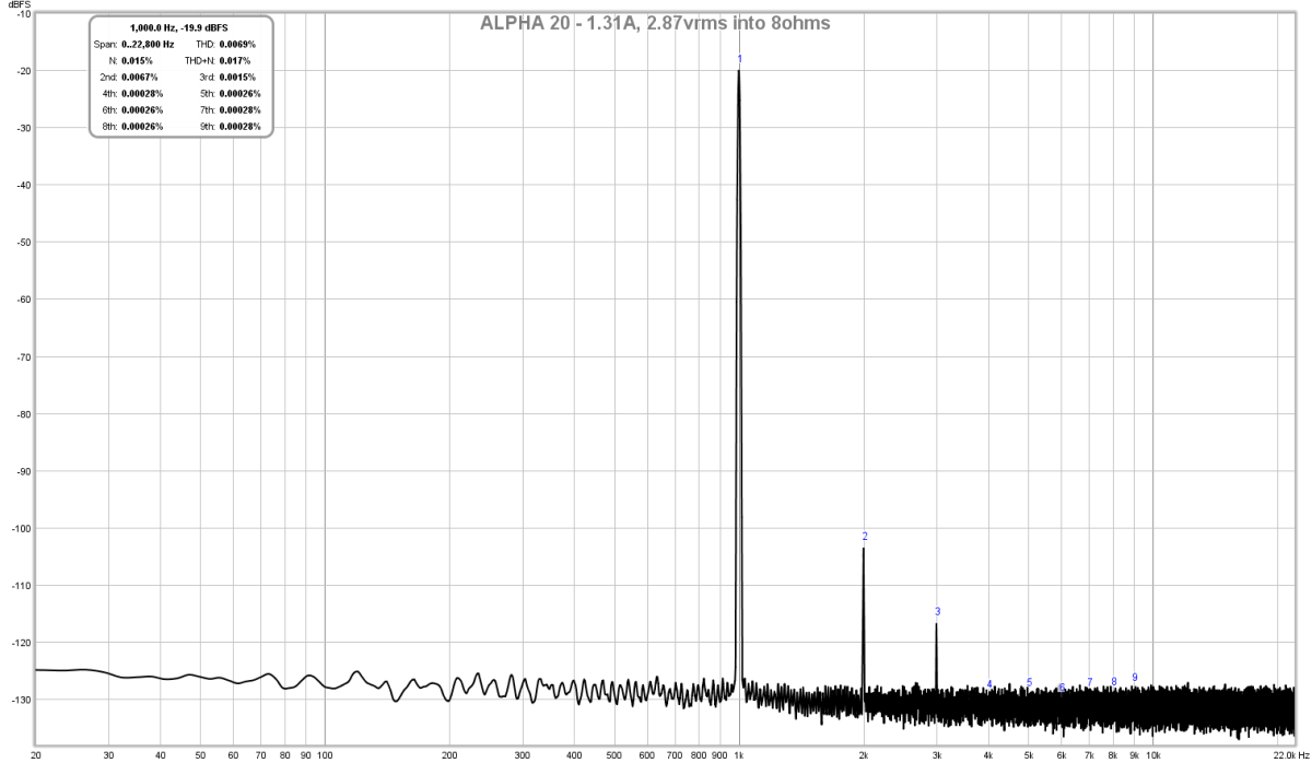

The 1kHz spike is the signal into the amp input. It's supposed to be high. If the amp was perfect, nothing else would be there but the 1kHz. All the other stuff are harmonics produced by electronic circuitry in the amp, not present in the input signal. If the input signal was directly graphed, without going through the amp, only the 1kHz would be visible, unless you really dropped the floor on the graph, or if you had a noisy signal generator.So in this picture I snagged from the thread link, does that huge spike at around 1khz going to sound horrible?
Ok, back to the OP's question of what is THD? (Total Harmonic Distortion).
It is the sum of all the harmonics, as that sum relates to the strength of the fundamental.
It is most often expressed in percent.
On the graph in question, the 1 kHz "spike" is the strength of the fundamental.
If you see other spikes at 2kHz, or 3kHz, etc., those are the harmonics.
Sum up the harmonic strengths, and compare to the fundamental strengths.
Forget about the math that it takes to do the proper sum, and then compare to the fundamental, etc.
That is not a simple addition of dB that the graph units are in (dB).
You wanted simple, so do not do the math, leave it to others to do that for you.
Different strengths of the harmonics versus the fundamental, whether they are from a musical instrument, or from an amplifier, or a loudspeakers changes the sound that you hear.
