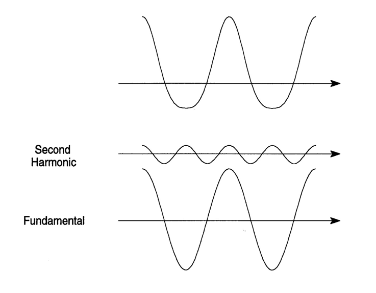

Think about where it can go when you start breaking down the waveform at the cycle level in a regular way.This discussion begs the question: Why is it that non-linearities in the electronics result in harmonic distortion?
Harmonic distortion of an audio amplifier can be as simple as the transfer function of the amplifier active device.
The active device can be a single vacuum tube, bipolar transistor, MOSFET, JFET, or other amplifying device.
When ever the input to output curve is anything other than a straight line graph, then whenever a pure single frequency tone is applied at the input, there will be one or more harmonic frequencie(s) at the output that are 2X, 3X, 4X, 5X, etc. times higher frequency than the original un-distorted tone.
The frequency response of the active device can be far below, and many times higher than the original tone, with no resonances present in the audio range; but the imperfect transfer function will produce that/those harmonic frequency(s).
This is an amplfier, not a loudspeaker.
Loudspeakers have resonances.
Most Good amplifiers do not have resonances in the 20HZ to 20kHz frequency range.
Hopefully that will make it clearer, and not distort the real principles of amplifer harmonic distortion.
Loudspeakers not only have resonances, they also have a transfer function, output versus input.
If the transfer function is not a straight line, input versus output, then for a single pure tone in, there will be one or more of these harmonic frequency(s), 2X, 3X . . . etc.
Now, when 2 tones are applied to an amplifier
and/or when 2 tones (within the bandwidth of a driver and its crossover) are applied to a speaker . . .
. . . there will be Intermodulation distortion tones in addition to the original 2 tones, but that is a subject for another thread.

Actually, you are wrong.
The harmonic distortion is BY DEFINITION whole, integral multiples of the fundamental input frequency.
Hence, if the input is 1Khz, the harmonics will be at 2, 3, 4, 5....
If the input is at 1.2Khz, the harmonics will be at 2.4, 3.6, 4.8, 6... etc...
A resonance is a harmonic of the fundamental. Interesting... think of the close and open pipe air resonances.
So, assuming that the non linearity of a circuit introduces higher order distortion....
..WHY would it be that it is in whole integral harmonics?
Why does a 1Khz signal generate harmonics at 2, 3, 4 etc?

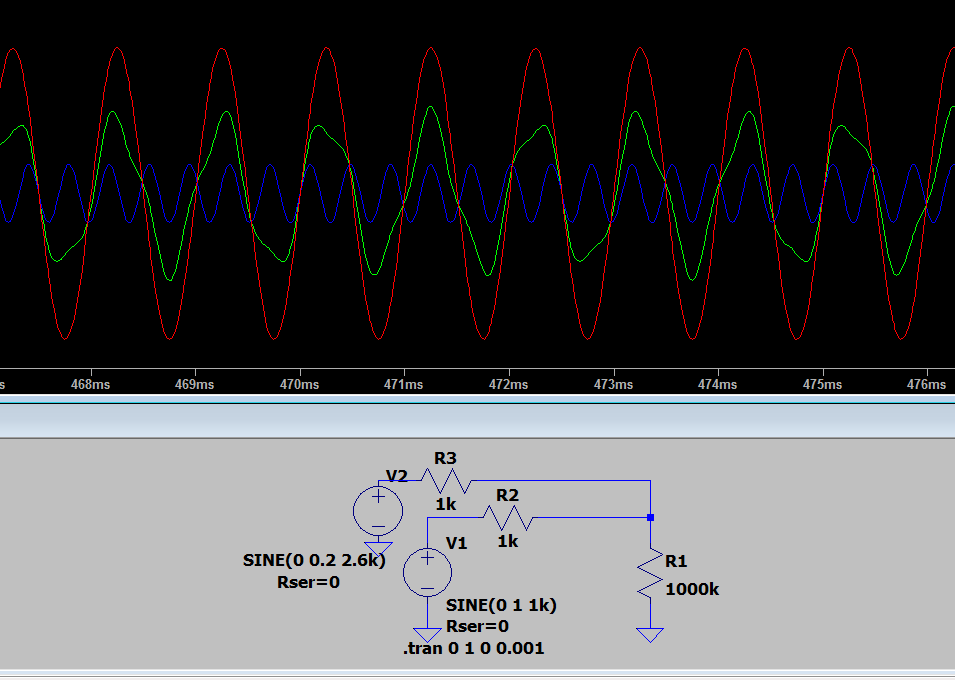

I think I can almost answer my, and your, question:
Why do we see whole integer multiples (harmonics, resonances) of the fundamental signal?
It's almost an empirical proof of the Fourier Theorem about waves: where a wave can be defined by a series of harmonics.
I believe this is because we are measuring it in a frequency domain.
Perhaps a much better distortion measurement would be to do it in an analog, amplitude domain: we could measure the output wave of the electronic circuit's transfer function, then subtract the input signal and see the distortion. It will be harmonic, of course. It will "beat" with the input signal because it is the distortion of the input signal, which itself is repetitive.
If we wanted to, we could then also put that difference distortion signal though a frequency domain analysis and see the harmonic spectrum.

Resonance is a phenomenon generally associated with linear differential equations. It can occur in nonlinear systems too, but the point is that it is a feature of linear systems ... that don't have any harmonic distortion by virtue of being linear
Harmonic distortion only exists in nonlinear systems, and doesn't necessarily have anything to do with differential equations

Ahh - excellent question! If you take a sine wave, and run it through a non-linear process, the waveshape is distorted. The tops can be squashed or increased, or the symmetry around the zero crossings becomes different between rising and falling edges.Hello,
Cheers.
Enter Mr. Jean-Baptiste Joseph Fourier, French mathematician. He found out that if you start from a perfect sine wave you can 'build' any distorted sine wave by adding harmonics of the signal in specific levels and phase shifts! Turning that around, you can take any distorted sine wave and unravel it into the fundamental perfect wave and a collection of equally perfect waves at harmonic frequencies in specific levels and phases.
This is done by mathematical manipulation of the signal wave. FFT comes to mind, of course.
I always find these things extremely interesting. I mean, how do the mathematics 'know' how the physical systems work? (No answer required ;-).
Edit: you can also unravel the signal into the fundamental and harmonics in a series of filter banks, set to each of the frequencies. But that's sooo 20-th century ;-)
