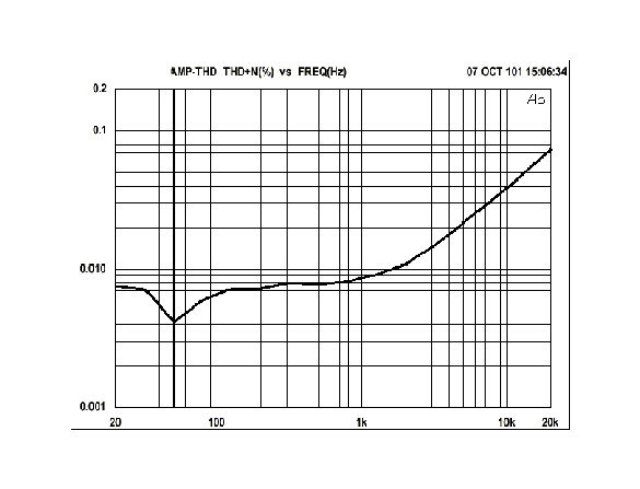

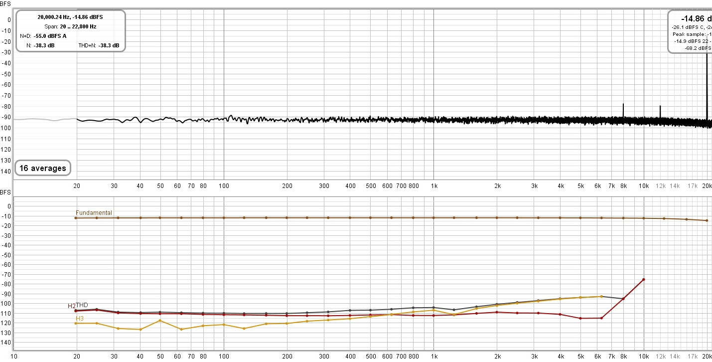

You know, I wonder how proper is that THD measurement based solely on the 1Khz input signal.
If the harmonic distortion is a function of fundamental frequency, that is, different levels and envelopes for different frequencies for the fundamental input signal, then how can we fully measure THD?
Example, take a device that has high THD in the bass but a clean treble, or viceversa... Surely those devices must sound quite different! How can we measure that? A waterfall? I have NEVER seen such a measurement published.
THD vs frequency graph is published almost all the time. Yet you have never seen it?
Hmm.. the THD that I see is based on a frequency spectrum based on a 1Khz input signal.
Do they do this for a swept fundamental input signal.... do they sweep the fundamental input signal from 20Hz to 20Khz and then look at the harmonic spectrum of the distortion, and measure how it changes with the frequency of the input signal?
That will be a WATERFALL graph. The 'z' coordinate would be the frequency of the input signal for the harmonic distortion plot.

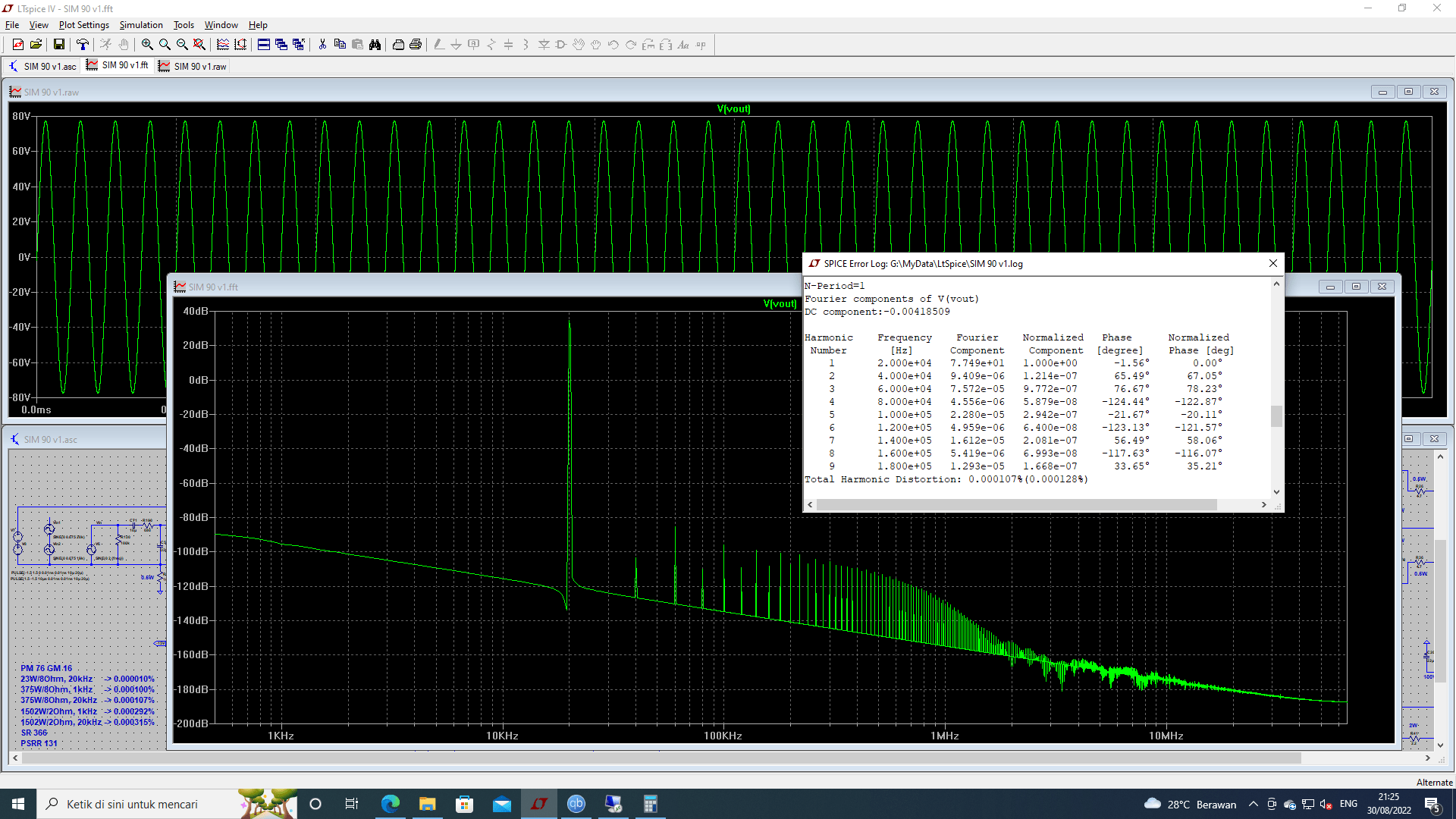

I do a sine sweep whenever I take measurements.
Here is an example:
You specify the parameters (how many steps for example) and the software will run each frequency and measure the distortion products.
This one was taken during prototyping, so is incomplete but should give you an idea.
Reactions: JMFahey
