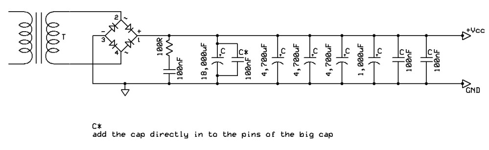

Here is the schematic of only one rail:

XELB said:
BTW, do you do "something" with the trafo cable or it's not important for you ?
I think if you do a "trick" with the trafo cable you will not need big resistance values after the bridge 😀
I cross each secondary wires, but what does that has to do with resistance after the bridge?
You can also pass the wires around a ferrite, I did that on some PSUs.
I also cross the secondary wires.
But there is something that you also can do 😉
Try do give a few turns(20) with a diameter of 1cm
in the primary cable.
Then, do the same for the secondary.
Have you heard of this ?

carlosfm said:
There are advantages in using very low value resistors, and also with (consistently) manageable DC-Offset, so that the Ci cap can be discarded.
It works, it's simple, it sounds very good.
Even without matching impedances (because I use very low values, and the amp would need a buffer), DC-offset is around 30mv.

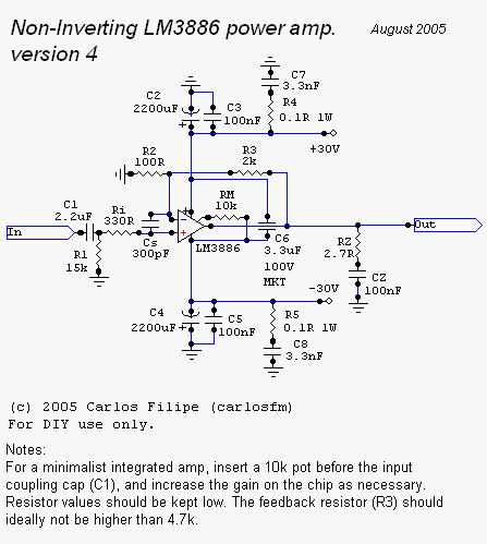

Update.
Finally, I had some time to make what I had on my mind to do: reduce the value of the resistors on the snubber.
So, instead of 0.47R + 47nF, I now have 0.1R + 3.3nF.
I also increased the value of the cap between the rails, from 330nF to 3.3uF. 😱
Last, and this I made some time ago, I removed the output series resistors.
These mods I recommend to everyone that uses a snubberized PSU, whatever the type.
You should use big (1,000~2,200uf) caps on the chip, as I recommended earlier, instead of 100uf.
The results?
What the hell, this is the amp that better drives my speakers ever, and I had lot of amps in my home, including Krells...
Bass is VERY tight, detail is unbelievable, everything is right. Reminds me the Halcros.
Alas, this amp is very revealing of poor source components and/or recordings.
Here's the schematic, enjoy.😎
Hi Carlos!
What of resistors are you using for the 0,1R?
I`ve checked at my normal supplyers (Farnell and RS) and the only resistors they have in this low value is some hi wattage current sense resistors, mostly SMD.
It seems like normal metal og carbon film resistors under 1 ohm is almost impossible to find.
Tor Martin
Tor M said:
Hi Carlos!
Hi Tor,
They are normal 5% carbon resistors, 0.1R/1W.
Yes, they are not easy to find, I bought these some months ago (with this test in mind), on one of my regular suppliers, here in Lisbon.
They also have 3W carbon resistors, which curiously I can't find anywhere else around here too.
I find this curious, because these are bog standard, cheap parts...
