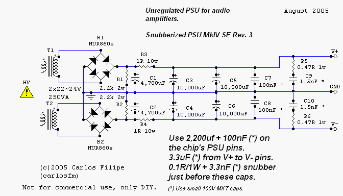

I have built my last chip amp (after many others of various configurations), following exactly your last schematics, for the amp itself as well as for the psu (18-0-18 230Va, 4x4700 uf each rail). It has been singing since last night : its sound is wonderful. It's obviously the best I'have made. I'm the happiest diyer ever!
Thanks, Carlos, to share your schematics, ideas, suggestions on this forum : it's been such a great help for me.

Hi Carlos,
I having some Kiwame of 2.2K / 100, and all parts for unreguated snubberized PS. Now thinking of it's worth trying this.
Rin 10K, Cin 1UF, Rf 2.2K/100 Kiwame, 25W (or 50W version, undecided yet).
How about using "Figure 4 - Second Gain Stage" as buffer with x2 gain using NE5532 ?
Also,
Which one is your preferences for LM3875 using latest 0.1R + 3.3nf snubberized at chip ( I have all parts but undecided yet?
A) 18-0-18 (180VA) or 25-0-25 (240 VA)
B) Unsubberized PS with 10,000 per rail, or 4,700x3 per rail, or 4,700x2 + 2200 + 1000 per rail
C). Standard 2,200 or 1,000 at chip.
