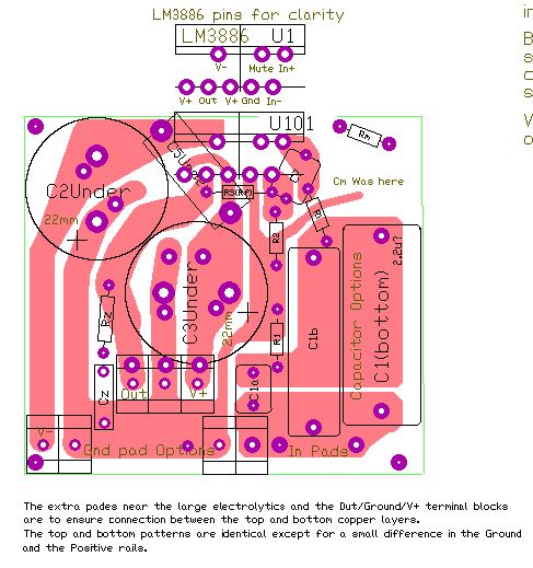

Hello everyone,
Well, I didn't think it possible, but I have managed to make an unreliable oscillator using LM3886.
Fundamentally, I have used CarlosFM's latest version circuit (the one with NO output resistors, a 3.3uF capacitor between + and - rails, and 0.1R resistors in the snubbers) with:
1) 2.2uF input capacitor (MKP style approx 200V unfortunately ... big ugly thing);
2) No bypass capacitors in parallel with it as yet;
3) 2000uF (>35V) electrolytics on + and - rail;
4) These capacitors NOT bypassed or snubberized as yet;
5) 2.2uF rather than 3.3uF capacitor from + to - rail, (63V Metallized Polyester MMK ... all I could get)
6) 330pF polystyrene across + and - inputs;
Unregulated power supply;
1) 80000uF + 2 * 4700uF WITH snubbers and bleed resistors as on most recent diagram;
2) 28.2V + and - rails (measure exactly and equal)
3) $2 bridge recitifiers * 2
4) 0.3 C/W heatsink (big enough for more than 4 of these amplifiers); white heat sink goop; LM3886TF style ICs (so shorts to heatsink not a problem;
5) 100k linear pot used as a volume control (variable resistance to ground) not just as a variable resistor;
(Is this right?? Could this be the problem, either the value or the arrangement of the pot???)
The source signal is my CD player, playing some test tones I recorded (only up to 200 Hz, though).
Speakers:
Nominal 8 ohm JBL's 25 years old. New superjunky tweeters ($2 each at Jaycar) also nominally 8 ohm. These work OK on my other amplifier (they don't sound too good, but for $2 what would you expect.)
Problems:
1. Quite high offset ... starts at about 1.5 volts and then slowly reduces a few minutes after startup to < 0.5 volts, perhaps lower.
2. Oscillation:
At various settings of this potentiometer, there will either be NORMAL function of the amplifier OR oscillation. (I say, "at various settings", because the amplifier appears to work apparently normally at very low levels, and at moderate and moderately high levels.)
The oscillation shows as:
a) The chip becomes VERY hot very quickly. (During normal function it is quite cool.)
b) Funny trace on oscilloscope which resolves to approximately one cycle per 4 microsecond (250 000Hz), when expanded.
There appears to be NO oscillation when the amplifier is not driving speakers but just the oscilloscope, however, the negative portion of the waveform is slightly flat a broad at its peak compared with the positive portion.
A bit more history:
I built a nearly identical amplifier (only difference being a minimally different circuit board), but reduced the resistor to ground to increase the gain to about 50. The circuit board was ever so slightly different to the current one. This worked absolutely FINE for more than an hour with the SAME POWER SUPPLY AND THE SAME SPEAKER. (Without snubbers and bypass capacitors it sounded a bit dead, but that is what I expected.) I then changed the gain by installing the the normal resistor to ground as in Carlos' diagram and got the SAME oscillations and high temperatures as I outlined above. It did this both WITH and WITHOUT a quick pre-amp (Pass NS10 Clone) I built. (I haven't bothered checking my current amplifier version with the pre-amp. I am a too despondent.)
With a multimeter, all the things which should be connected appear to be and there appears to be no cross connections/short circuits. For once, I am actually quite pleased with my soldering too!
Given that I am totally new at this:
1) Is my diagnosis of oscillation correct?
2) Would someone please review my PCB layout? Have I got the connections to the LM3886 correct? I have the capacitor's polarity as on my PCB diagram. I hope that is correct. Please confirm for me.
3) Is it the potentiometer value/arrangement causing the problems?
4) I hope it isn't likely to be the speakers, because it would be a pain trying to work out their impedance 🙁
5) Have I done something else dumb?
6) Where do I go from here? Add the snubbers? Change values?
All thoughts humbly received.
George.

Here is the PCB Bottom
Speakers:
Problems:
2. Oscillation:
A bit more history:
George.
PS I have put the supply capacitors and C6 under the circuit board so that I can fix the LM3886's to the heatsink using a U-shaped piece of metal screwed at each end ... fewer holes in the heatsink so I can use it again if all this doesn't work!!

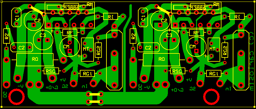

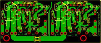

Hey GeorgeBoles.
In my opinion you should always have the input and the output perpendicular.
This way you prevent interference.
I also recommend that you try to make the PCB much symmetric as possible.
You can also use the top layer for +Vcc and – Vcc and, the bottom layer for ground, for example.
This way you will make a small capacitor between the two layers.
( this implementation it’s very good to suppress some noise )
Try to isolate the signal with the -Vcc, +Vcc or Ground, it's also good to prevent interference.
Here is an example, my first LM3886 PCB design:
TOP
BOTTOM
TOP
BOTTOM
