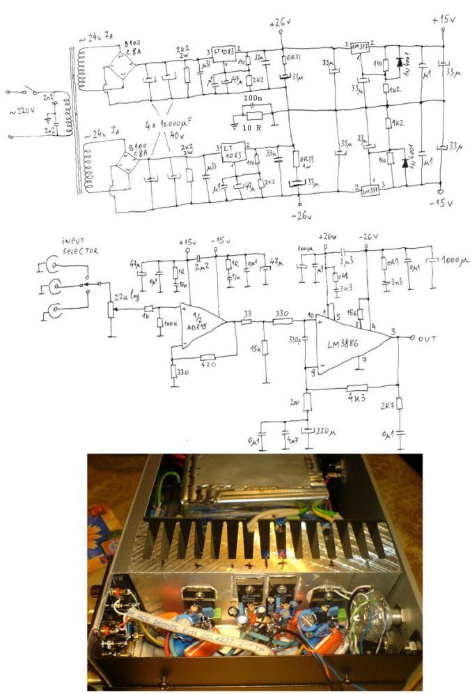

LT1083 - problem solved
Well, as it happens sometimes in life, I was looking for for solution on the wrong place. There is nothing wrong with LT1083 (au contraire). The problem was in coupling cap between AD815 preamp and power amp (3,3 uF Siemens, industrial type MKT).
Having no Black Gates on hand (and not being ready to pay 40 EURO for a single 3,3uF cap, even if it's made from fairy dust and unicorn's tears), I decided that no cap is best cap and went for direct coupling.
Since AD815 has 30mv DC offset on its output it is obvious that LM3886 should have unity gain for DC, so Ci came back in play as 220uF//4,7uF Wima//100nF MKP in series with 200 Ohm as Ri and 4K3 as Rf.
And yes, Ci made this way affects the overall sound much, much less than it does usually (coupling cap in direct signal path does a lot more damage, magical or not).
And now, sound is right, everything is as it should be, all benefits of standard Carlos' circuit are present, plus benefits in bass that I mentioned in previous post (and improvements descended from using a regulated PSU in this integrated amp).
One thing should be kept in mind: the source component (CD/DVD player, DAC, PC sound card, whatever) should have no significant DC offset voltage on its output (up to 20 mV is OK) in order to keep it under 100mV on the speaker.
Attached is schematic and picture of amp (built p2p of course).
Cheers

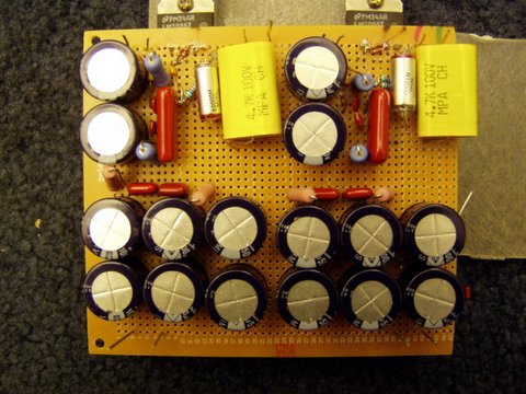

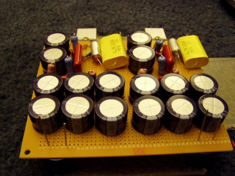

Finished the board for the non-verting power amp today. I listened for about five minutes,it sounds OK. I will burn it in for 3 days and give it another listen.
It is a little different from Carlos' schematic. I didnt have all the parts for the snubbers.so the values are different. I used .33ohm and a 1nf cap instead of .1ohm resistor and 3.3nf cap. The power supply snubber components are the same as schematic's
I also used a 4.7uf cap bypass with a polystylene,I dont know if it help but I brought 150pcs,so I will use them someplace.
