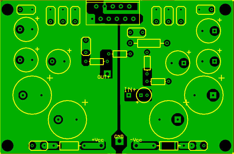

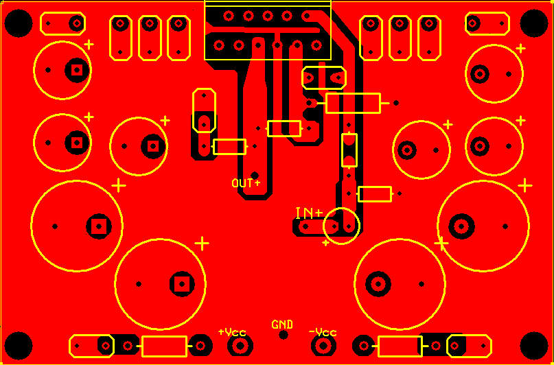

My LM3886 PCB ( positive input )
For each Vcc:
1,000uF + 1,000uF + 220uF + 220uF + 220uF + 5x 100nF ( one cap in the pin chip)
I can also use 330uF( Low ESR caps ) instead of 220uF
In red, top layer and in green, the bottom layer 😉
What do you guys think ?

I made new improvements to my PCB.
1- the input is now perpendicular to the output (in the old version they were parallel)
2- since I building a bridged LM3886, now the ground and +/-Vcc are shared.
(but I will maintain the same capacitance as it was two different boards)
What do you guys think about it ?
XELB said:
Is true that the LM3886 like low impedance caps near "him"?
If so, should try to low impedance as much as possible and at the same time get a good capacitance(2,2000~10,000uF) for each Vcc ?
You should know better by now.
If you use a (separated?) snubberized PSU, things will not be too bad.
But that frenetical bypassing is not beneficial, as you have long traces which generate inductance.
I would use a 1,000~2,200uf cap, bypassed with 100nf and snubberized, on the chip. As you know.
But maby you have another secret formula.:magnify:

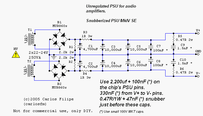

You use 4,700uF + 10,000uF + 10,000uF , correct ?
If I were you I would do it like this :
10,000uF + 10,000uF + 4,700uF 😉
Big capacitance in the back 😛
I once tried 4,700uF + 4,700uF + 18,000uF and then 18,000uF + ......
Now I use the second choice. 🙂
You need more capacitance after the resistor.
And it's better to parallel same value caps.
If you want more capacitance you can parallel a third 10,000uf cap, or just use two 22,000uf paralleled caps per rail.
What you are trying to do with the 4,700uf cap paralleled with the 10,000uf doesn't work as you think.
You have a snubber there to lower the impedance.
That paralleled 4,700uf cap doesn't do much.
