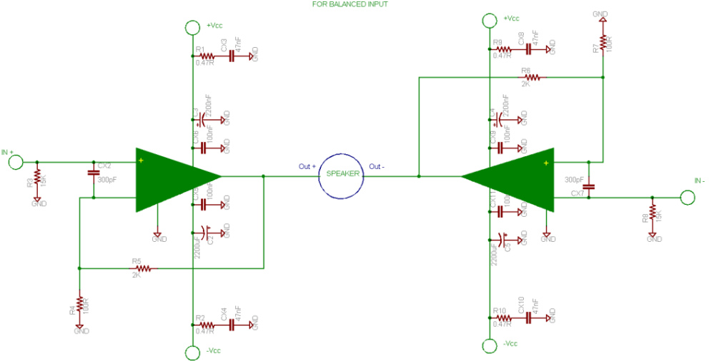

XELB said:Carlos, what do you think of this LM3886 schematic for balanced input ?
I suppose that's for a power amp?
In that case, you have too much gain.
Also, I would use some small series input resistors (100~330R).
My "pre" (DRV134) will give 6dB gain.
Should I lower the power amp gain for 20 ?
(changing 2K for 1K)
Does the LM3886 work well in 20dB gain?
I didn't put any resistors or capacitors in the input and output because I want to optimize that values with my speakers.
(I want to "see" how it changes the sound) 😀
Ps: I got some free adjustable inductors, do you think I should use in the output ?
(I don't like to much inductance, It gives a slow bass....)

Carlos, I notice you insist on low values for the feedback resistors, about 1/10th of other designs.
what differences in sound quality do you hear?
does type of resistor matter for feedback?
and do the same values go for the 3875?
carlos answered this already, im not sure if it was here or in another thread.
anyway, lower value resistors generate less noise. i think (but may be wrong) that since the resistors are of lower value more current is flowing and thus the signal is less influenced by interference or noise. much in the same way low impedence input provides better noise regection in interconnects.
