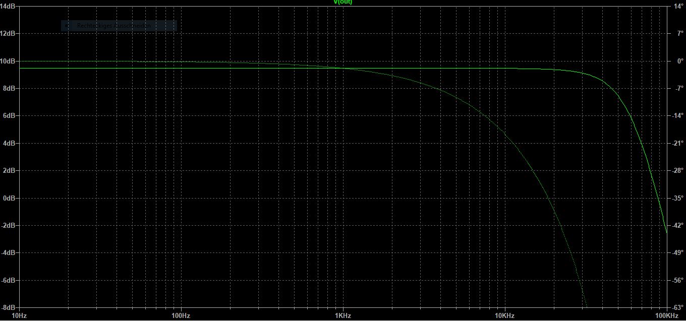

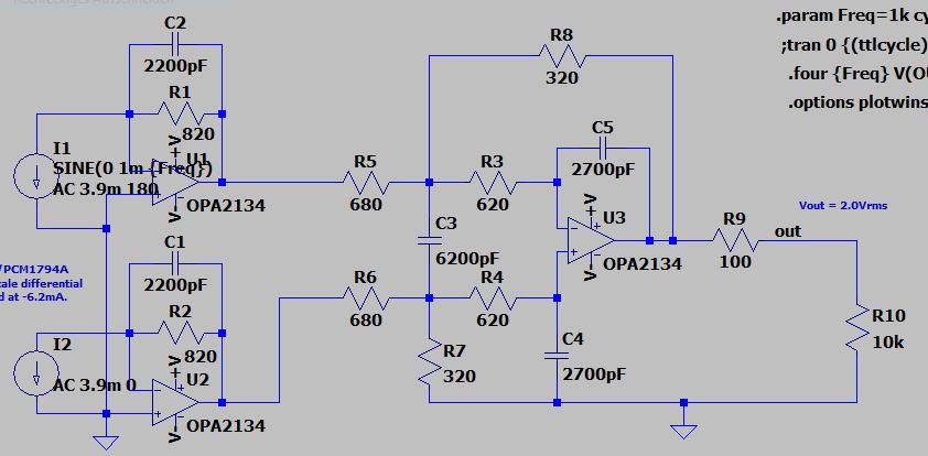

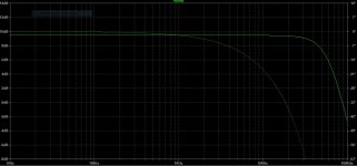

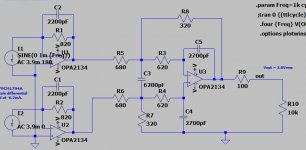

Done some simulations in LTSpice (I/V & LPF)
have a nice day!
Some simulation:

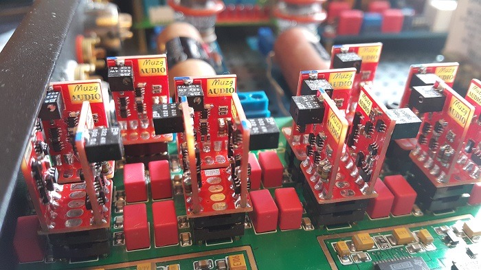

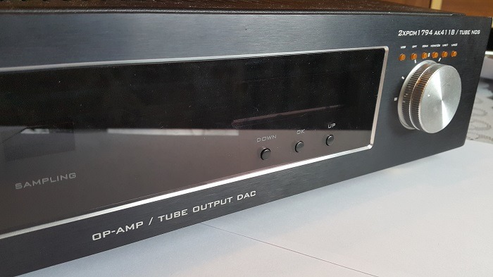

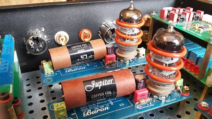

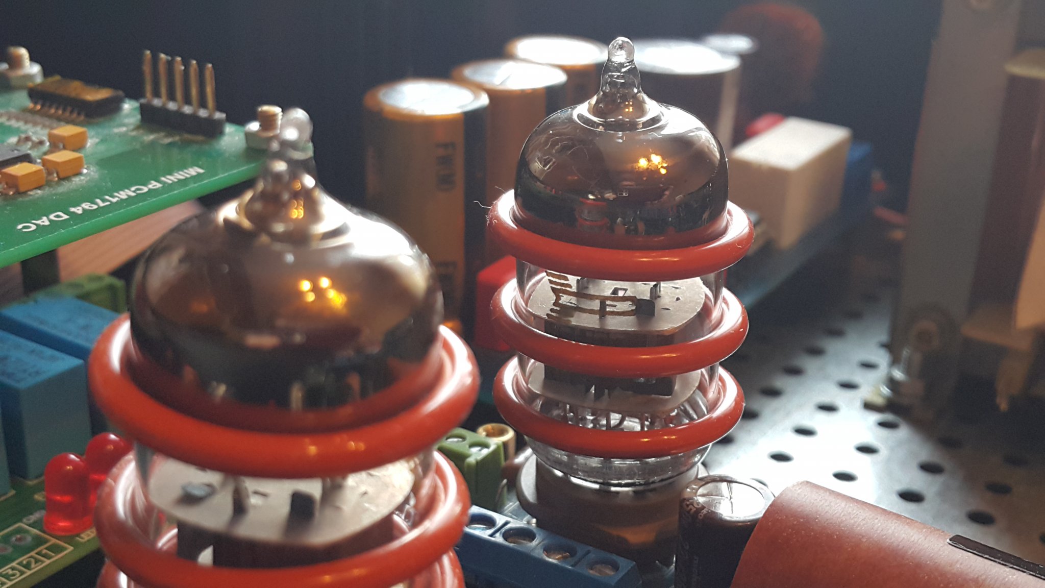

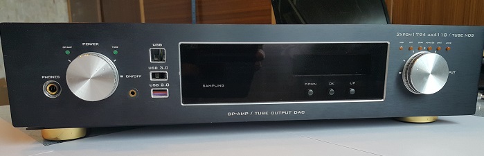

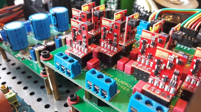

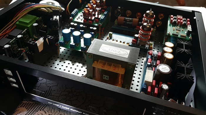

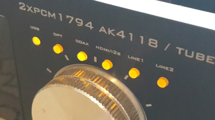

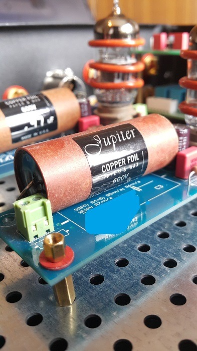

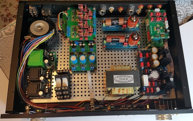

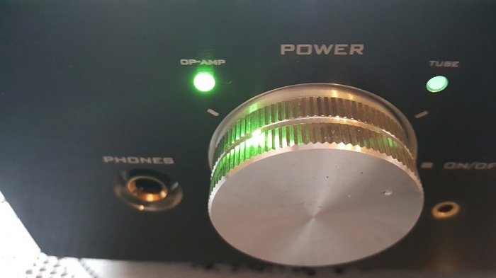

Hi .
It took some time and some small progress to make a dual system DAC with the use of PCM 1794 and vacuum tubes.
