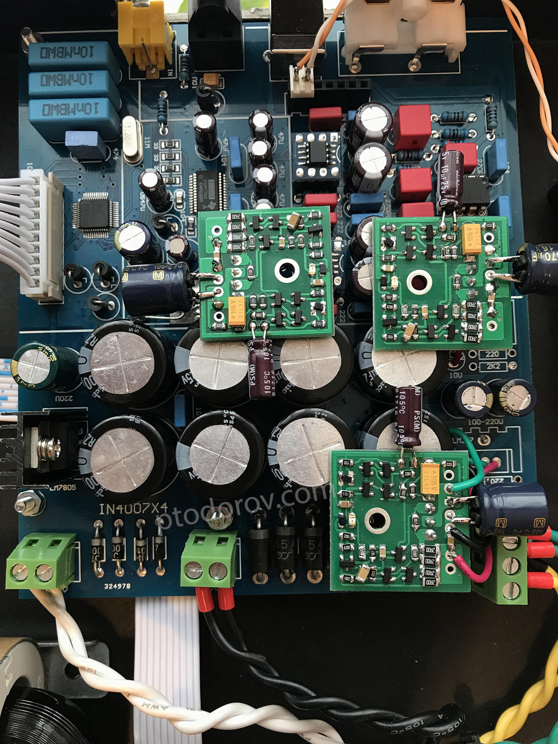

Hey, thanks for the interesting discussion. I have chosen the PCM1794 after I read this article, which has in depth measurement/analysis/comparison of delta-sigma/multibit DACs and their differences. You may find it interesting: Какой звуковой ЦАП лучше? — Меандр — занимательная электроника. It is in russian so you should probably use Google Translate.
By the way, here is the whole setup in a temporary enclosure out of a Polo RL scarf :zombie: until I find someone with a CNC nice enough to make me two simillar enclosures.
The setup consists of:
- A DIY AC filter
- 2x15VAC+2x9VAC R-Core transformer feeding the DAC board
- 2x7,5VAC feeding the XMOS reclock and Raspberry Pi
- Raspberry Pi 3 running Volumio fed by a LT1083 + CRC filter PSU(on the black prototype PCB, painted black with a spray can)
- JLSounds XMOS, with it's reclock after galvanic barrier fed by an LM317 + CRC PSU(also on the black board)
- The modified chinese PCM1794 board
- An LCD display+MCU+rotary switch that came with the chinese board used to switch digital inputs and display current signal frequency
While still burning in, the sound of the PCM1794 is amazing. TBH I have never expected such a detailed sound that is still warm and pleasant to listen to from a delta-sigma DAC except for the most expensive Sabre pros. I don't believe the TDA1541 myths anymore.
The good thing is that the whole streamer/DAC costed less than 250$ including the trafos, raspberry, xmos, memory card, DAC board and all the components for the upgrade. It allows me to listen to music from online streaming services such as Spotify and Tidal, local HDD and I can still switch to the toslink coming from my TV with one click and use the DAC for Xbox(pass-through) and Netflix.
I still have to add the IR receiver for an Apple remote I have laying around but Volumio has a web interface so it's not mandatory.

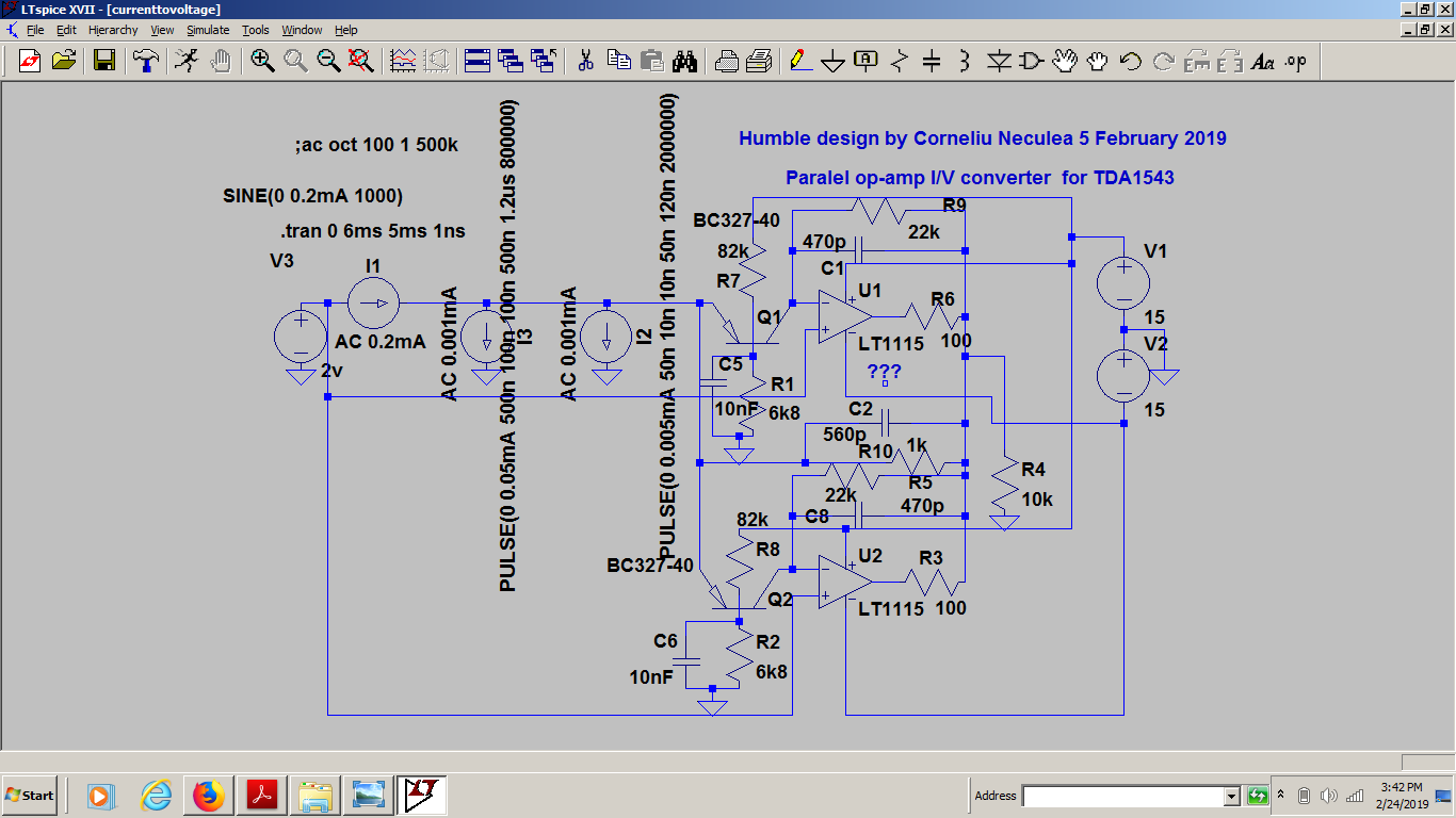

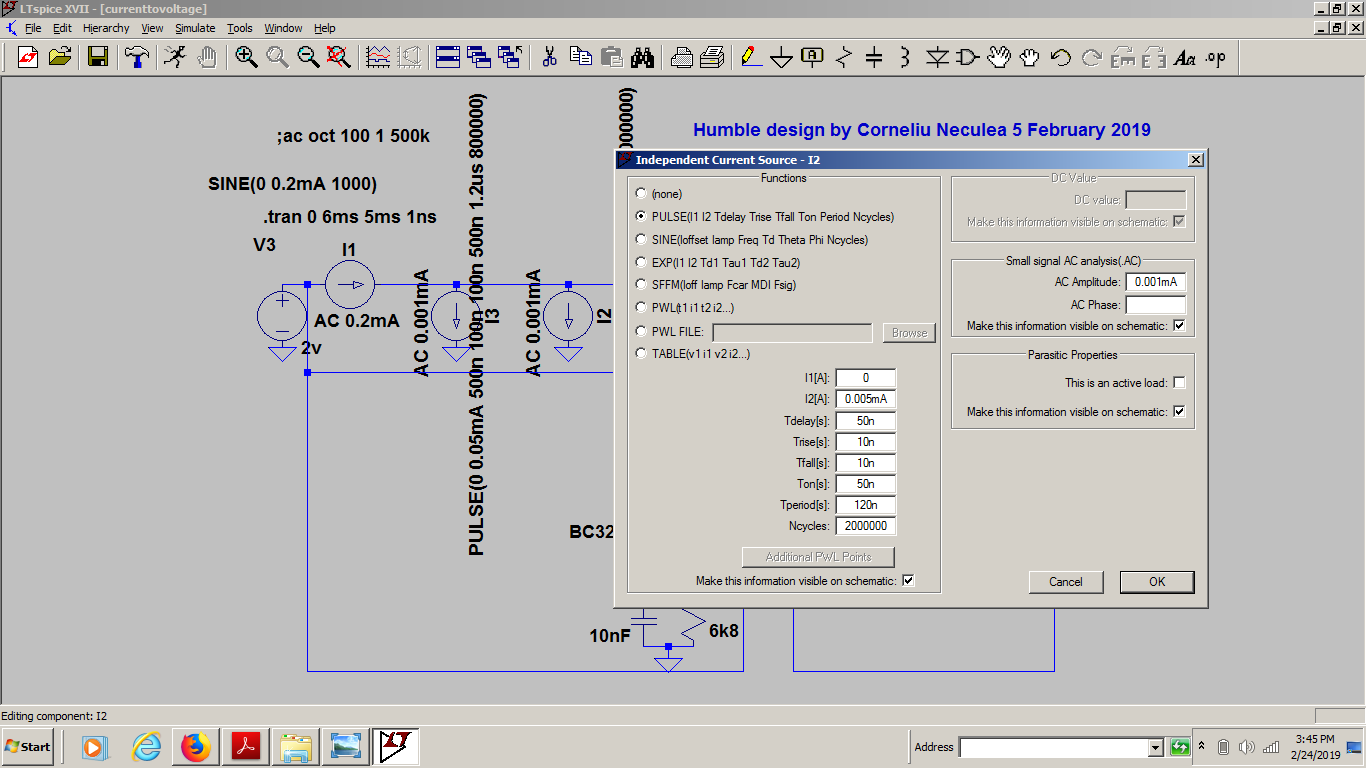

I started to simulate my own I/V stage with a complex input but I'd like some help for the parallel current sources timings.I don't exactly know how to sim a real dac output so i attached some photos for my spice sim. If you think i got it all wrong please tell me what to do! Please make this I/V of mine sim really bad!
I just launched an order for ada4898 and many other components to build the best variant of my own i/v , so that i can test them along with my own toys. For now I only have a Phillips based on TDA1543 plus LM833 and transistor front end I/V and a Sony based on a tda1541 , 4x oversampling and no output filter(SONY CDP750 as stock!!!) to be modded with the best current converter money can buy, so theoretically we should have a 16 bit nightmare there, isn't it?
In the end I won't be convinced that i was wrong unless my I/V sounds worse than ADA4898 on 16-20 bit players .
Until that happens, I'm still into masking techniques as i consider them more valuable than cleaning everything .I don't really care how good a technology can be if it's not cheap. And i will never buy that Benchmark dac...In 10 years from now another guys will tell that their new toys are WAY better than a benchmark , the same as early CD players were advertised to be the best audio out here.

I have done a few mods to the board after my last post...
1. Changed the LM317/337 regulators for the OPAMP supplies and the AVCC of the PCM1794 with high PSRR(-125dB), low output impedance discrete regulators.
2. Increased PCM1794 AVCC voltage from 5V to 6.3V. I like to adhere to the datasheet absolute maximum values, I know DDDAC has experimented with higher values but there is no point in doing this when you use an active I/V.
The sound became a little "colder" but more details "appeared", especially in the highs so I figured out that what I thought was "colder" actually was closer to the exact recording. Initially I felt like I liked the "warm" feeling more, but after listening for a few hours I found out I was wrong.
I think that there is not a lot more I can do with this board in terms of improvement, the sound quality has already exceeded my expectations.
