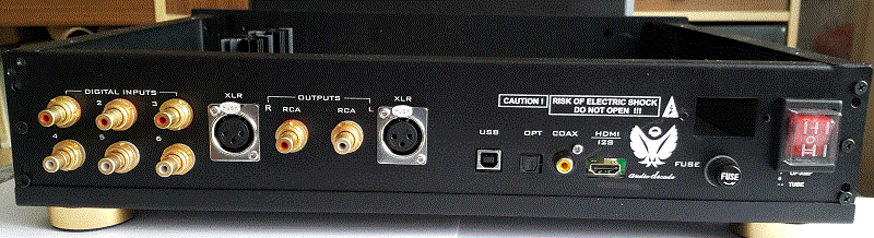

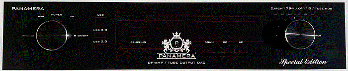

Forum dedicated to PCM1794A AK4118 + solution to all problems of the PCM1794 AK4118 Chinese tile (Polish Audio Forum , Audio, Stereo, Hi Fi, Hi End, Video - Sprzęt audio - Audiostereo.pl )
Hello
Some time ago, I promised on the forum that I would pass the report after receiving the DAC from the site and after listening. First things first.
Immediately after receiving the plate from Chinese, it looked like this:
[URL = https: //www.fotosik.pl/zdjecie/24b2534f53863a2f] [url]https://images92.fotosik.pl/115/24b2534f53863a2fmed.jpg[/url] [/ IMG] [/ URL]
The next steps related to the modernization consisted in the purchase of the housing for the above-mentioned PCM1794 AK4118 tile and the purchase of the transformer of the audio version from Toroidy.pl and the XMOS U8 board.
Transformer: audio version, TS40VA, Pri: 230V, Sec I: (2 x 9) V, Sec II: (12-0-12) V
[URL = https: //www.fotosik.pl/zdjecie/ebb41da0173f0c6f] [IMG] [url]https://images91.fotosik.pl/115/ebb41da0173f0c6fmed.jpg[/url] [/ IMG] [/ URL]
Housing: Breeze Audio with the BZ2806B symbol (external dimensions, 280x210x60 mm)
USB card: XMOS U8, 24 / 192K
[URL = https: //www.fotosik.pl/zdjecie/69faccb7b6f934a9] [IMG] [url]https://images89.fotosik.pl/115/69faccb7b6f934a9med.jpg[/url] [/ IMG] [/ URL]

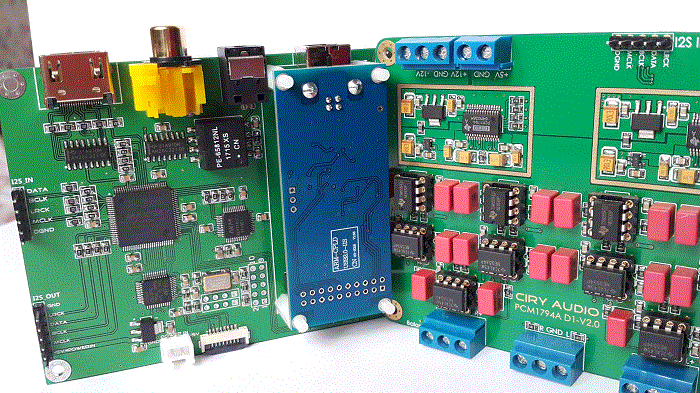

While waiting for the housing and transformer as well as the XMOS U8 card, substitution of components was started.
Listed:
a) all Chinese capacitors "red drops" i.e. from 270pF to capacitors WIMA FKP 2700pF / 250V (4 pcs) and 222 pF to capacitors WIMA FKP 2200pF / 100V, (4 pcs),
b) all blue, Chinese capacitors 104, (u1K100) are replaced with WIMA 1uK / 63V foil (9pcs)
c) changed blue, Chinese foil capacitors "allegedly 820pF" (220pF / 630V) into foil WIMA FKP 6800pF / 630V (2 pcs)
d) Most of the SAMWHA electronic capacitors on Nichicon FW have been replaced and one place for 4 x Nichicon KZ MUZE
e) three Chinese AD827JN opiums have been replaced with: 2x OPA 1612A + 1x OPA 2132PA
f) Chinese voltage stabilizers LM337 (1pc) + LM317T (2pc) are replaced with Linear LT337A brand stabilizers (1pc) + LT317A (2pc)
g) mentioned in the power supply part Chinese diodes for fast, branded Vishay SBYV27-200 diodes (8 pcs)
(h) an ordinary 1,5A glass fuse has been used in the IEC gate
i) a 2mm thick rectangular aluminum frame was ordered for dimensions of 2mm to avoid puncturing the factory housing and only then to mount all DAC elements, and a heat-resistant 0.2mm thick teflon mat with a dimension of 400 x 330 mm was ordered for this base (for lining and isolate the base)
j) a piece of brass sheet was purchased and then bent on a bending machine to perform shielding protecting against the impact of the negative impact of a toroidal transformer.
The whole, after being assembled and mounted in the housing in its place, was commissioned to check and detect the reason why the DAC was warming up on radiators and did not want to play on the second channel.
As it turned out, the reason was shorting on the condenser and damaging the path on the PCB during soldering.

Also some time ago I had a yellow film capacitors 6800pF / 100V (2 pcs) installed in place of blue, Chinese 820pF (220pF / 630) and yellow capacitors 2700pF / 100V (4pc) instead of "red drops", Chinese 270pF (271J) / 100A).
The sound was muffled and did not bring satisfaction from the music being listened to. I do not recommend .
[URL = https: //www.fotosik.pl/zdjecie/a160765dcee473ce] [IMG] [url]https://images90.fotosik.pl/114/a160765dcee473cemed.jpg[/url] [/ IMG] [/ URL]
That's why I exchanged all foil capacitors for the original red WIMY FKP.
And now you can say that it is much better. Good capacitors, price / quality, foil FKP Wima.
It was possible to use Silver Mica capacitors because it supposedly "ennobles silver" but I could not find them about the paramounts I am interested in, and the price was not encouraging after the total calculation together with the transport.

The initial phase of the DAC transducer design using Dual PCM1794A + AK4118 preamp from Ciry Audio: COMBO DAC converter (OPAM / LAMPS)Is this dual pcm1794 each set to mono mode
DAC COMBO "Pana-Mera" (op-amp / tube pcc88 philips)
Pre-designed front and rear panel of the Combo DAC called "Pana-Mera" (op-amp / nos tube). 2 system transducer based on AD744 + LT1364 op-amp amplifiers and TUBE PCC88 Philips separately. Work on the construction of the DAC is moving forward slowly. The next step will be to make an amplifier and a preamp called "Pana_Mera" based on the Accuphase A60 + clone.

This is my individual project: DAC COMBO "Pana-Mera". Dual-system: op-amp / tube. Op-amp plates (you can buy on ebay or Ali .... ss) and plates for tube (individual srpp design). Dac is still under construction.
