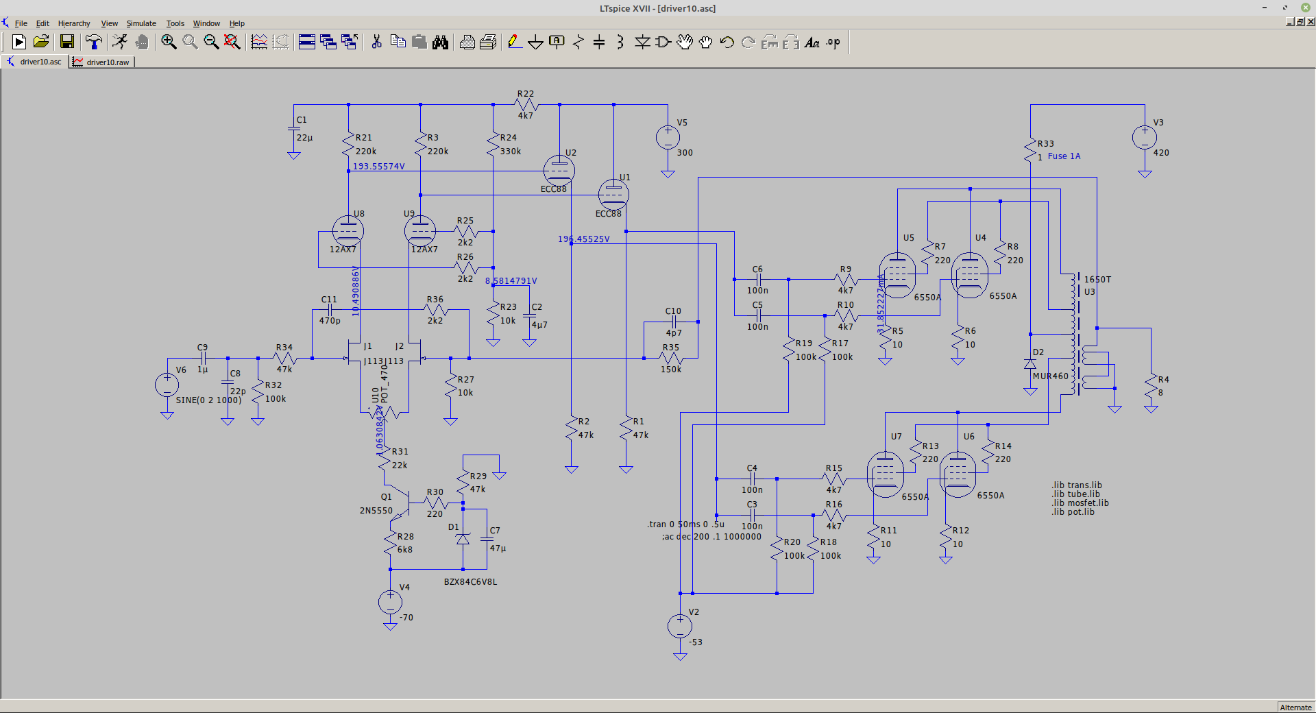

Same output, 5k Raa load:

Hi, I post here the last simulation I've done this afternoon.
This is the harmonic distortion at 88 Wrms with a quad of KT77 per channel at 450V 3k3 Raa (6k6 per pair):

Had a look at this is it your intension the build something or just for simulation.
Don't mean to be critical but here's some things.
1) You currently have a perfect transformer. If you intend to implement NFB you will need to have something closer to the real thing. This will need to include coupling factor series resistance and primary capacitance.
2) Although your you current sources are just fine something much simpler would work just as well. A simple 6v8 reference which can be shared to several 2n5550's and just a single 2n5550 would be fine. You can also share the grid reference for the 12AX7. One to try in LT spice.
3) You only have about 5dB of NFB, typically one would aim for 17dB or so. However you need to add a gain stage at the front end to achieve this.
4) Maybe a ECC88 or 12BH7 may a better follower than a 12AT7 less likely to draw grid current.
5) JFET cascade is interesting idea. A J113 would give a bit more gain. If you wanted all valve you could use a EF86 matched pair.

Thanks for your interest baudouin0,
Actually the hybrid cascode has a LSK170 on bottom and 12AX7 on top, but U440 seems more linear. It has one single pair of EL34 in UL
I would like to reuse the actual EL34 and transformers for some guitar projects I have, and buy new transformers for this KT77 project.
I've bought two monoblocks from a user of an italian forum, and then modified them to see how different nfb will sound like.Had a look at this is it your intension the build something or just for simulation. Don't mean to be critical but here's some things.
It will be a custom transformer, so I don't have information about those aspects at the moment. It will be a Toroidy transformer. Do you have any suggestion as an estimation of those data?1) You currently have a perfect transformer. If you intend to implement NFB you will need to have something closer to the real thing. This will need to include coupling factor series resistance and primary capacitance.
The grids of the 12ax7 are indeed shared in reality, it was just simpler graphically to have twice the regulators. I will simulate with one single voltage reference. The pcb already has different references for the CCS, but it's a good idea to have just one if the PCB will be redone.2) Although your you current sources are just fine something much simpler would work just as well. A simple 6v8 reference which can be shared to several 2n5550's and just a single 2n5550 would be fine. You can also share the grid reference for the 12AX7. One to try in LT spice.
Do you think it would be better to reduce shunt feedback and increase gnfb? In the current design I've no gnfb at all.3) You only have about 5dB of NFB, typically one would aim for 17dB or so. However you need to add a gain stage at the front end to achieve this.
Ideally it would be better to apply the biasing voltage to the grid of the driver and dc couple the driver to the grid of the KT77s. I will try your suggestion as well, trying to find a tube with good linearity without too much current needed through it.4) Maybe a ECC88 or 12BH7 may a better follower than a 12AT7 less likely to draw grid current.
I know a pensotde would be even better, but I've found the cascode being nice sounding and quite simple.5) JFET cascade is interesting idea. A J113 would give a bit more gain. If you wanted all valve you could use a EF86 matched pair.

I just making suggestions - having a look at your simulation and a simulation of 6550 amp. The problem you will have is getting enough closed loop gain without an additional input stage.

I will send you an accurate simulation. It does change where the bias ends up as there is less current flow. If you can shift the bias point a little out of cut off it can make a big difference. It just that peak clipping often goes unnoticed whereas the ear will find blocking distortion objectionable.
A typical small to medium grid current will make the grid to cathode resistance be on the order of 1k Ohms.
A grid stopper resistor of:
A. 470 Ohms,
B. 4700 Ohms,
in series with a grid to cathode resistance of 1k
Using a 0.22uF coupling cap for example . . .
Time constant of 1.47k and 0.22uF = 323uS
Time constant of 5.70k and 0.22uF = 1254uS
The time of one alternation of 1kHz is 500uS (fairly close to the 2 time constants above).
Suppose the grid bias is -30V.
The driver swings to +30V peak. No problem.
The driver swings 1dB more than that, +33V, that is a problem. There will be bias shift.
Using a 1kHz note, the time of the excess 3V is quite short.
But instead, use a 40Hz bass note, the time of the excess 3V is much longer than 722uS.
So 20Hz, a "Golden" Hi Fi number, is 1444us (compare that to 1254us above)
IRMC (I hate acronyms, so I will write it out I Rest My Case).
A. 470 Ohms,
B. 4700 Ohms,
I took Zintolo schematic and overloaded the input. I can see very quickly that blocking distortion develops. I changed the 470 grids to 4k7 and this made little difference. It was not until I got to 22k that things really improved. However at 22k this may well effect the stability of the NFB would have to check. So unlike guitar stages with 12ax7 which are using 100k upwards anything below 10k makes little difference. So there you are. It may be using a follower makes matters worse here as often you will already have say 33k plate resistors.
Oddly enough the 6550 schematic I throw together is much better with blocking distortion and again the grid resistor makes little difference. Maybe what's more important is the drive circuit should not go too much positive.
So YRYC
So YRYC
I've asked to Toroidy, they can build a custom transformer for a quad of KT77 per channel, adding a custom 5,5 Ohm tap on secondary, at a very good price. I'm towards that choice at the moment.You won't need a custom transformer. There's plenty of transformers for KT77 Hammond, Sowter, Edcor, Toroidy etc. Lot and lots. Just ask on a fresh thread.
But I'll keep you suggestion to open a dedicated thread about it.
Thanks!
Do you think the SS section of the forum is a better place to ask for a better Jfet?Yes you might get there with the lower drive of the KT77, slightly bigger plate resistors and a good choice of JFET. Try and get as much gain as possible so you can have as much negative feedback.
Thanks, I will!I forgot to mention I would increase the grid resistors to the KT77 to reduce blocking distortion. Say 2k2 or 4k7 rather than 470R.
Thanks again, what a beast!
