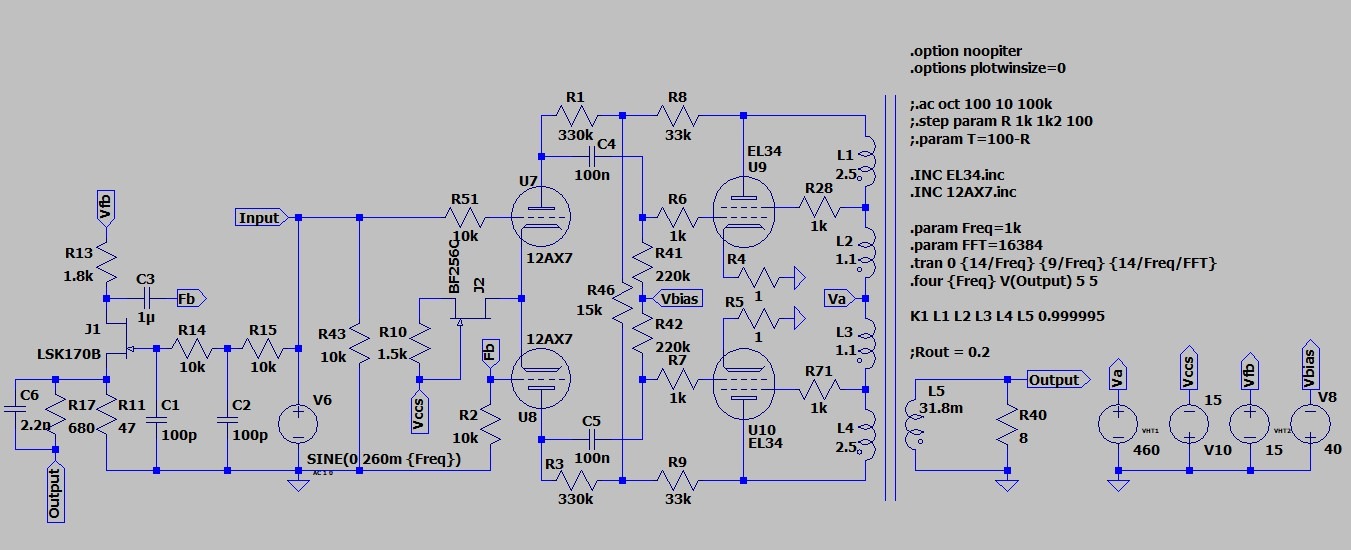

I just noticed how the circuit I'm using now:
improvements on 12AX7 12AT7 EL34 schematic?
Is similar on the feedback paths to the idea that Mona posted here:
Sim of RCA Tube Manual 50 Watt Amplifier - results and questions

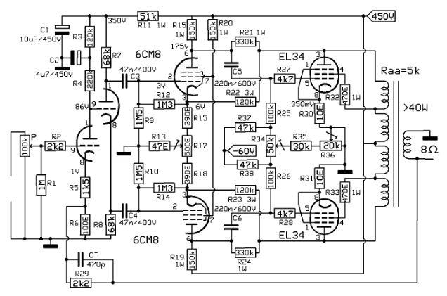

I interpreted "my" circuit as a Mona/RCA amp with the pentodes of the 6CM8s acting as an high gain phase splitter, so without the triodes' stages. The EL34's plate to grid feedback is still there (even if reconfigured à la Yves Montmagnon / Gingertube), and the EL34's plate to driver's cathodes (sources in my case) feedback is still there too, plus gnfb.Yes your JFET-12AX7 has similarities with high gain pentode. However the phase spitter is in front of this and the pentode provides gain, more common mode rejection and buffering to remove the unequal impedance. There's also no buffer after the pentode - so maybe not so much in common.

Your OK to do that it's just reflected back in the primary impedance as you explained. You can draw load lines for the EL34 and many will explain much better how to do this. I'd just try it on LTspice until I get the max power transfer. However, you won't get the twice primary inductance so the bass roll-off will be higher. So if you want to do this start with a high Lp. So adjust L5 for max power before clipping which will give you the best turns ratio you need. II think you will be looking at about 5-7K Raa for Va = 400V.

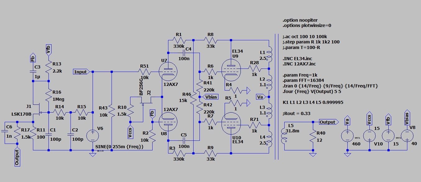

The basic idea comes from an article appeared on Wireless Engineer on 1933, page 413 and following ( https://worldradiohistory.com/UK/Experimental-Wireless/30s/Wireless-Engineer-1933-08-S-OCR.pdf ): scale down the amplified (and inverted in phase) signal, sum the input to it and so obtain a signal that is only the error of the amplification (aka the distortion), then amplify it and apply as feedback.
On simulations I get a Rout of 0.2 Ohm, 1 Wrms @ 0.004% THD and 40 Wrms @ 0.07% THD.
Not tubey anymore? Yep, probably, but then it's just a matter of reducing the Fbk.
I attach the LTSpice file if you want to play with it.
For this specific project I would like to keep the cheap transformers I already have bought with that amp and reuse them for an indeed cheap (but very good on simulations) project. I want to try if this could become like "La Vespa" of amplifiers.

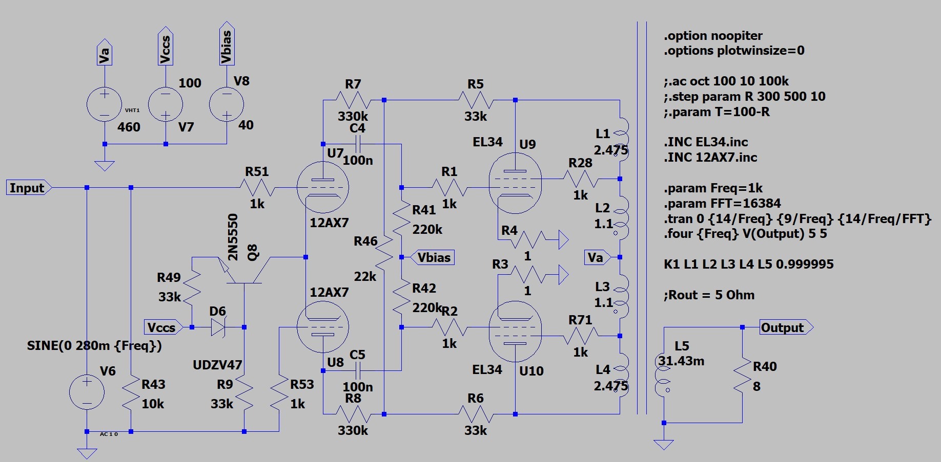

I was thinking about the CCS, and I know zeners are noisy, but on the tail on a phase splitter the noise should be canceled, am I right?
I was then thinking to use the full 80Vac winding I have available (and a zener instead of the red led) to have an higher impedance on the tail of the LTPI.
At the moment I've removed the feedback circuit from the schematic to focus on this part.
Then, concerning the feedback, I was thinking to use an OPAMP, because I can DCcouple it to the grid of the second triode of the LTPI and avoid a capacitor in the feedback loop. This way should be more stable.
You don't need a DC cap in the feedback as both the output and the grid of U8 are at DC ground. the zener use a low voltage one say 5v6 which are much more stable and less noisy. Some spilt R46 and take a current mirror from centre.

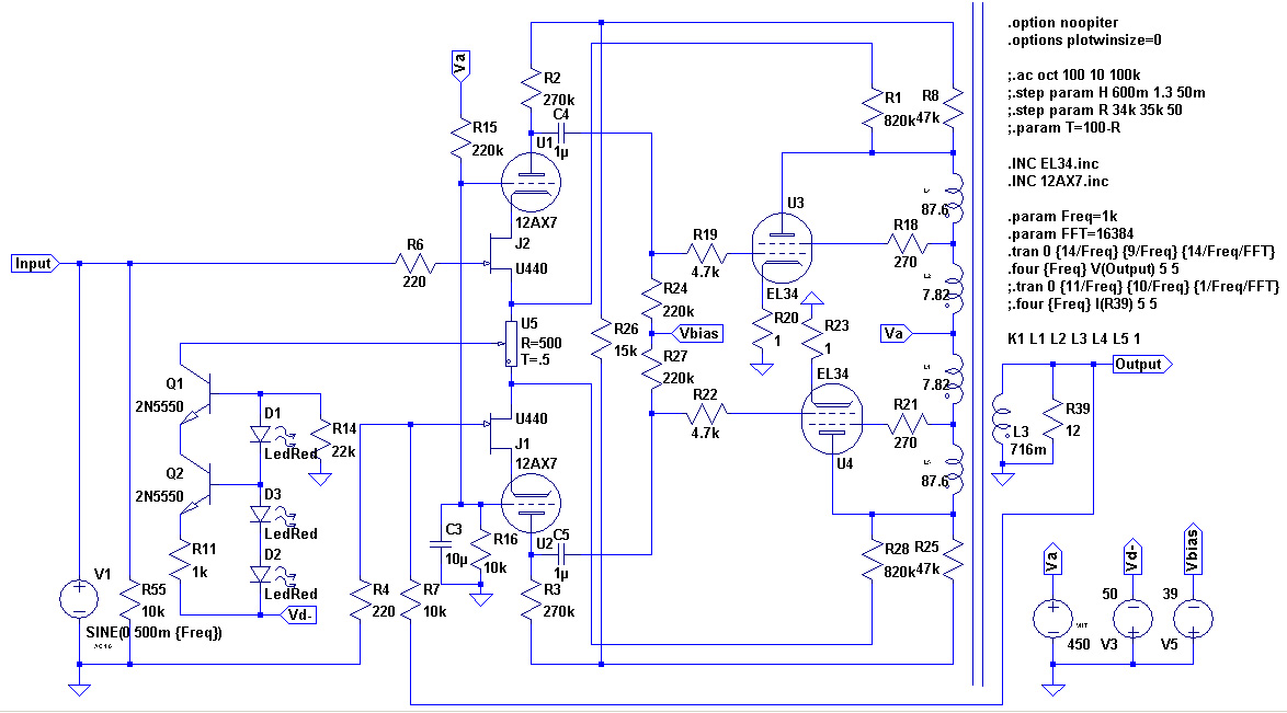

I didn't explain it correctly. When I was talking about using the OPAMP for feedback to substitute J1 on schematic at post #212 ( https://www.diyaudio.com/community/attachments/pp-el34-ul-schade-corrdiff_02-jpg.1093253/ ) that I omitted in the last circuit to focus on the simple circuit.
Thanks for the tip on the zener and on R46!
