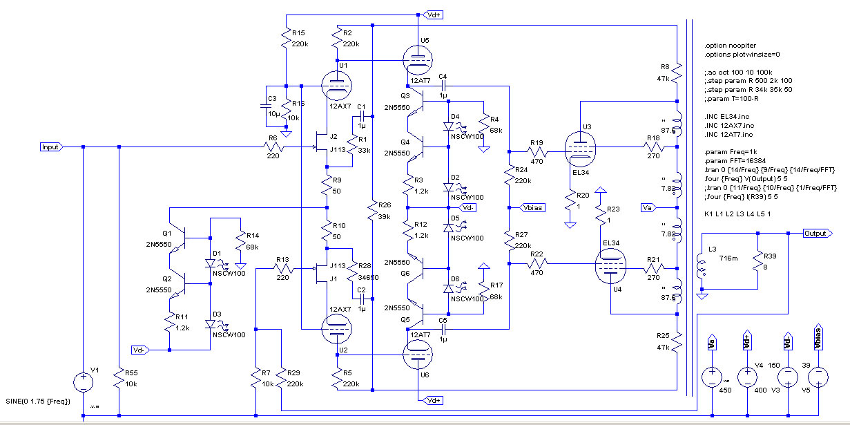

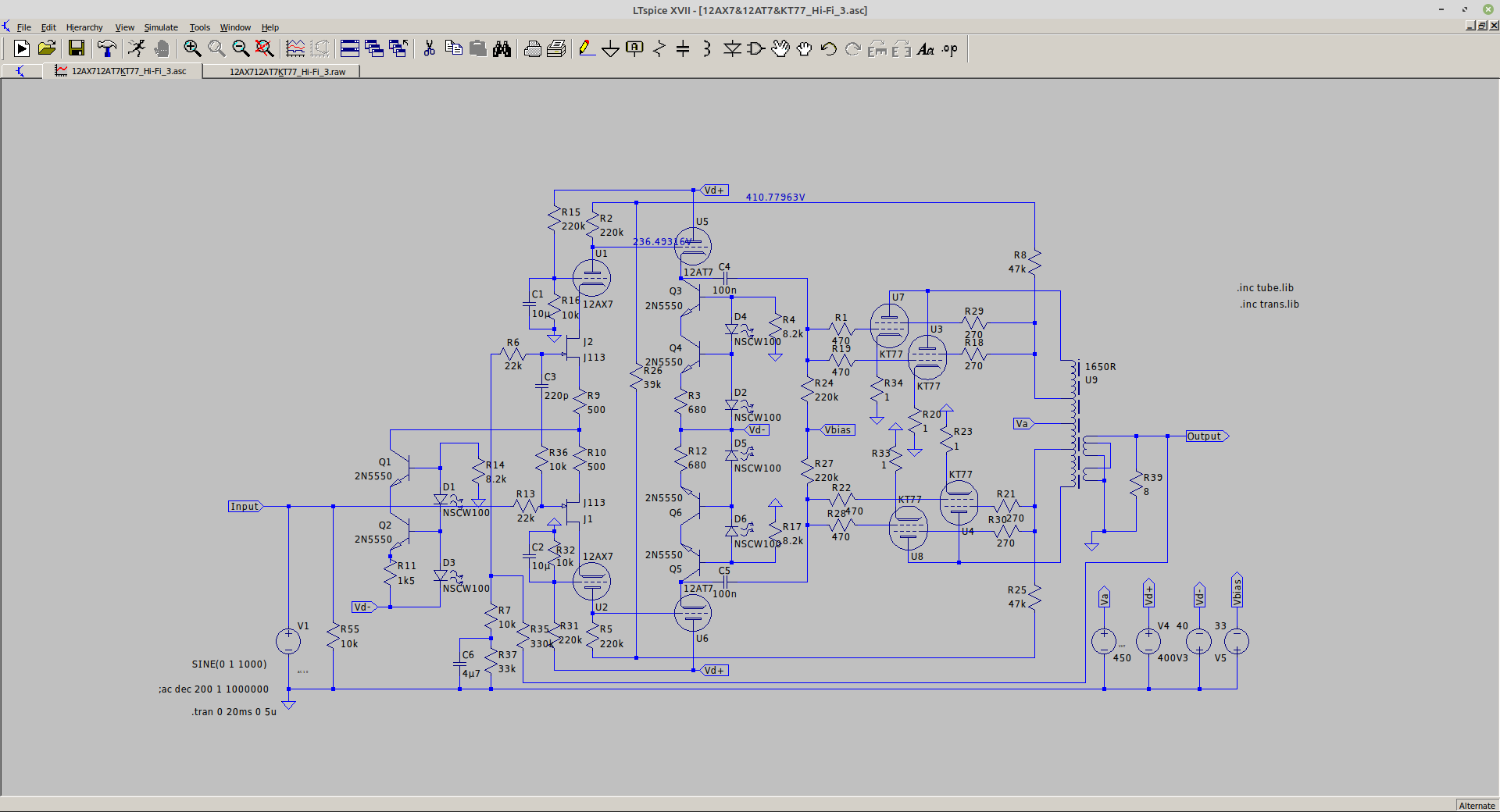

I've done some further tests on the amp with EL34, and then optimized the applied concepts on LTSpice.
The results at 52 Wrms with a pair of EL34 are as follows:
Code:
Harmonic	Frequency	 Fourier 	Normalized	 Phase  	Normalized
 Number 	  [Hz]   	Component	 Component	[degree]	Phase [deg]
    1   	1.000e+03	2.867e+01	1.000e+00	   -0.03°	    0.00°
    2   	2.000e+03	2.410e-02	8.406e-04	  -87.61°	  -87.58°
    3   	3.000e+03	1.558e-01	5.436e-03	    0.02°	    0.05°
    4   	4.000e+03	1.467e-02	5.117e-04	  -89.27°	  -89.24°
    5   	5.000e+03	1.191e-02	4.155e-04	 -176.29°	 -176.26°
    6   	6.000e+03	1.084e-03	3.782e-05	   95.36°	   95.39°
    7   	7.000e+03	2.360e-02	8.230e-04	    2.17°	    2.20°
    8   	8.000e+03	6.300e-04	2.197e-05	   86.74°	   86.77°
    9   	9.000e+03	1.310e-02	4.569e-04	 -179.41°	 -179.38°
Total Harmonic Distortion: 0.561911%(0.562431%)

I've noticed that, at full volume, without gnfb there are some sibilant S in certain recordings . Adding gnfb eliminates the problem at full volume but makes the sound less pleasant at low&mid volumes. In the guitar amps I build for me, I always add a variable gnfb from the secondary of the output transformer to the PI (plus two other filters for lows and highs).
Has anyone ever succesfully added a variable gnfb control on an Hi-Fi?
Thanks baudouin0,
last weekend I've implemented a pot and a switch for the gnfb.
Going lower than 10 kOhm caused udible low frequency oscillation, so my idea is to implement a 15 kOhm resistor in series with a 50 kOhm lin pot with push-pull switch to disable the gnfb, in order to give no to low gnfb at low volumes and add more at high volumes and adapt the sound to what we are listening: Adele is better with no gnfb, James Taylor live at Beacon Theater is better with high gnfb, Rage Against The Machines depend on the track and the volume I'm listening them to, Mozart's Requiem is better with no gnfb at all.
Current OPTs are quite bad in all parameters and they will be substitued when all details will be determined (and most probably it will become a quad/sextet of EL34s each channel).

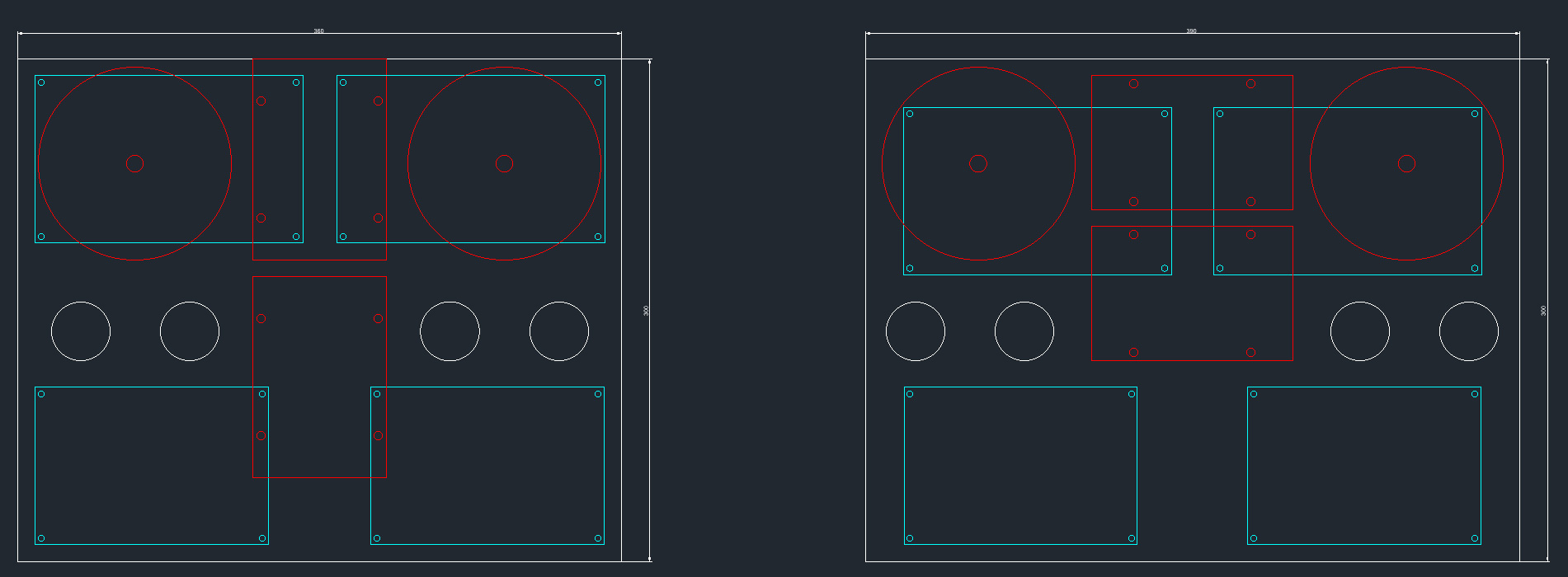

Now the amp is split in two monoblocks with a footprint of 430x250 mm (standard Hammond cases), and they are too big and not so nice.

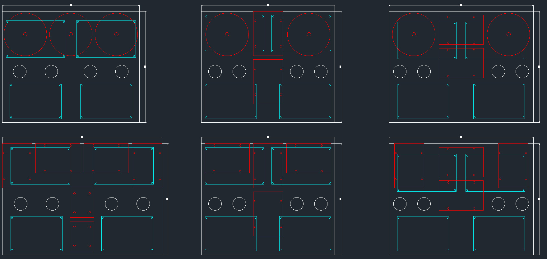

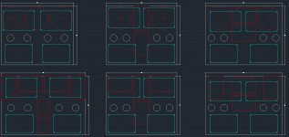

I would like to rebuild the amp as a single stereo chassis and yesterday evening I've sketched some possibilities. One implies new transformers (preferrable from a performance point of view), the others uses existing ones (economically preferrable).
I would like to ask your suggestions on them.
Just consider that:
- Chassis and EL34 holes are white;
- Transformers are red;
- Pcbs are blue (power supply on top and PI + Driver on bottom)

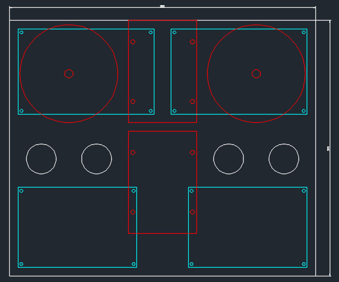

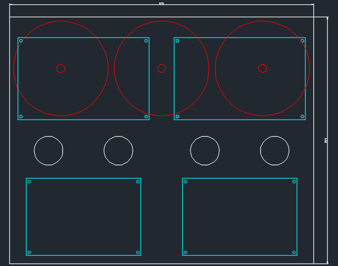

First one is with a new set of transformers: right impedance, right UL taps (23% instead of 40%), higher primary inductance, etc.. vs higher costs. It's 370 x 300 mm. I would keep this option as last by now due to costs.
attachment.php
Second one is with the EI transformers I have now, including the inductors. The space kept on top of the inductors will be used to install fuse holders.
It's 430 x 300 mm.
attachment.php

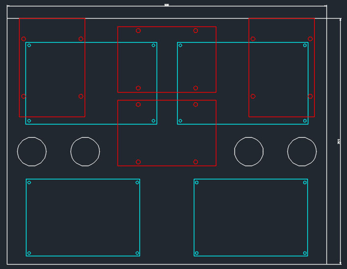

Third one is again with EI transformers, without inductors, with a T configuration. What I don't like of this configuration is that power transfomer is too close to volume pot on the central-front part, so it will be most probably prone to catch noise. It's 360 x 280 mm.
attachment.php

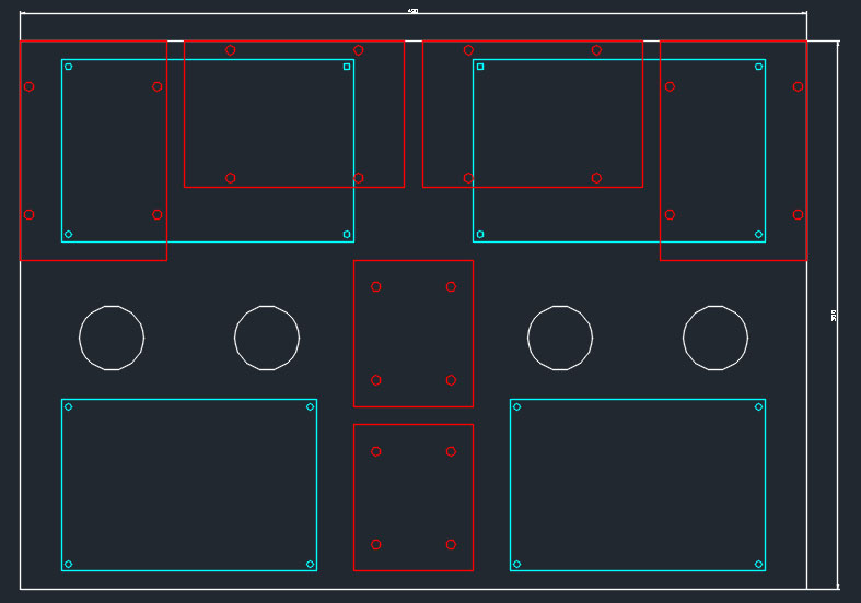

Fourth one is again with EI transformers, without inductors, rotating each transformer by 90°. It's 390 x 300 mm.
attachment.php

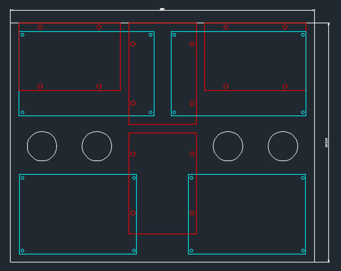

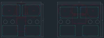

This is another version that could be a good compromise between costs and performance, implementing just the output transformers with the right specs and keeping the EI transformers as they are, without inductors (or mounted internally on one side of the chassis). It's 360 x 300 mm.
...don't turn the image upside down or it could seem offensive 🙄
attachment.php

I update the thread because I've ordered custom OPTs from Toroidy based on standard EL34 transformers so 6.6 kOhm Raa but with taps at 23% (they perform better with the current design), so the layout will be one of the following:
attachment.php
