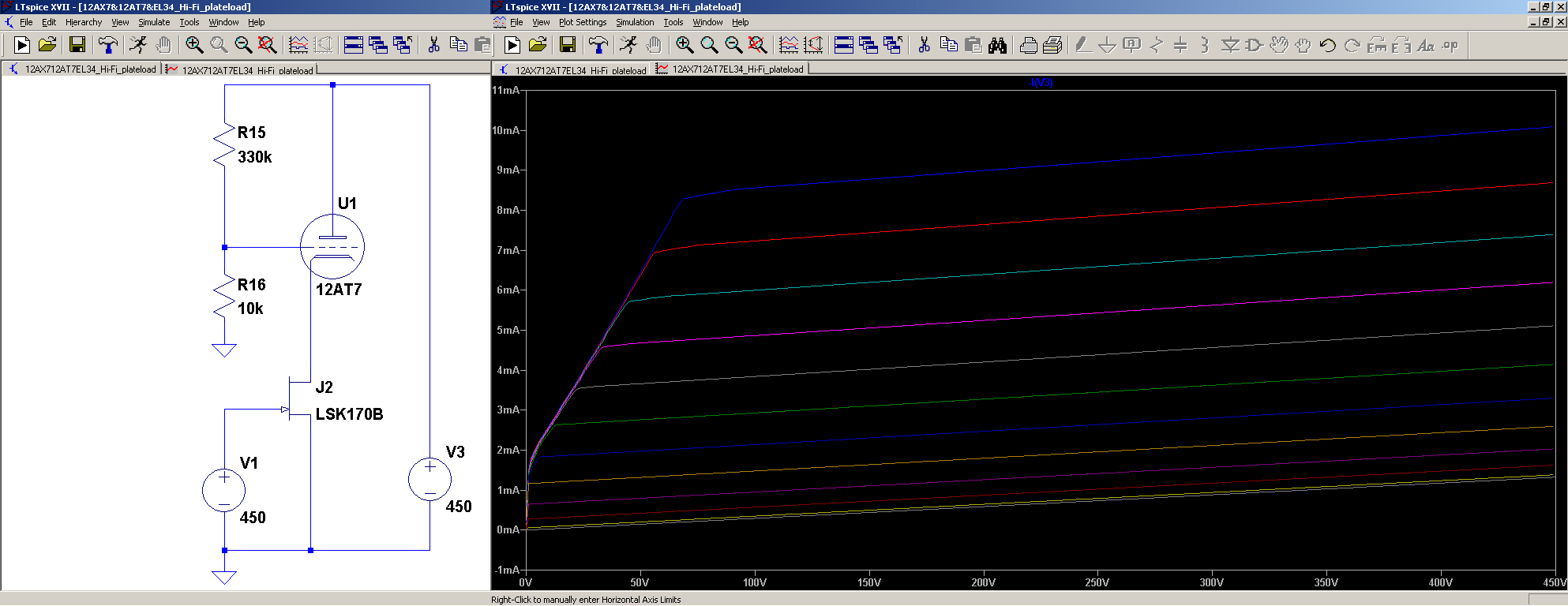

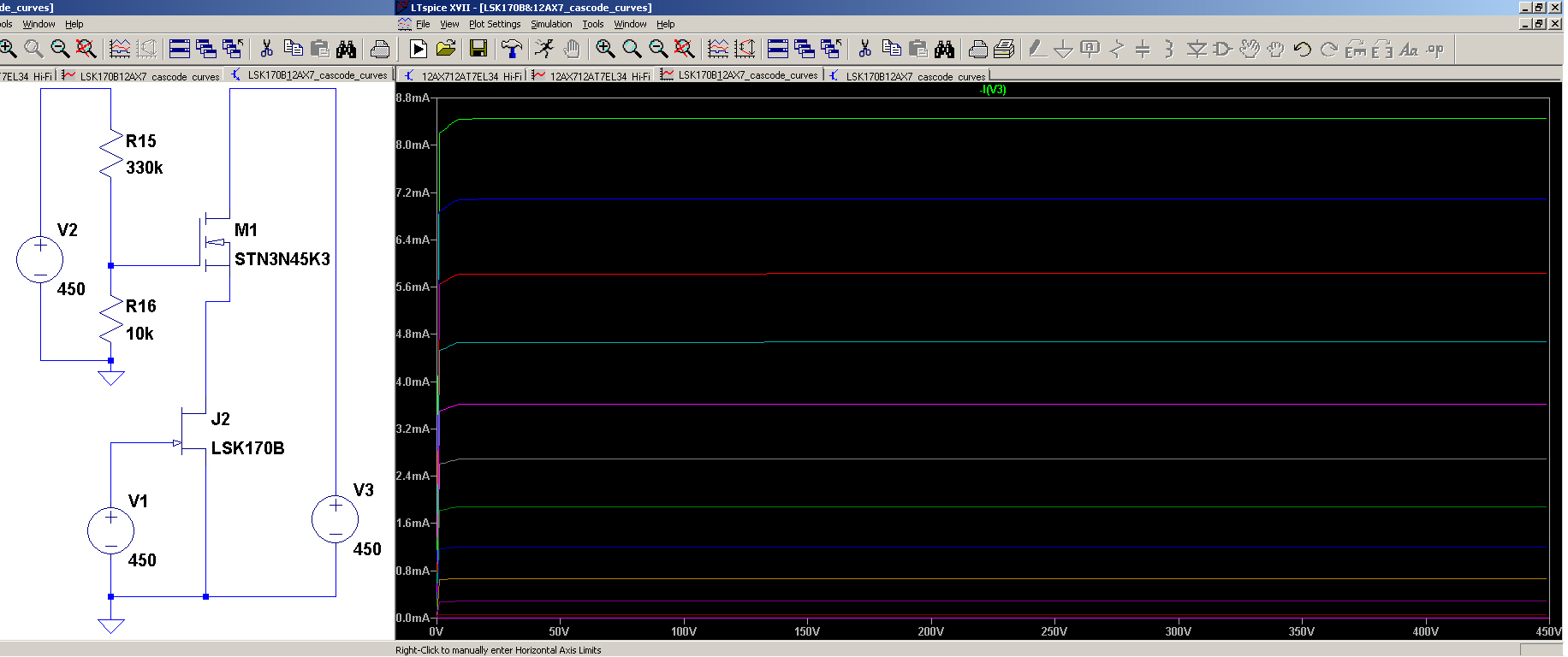

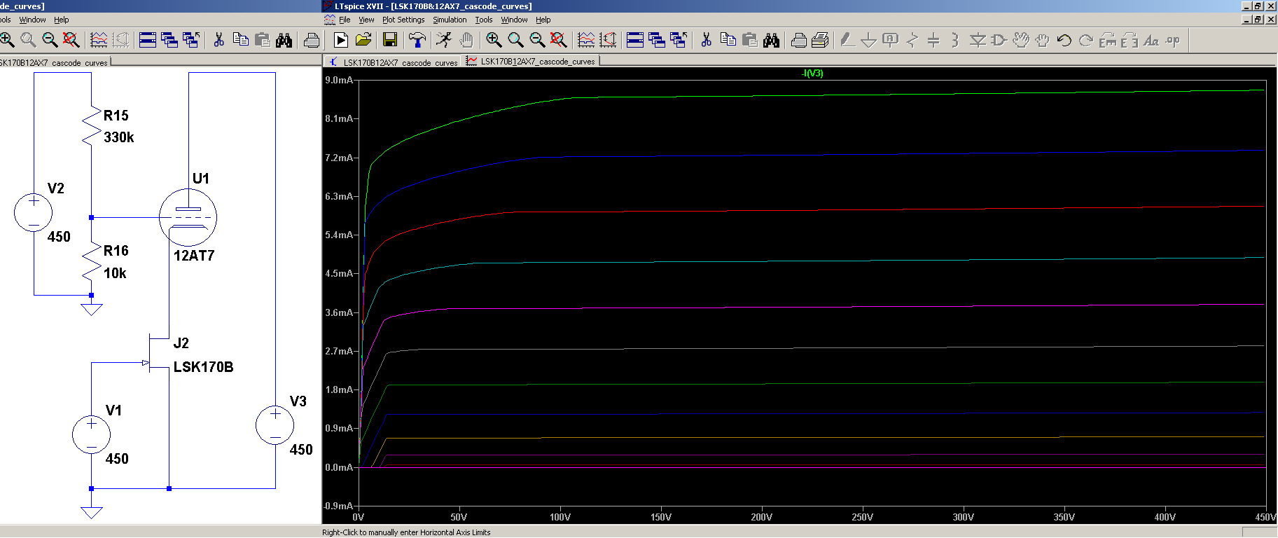

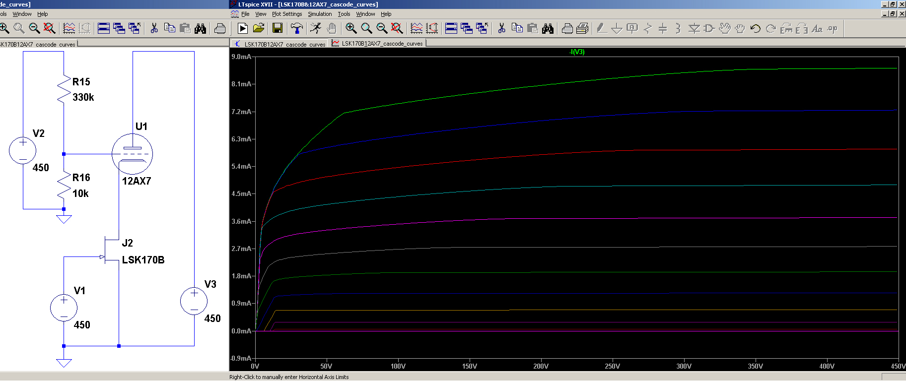

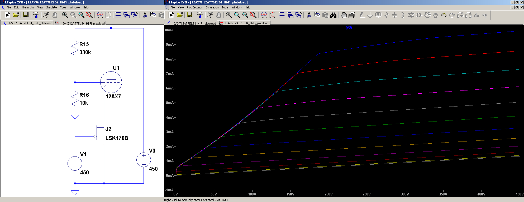

I add here the curves for the PI with 12AX7 (as it is standard) and with 12AT7:
- Changing the voltage divider by increasing the ratio, moves the knees towards the right side of the plot;
- Changing the tube from 12AT7 to 12AX7, moves the knees towards the right side of the plot.
