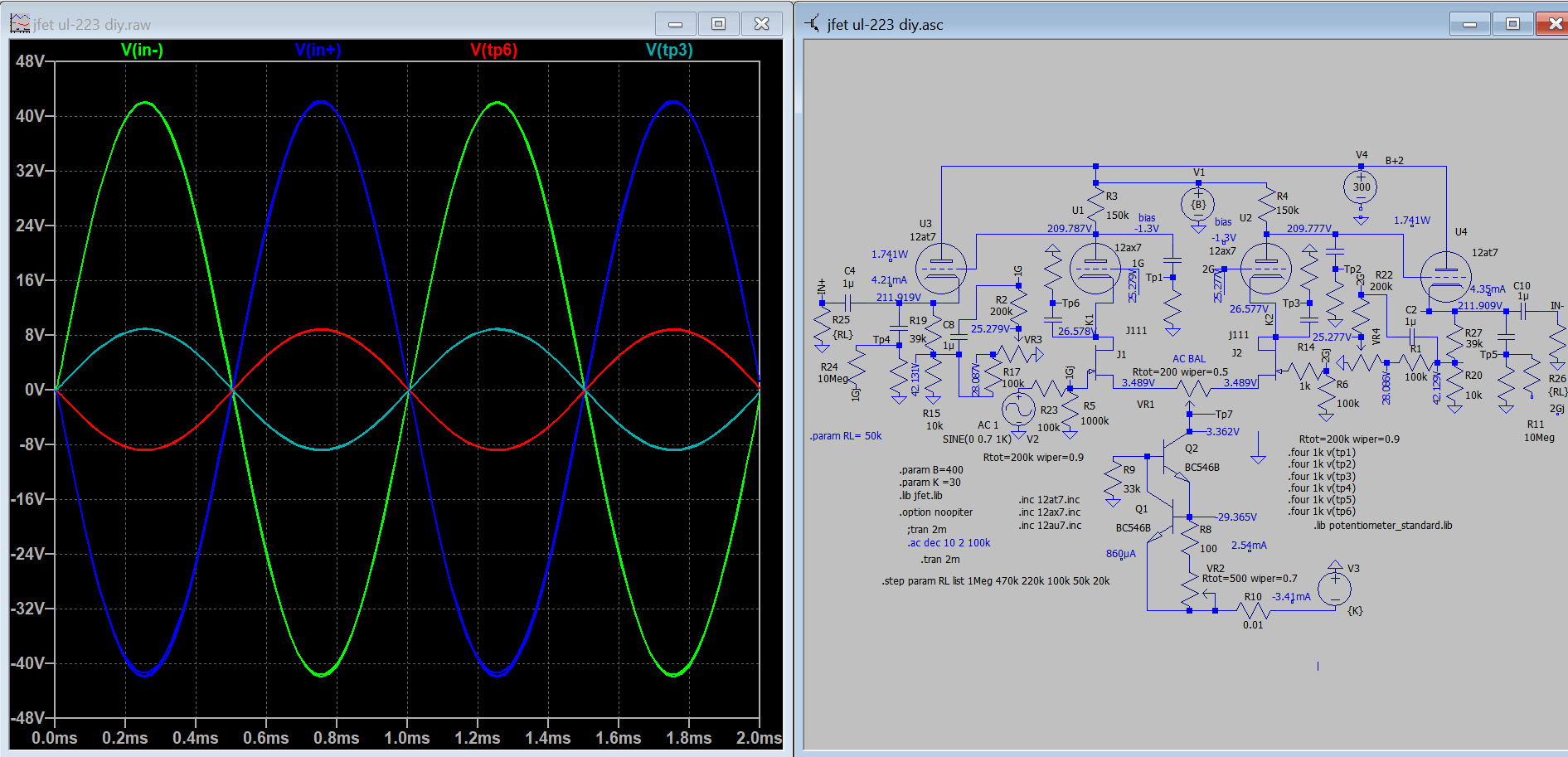

Here is the result of stepped load:
.step param RL list 1Meg 470k 220k 100k 50k 20k
  • jfet ul-223 diy.log.txt

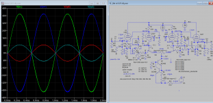

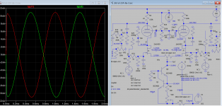

I've done some simulations and I've found a good circuit.
There's local feedback from driver's cathode to jfet's gate plus gnfb.
I've reduced the current flowing through jfet and 12AX7 to 600 uA and got the following results on 8 Ohms:

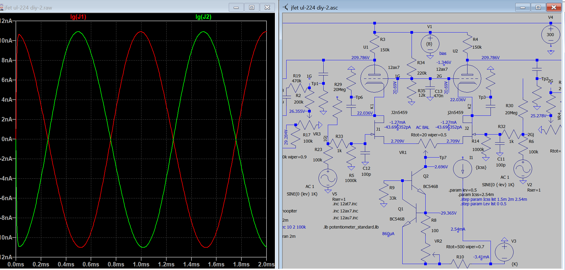

Koonw,
Post # 81:
Huh?
It has a bipolar transistor current source (sink), that drives a pair of JFET current sources.
I think the only way for that to work well is if the total current of the pair of JFET current sources exactly equals the current that is dictated by the bipolar current source.
If the bipolar current source (sink) current is greater than the total of the two JFET currents, then one JFET is going to draw Gate current.
Or what did I miss?
Thanks!

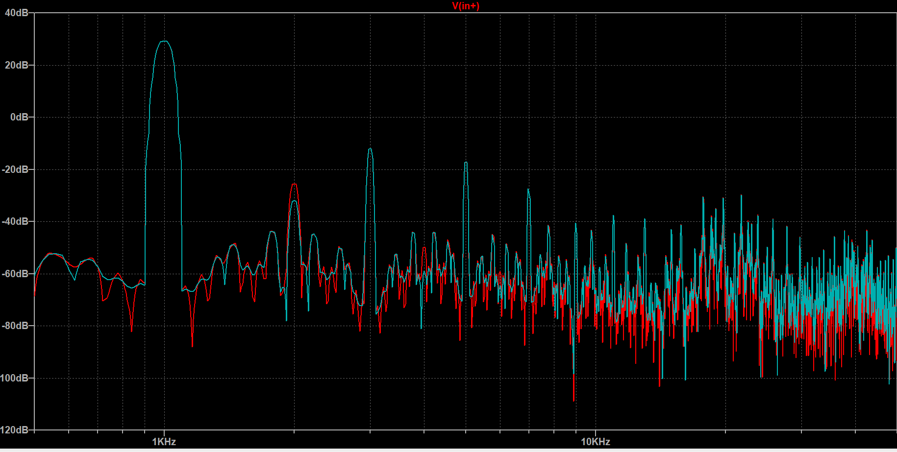

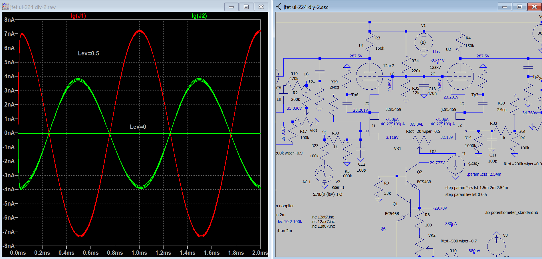

It certainly could be one of the cause. Another cause is potential between the drain and source must be identical for identical gate current. The original has a common bias for 12ax7s, so one can get identical potential for both jfet. Also that is why matched pairs is necessary as small variation in params cause gate current to be unbalanced. I'm not sure if you do get identical gate current one way or the other, the feedback result is also identical?. Will check again..
In this sim I use common bias for both tube, so the idle gate currents are same. Same model for jfet and zero feedback.
Here is the result compared when zero and 0.5vp input signal, the output from drain are about the same.
Operation level:Constant current source is 2.54m
.step param Icss list 1.5m 2m 2.54m
.step param lev list 0 0.5
It's the last issue I have.
The issue appears resolved when I add another input sig gen so both becomes balance input rather than unbalance input, that probably explain the difference in gate current of right jfet. Now the feedback distortion look much consistence with each side.
