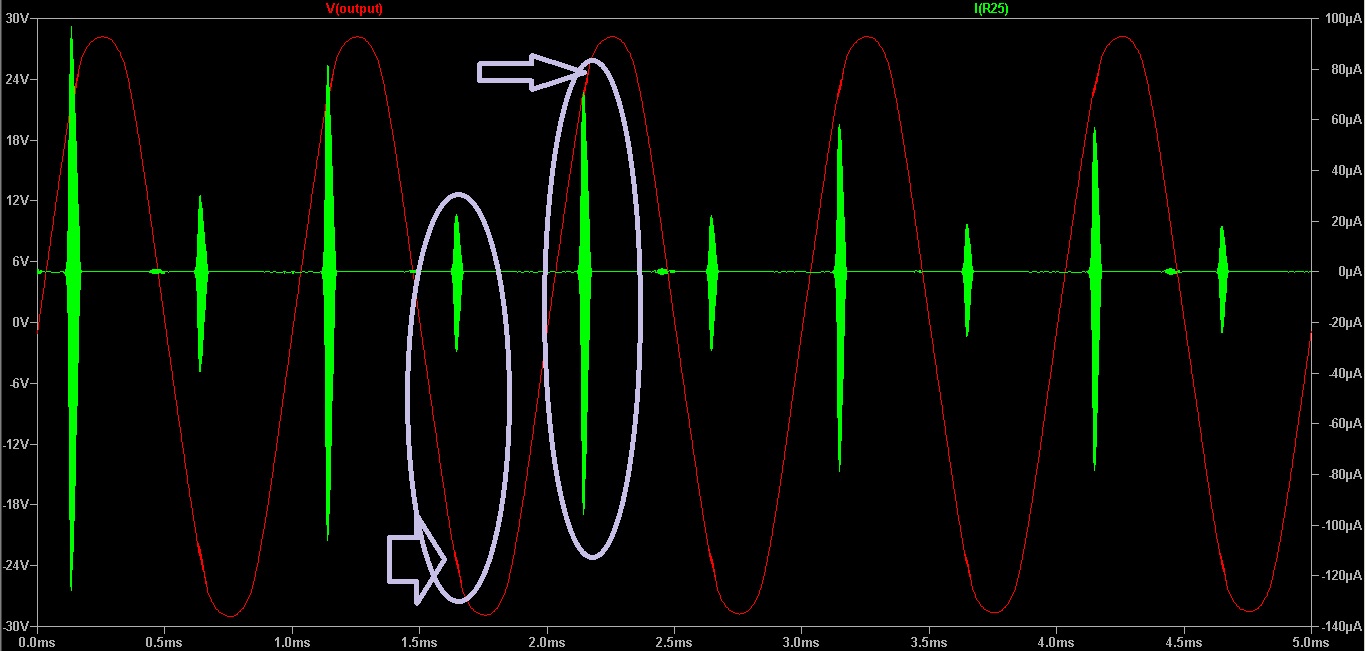

1uF will be to do with preventing motorboating/LF peak. One day I will measure some modern 6550's for g1 current at max power dissipation. Although 50k is on the data sheet a lot of schematic have 100k grid leak. The the current arrangement you will get some positive volts on the EL34 but you will also get blocking distortion. Certainly there is benefit in going up to +5v grid on 6550/KT88/EL34's. The miller effect will be needed to get the dominate pole so improving the HF handling will affect stability. This won't show up in LTspice without an accurate OPT model. Those spikes on simulation you do see on real amps - you may need to add a dominant pole.
I don't think you need to DC couple the driver. Even with AC coupling the grid will go above 0v - check on your simulation. The only problem it that will charge the DC coupling caps and make the bias more negative - you will see this too. Making the grid stoppers on the EL34 helps 4k7-10k.

I also attach a simulation with some spikes of oscillations. Can anyone explain me why they are there? Simulation error or real instability?

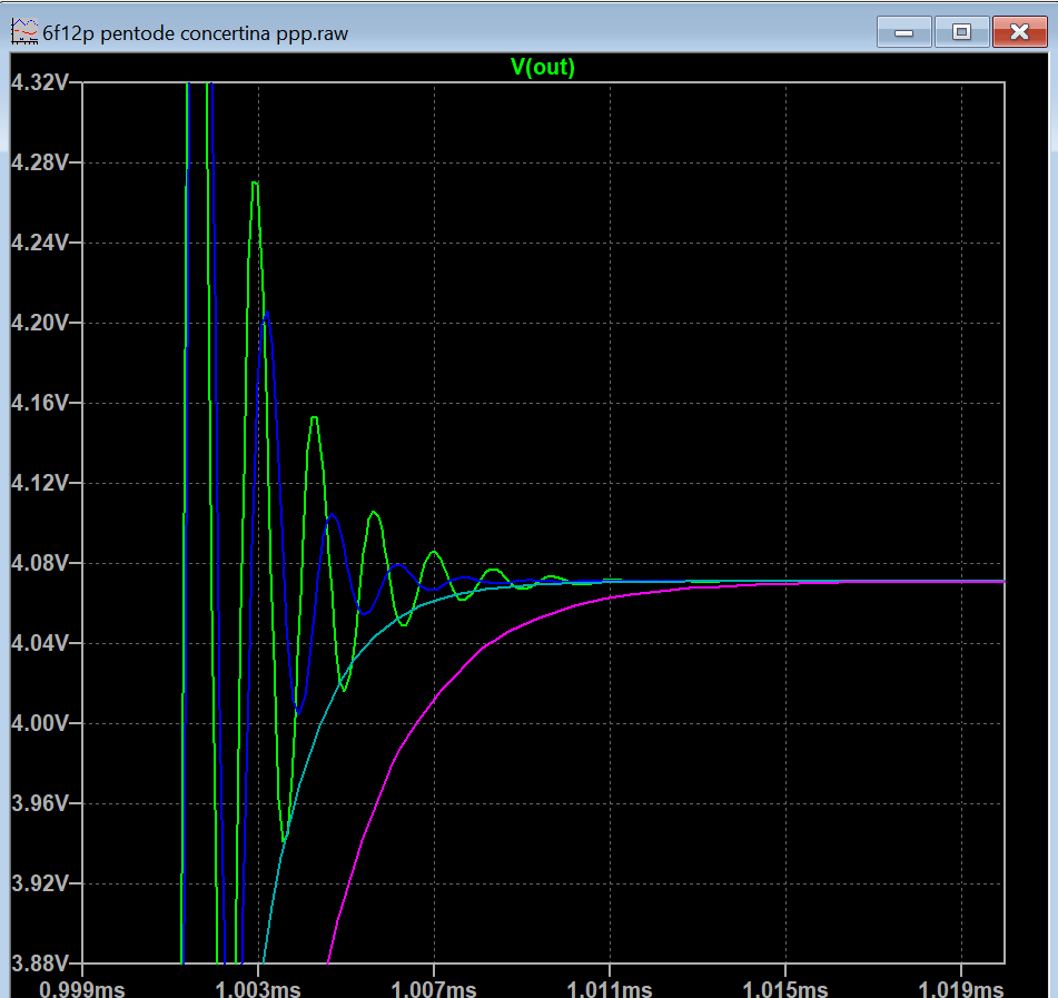

From the snapshot, I figured that the higher frequencies are spurring out of the output waveform, very similar to ringing (not steady oscillation), as it increased with output level. You can see better with square wave, and must you need to experiment with value of Zobel circuit in the output, the frequency of spur is quite high so it needs to be lowered if not eliminated. Since there is no NFB so you can rule it out as the cause.

Thanks Koonw,
I found it being a limit of the simulation. There's no trace of it in real amp.
As for the zobel, I will definitely add them between DL taps and anodes, as it was suggested by old documents on DL. I will start with 1 kOhm + 1 nF.
Yes, the zobel on secondary has no effect since it's not in the (NFB) loop, so it'll be on primary. You can fine tube K coupling factor and inter winding capacitance so it's better match to real components, wish you happy diy-ing.
One of easier way is by virtual inspection: the correct values will change the frequency of ringing, not the just the amplitude. I have pdf document for the complete procedure, but try this.
Here is testing square wave where f is frequency of interest:
Enter this to sig gen you get the square wave:
PULSE(0 0.5 0 1u 1u {1/2/f} {1/f})

.step param Cz list 0.05n 0.1n 0.5n 1n 1.5n
You mention 1n and 1k zobel with 1k square wave, so here is the result of 1k with above caps in plate of my amp sim, for sharing what I meant. Pink curve is 1.5n is over specified and others under specified values.

The simulation is only as accurate as the models you have. For example the transformer could include some primary capacitance, and the leakage inductance may be measured at a very different frequency to the oscillation. Even with this its only an approximate model. However it does give a good indication that there is a potential problem.
Try increasing the screen resistors a bit this may help.
