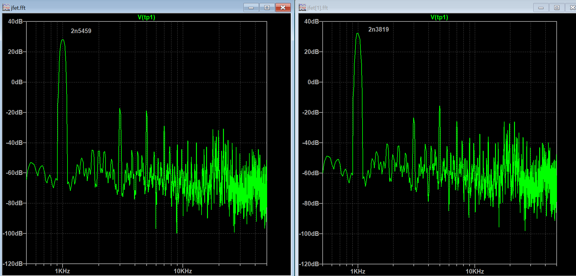

Yesterday I played a bit with LTSpice and different values of CSS together with different plate resistors. I will report here some results with currents above 1 mA. I've found some sweet spots (again, based on models) where, without gnfb, there's very low THD and it's mainly 3rd harmonic.
Of course, the higher the current, the lower the plate resistors, so the lower the gain of the PI. I need to check what will be the acceptable limit with my DAC.

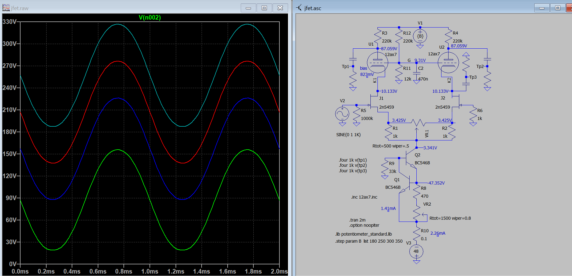

Which schematic you're simulating? Another way is to vary the plate supply voltage, say from 180v to 350v, the DC to next stage can be varies from 90v to 250v while the output level and distortion remained the same. This happens due the constant current source.

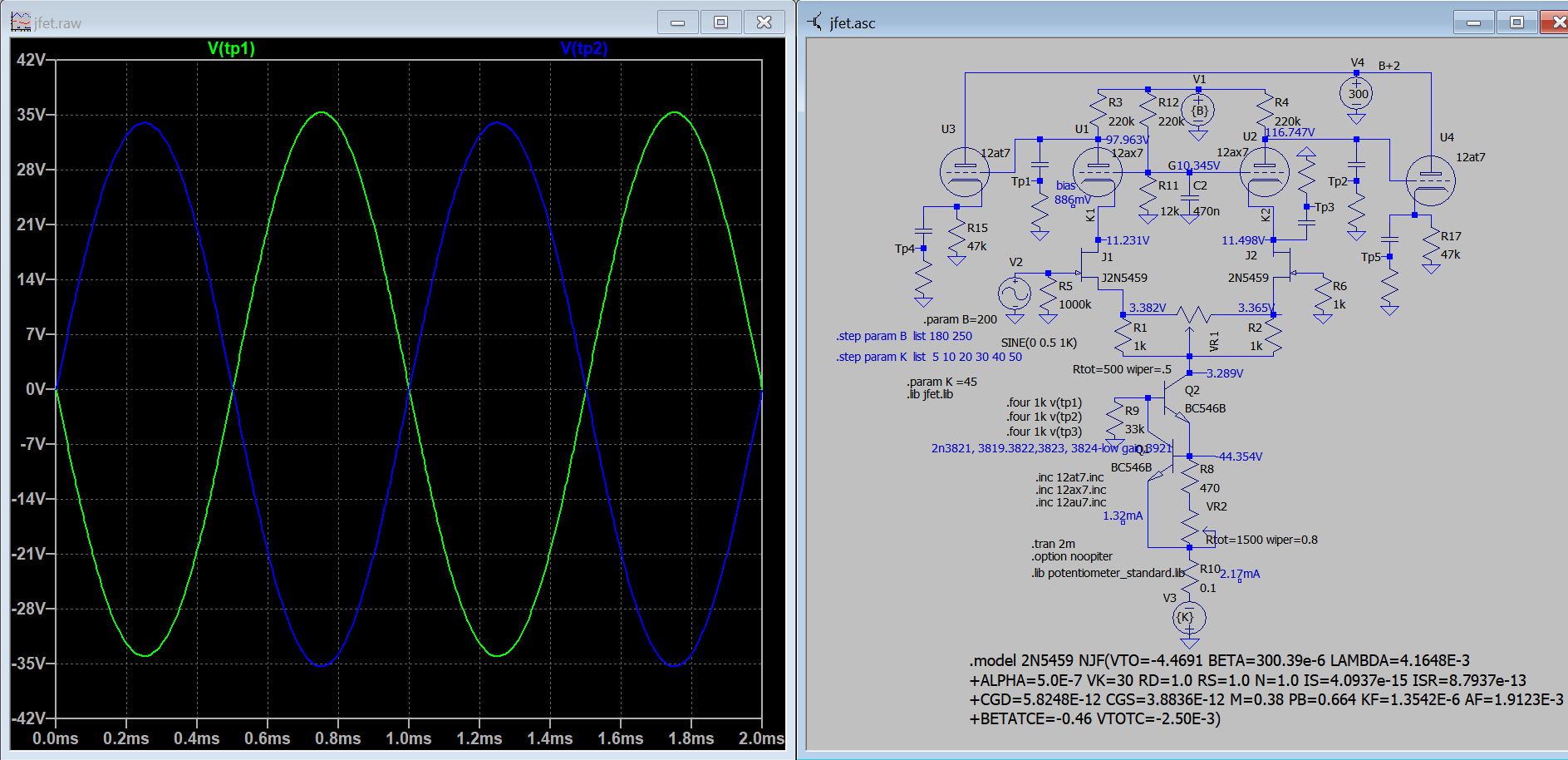

Thanks for the simulation Koonw, I'm simulating the full schematic, so yours plus the driver and the power amp with EL34, 430VB+, 7kRaa, 43%v DL, cathode feedback grounding the 4 Ohm secondary tap and using the 0 and 16 Ohm taps.
This is how it is now. I'm trying without gnfb by now, trying to improve it that way, then implement gnfb later.
This is the model I used, it is easy to change the param but which one is most likely to vary?

Rather than do that pick another JFET which is very similar. I`ve used J111-J113 before which gives you a spread to see what happens. Or use one as a 2N5458. You may well need a matched pair anyway. It will give you a feel for tolerances.

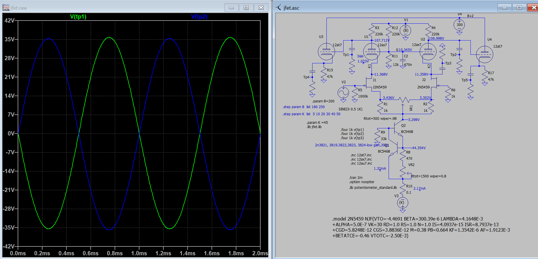

In this sim I use a pairs of 2n5459, in one model Beta is adjusted down by 20%, and it shows that can be balanced (the pot almost reach limit of 1) as shown by 2nd attachment.

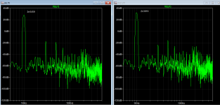

I report here some simulation results of the complete amp (without gnfb) at 8 Ohm secondary tap and 30 Wrms:
1 mA (Rcss = 1k5) and 82k on PI's plates:
Code:
Harmonic	Frequency	 Fourier 	Normalized	 Phase  	Normalized
 Number 	  [Hz]   	Component	 Component	[degree]	Phase [deg]
    1   	1.000e+03	2.216e+01	1.000e+00	   -1.29°	    0.00°
    2   	2.000e+03	6.006e-03	2.710e-04	 -158.89°	 -157.60°
    3   	3.000e+03	4.217e-02	1.903e-03	    8.85°	   10.14°
    4   	4.000e+03	4.563e-03	2.059e-04	  127.47°	  128.75°
    5   	5.000e+03	4.114e-02	1.857e-03	  177.76°	  179.05°
    6   	6.000e+03	2.593e-03	1.170e-04	 -138.99°	 -137.70°
    7   	7.000e+03	1.281e-02	5.780e-04	   -3.67°	   -2.38°
    8   	8.000e+03	1.484e-03	6.695e-05	  156.60°	  157.89°
    9   	9.000e+03	5.954e-03	2.687e-04	  175.28°	  176.56°
Total Harmonic Distortion: 0.275825%(0.276304%)
