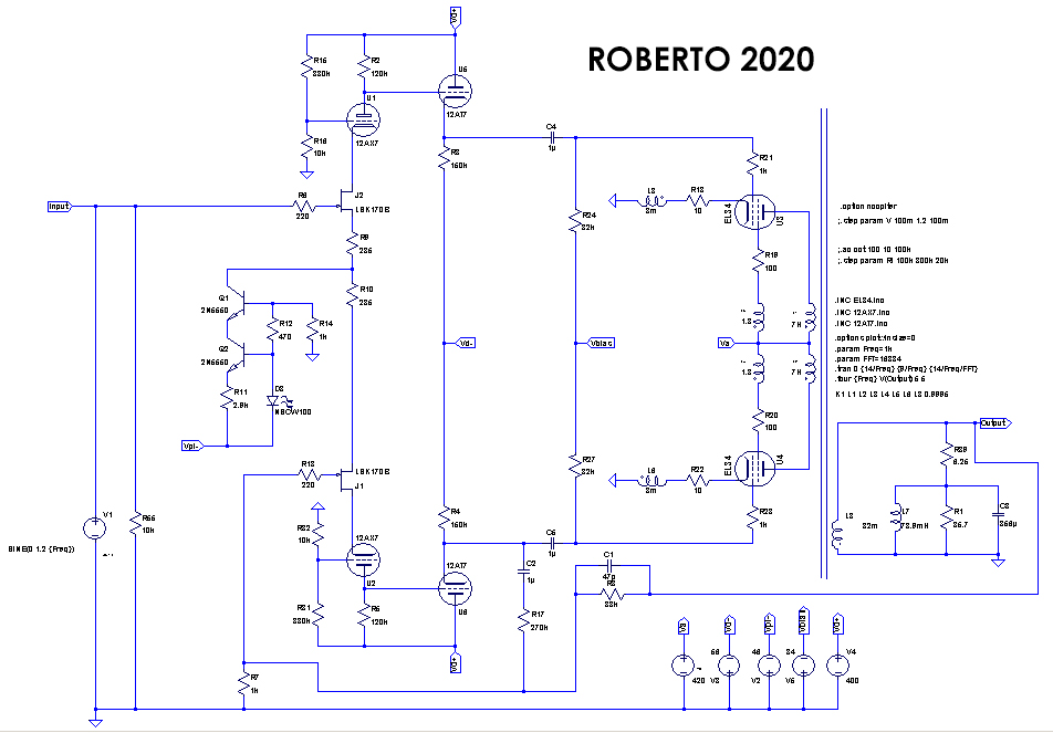

improvements on 12AX7 12AT7 EL34 schematic?
Yep fine - if you have built it make sure you have a few JFET's to hand so you can match. You can tie the gate to 0v and with a suitable source resistor (about the same current as in the CCS/2) get two with the same source voltage. There will be a big spread. That's the trouble with simulation everything is matched and looks good.
GNF to the second jfet will work well - its exactly what I did with the EL184 LTP. You can add a dominant pole by placing a series R+C between the two gates of the jfets. Looks an odd thing to do but gets round losing the drive at HF. Across the plates of the LTP will also work but you may run out of drive.

The schematic is attached:
- 12ax7 plate resistor is 120k;
- 12ax7 grid voltage divider is 220k 10k;
- CCS is set at 1.2 mA (600 uA per side);
- jfet are LSK170B;
- driver cathode resistor is 150k;
- RC feedback from driver's cathode to nfb jfet gate is 1u + 270k (gate resistor to ground is 1k);
- EL34s grid leak are 82k;
- EL34s have 40%UL + 0-4 and 4-16 Ohm secondary OPT used as cathode feedback;
- gnfb is 33 kOhm ||47 pF
- EL34 grid stopper is 1 kOhm, screen stopper is 100 Ohm;

I guess your taking some of the feedback from the driver cathode for stability. If you want the lowest distortion then it should come from the output. What about reducing the 1u with the 270k so that only the HF comes from the driver cathode. Just an idea. However the distortion looks very good on simulation. Are you building it in parallel and testing your ideas there?

OK this is more difficult to explain. Local feedback paths can be used to linearise part of the design without causing instability as the phase lag of the local paths is much smaller. So I think thats what you have done. If you decrease the 1uF to much smaller then you can take more feedback from the speaker at the lower frequency, and then as the phase lag gets large through the transformer (>20KHz) you start to take more signal from a local path helping with stability. Its a common thing to do with op-amps if your driving like an external buffer.
The simulator will account for this but only if you for example change the CCS by 10% and then see what happens. It only tells you what you want to know. I suspect you are correct in that the circuit does have this flaw and the operating point is very sensitive. Your not actually setting the JFET voltage you are telling the JFET to operate at a certain current and letting the source-gate voltage adjust to get to that current. The JFET is not actually a current source here. The two requirement are that the FET's are well matched and CCS does not forward bias the gate-source so you need to look at min ids when vgs = 0v
Thanks 6A3sUMMER, the answer to your question is easy: No, it doesn’t.
I know simulations have tons of limitations.
I also know that the experience of skilled EEs has no price, and this is one of the best places to learn and share ideas.
It seems to me that the total current is fixed, but not the individual current through each jfet. Each jfet has approximately the same drain-source voltage and gate-source voltage (not withstanding the effect of the source resistors), current under those conditions will depend on the particular device. Mismatching will show up as differing current in each leg, which will result in different anode voltages for the 12AX7's.
Can be fixed with a balance pot instead of fixed source resistors.
