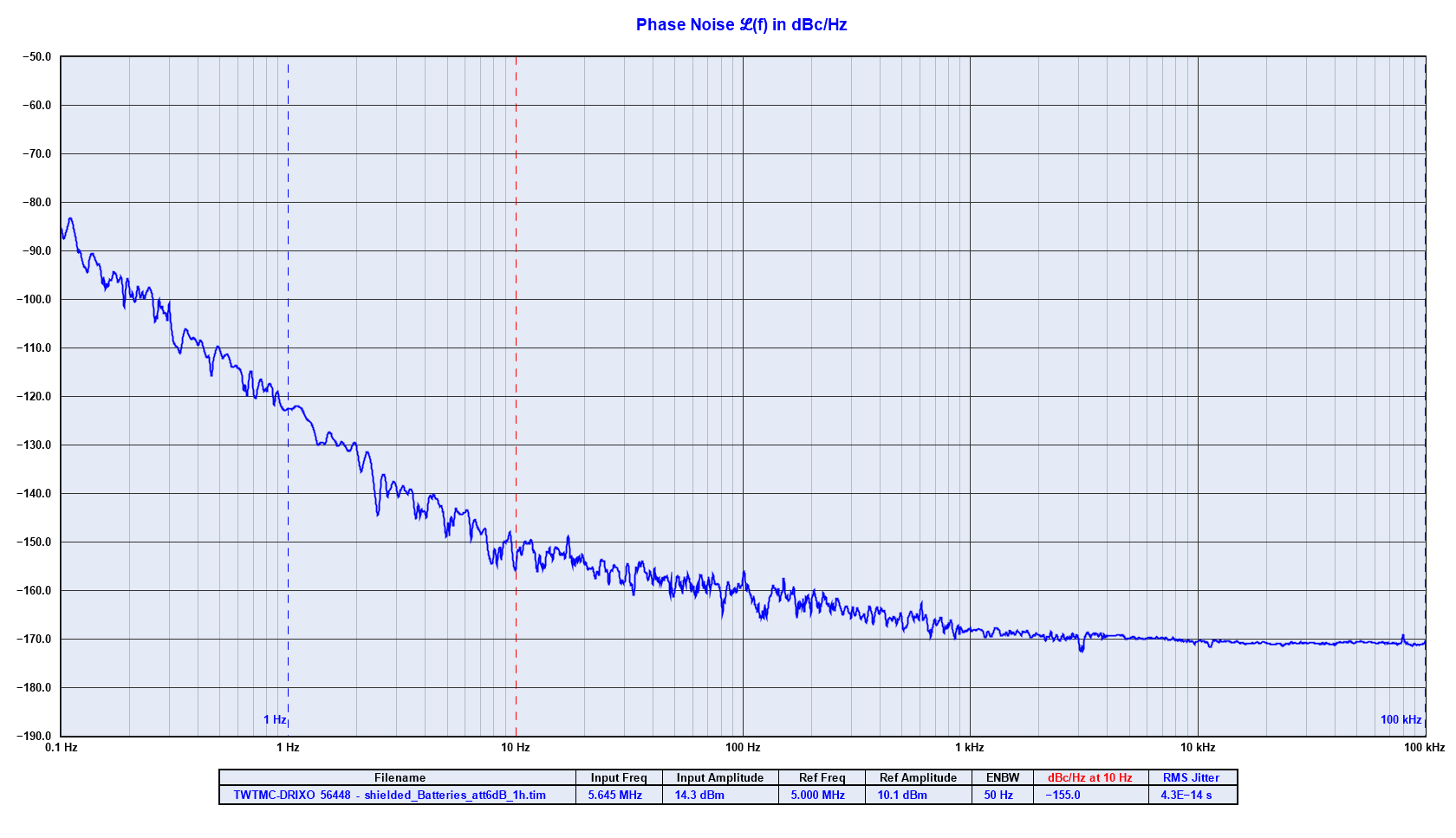

However, as I said several times (I'm getting tired) both SI514 and SI570 are very high phase noise oscillators.
It's clear from their datasheet and more clear from the measurements
Reference DAC Module - Discrete R-2R Sign Magnitude 24 bit 384 Khz
About the jitter calculation and the useless of that such measurements for digital ausio I'm very tired to repeat the same things, please take a look at this link where you can find plenty of informations
The Well Tempered Master Clock - Building a low phase noise/jitter crystal oscillator
P.s. Soekris specifies clock jitter to be <1ps, good luck with beating that, as that’s an excellent specification.
Not so difficult as you think, please take a look at the following plot: the jitter is 43fs and it's calculated with a suitable integration bandwidth, not starting at 100 Hz from the carrier like in the SI570 datasheet, that's a bandwidth suitable for telecommunication but not for digital audio.

In the real world we have measured at least the same phase noise of the base oscillator, simply because the oscillator has itself a phase noise of -155dBc at 10 Hz from the carrier that's very difficult to improve since this performance is almost the limit for the best oscillator on the market.
In R2R applicatione the crucial signal is just the LRCK so you can drive the DAC with a phase noise of -155dBc at 10 Hz from the carrier (or with a jitter - useless- of 43 fs if you prefere).
