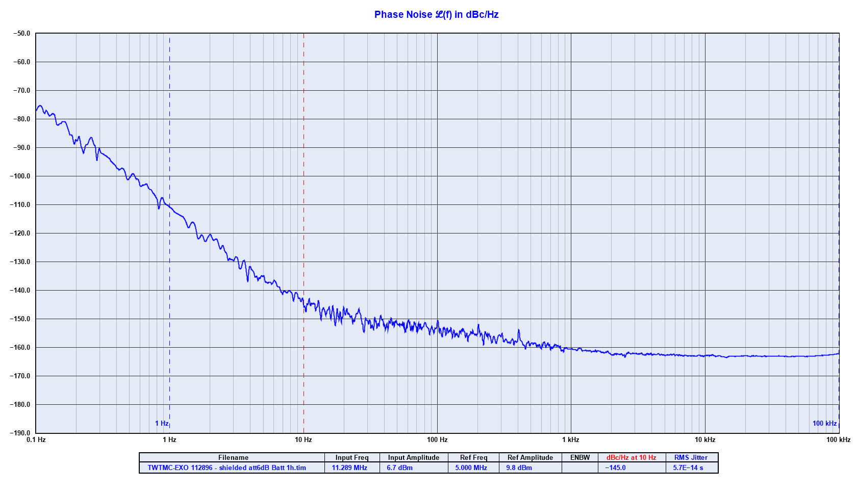

About the oscillators I have published the measurements that's the only technical documents I can provide, while others claim <1ps without providing any measurement.
About the influence of the close in phase noise of the oscillator on the sound quality I'm sorry but I cannot provide a physical equation.
The same as me and no one can provides mathematical equations to explain why a 2% THD DHT amplifier sounds better than another one with 0.000000% THD.
Just try the way and get your own opinion.
About Pat I was a friend of him, I met him in his labs in 2018, and I well know his opinion.
But if you have read the whole thread around 3-4 years ago I wrote that I would have designed a 11.2896 MHz oscillator with a phase noise of at least -120 dBc at 10 Hz from the carrier.
I did bet one dollar with Jocko on this challenge.
I won the challenge, my 11.2896 MHz oscillator is -145 dBc phase noise at 10 Hz from the carrier, 25 dB better than i did predict.

Yes, and the more "clear" crystal you'll use, the more divider noise will dominate, give it a try!
Yes, and even Crystec CCHD allow something more or less like this being properly choosen and divided.
By the way - why you riding a spiral around DAM? Design yours PCB and forget about.
It looks like you have not read carefully, I have already tried and the divider performs equal or something better than the state of the art base oscillator (not the crappy Crystek).
You should measure instead of claim unsupported statements.
