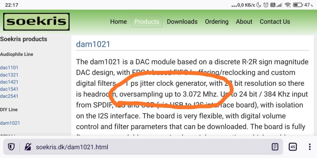

Are you properly understand this device?View attachment 904743
It looks like you are not understanding how a R2R ladder DAC works.
The oversampling is done in the FPGA of the DAM1021.
I will throw out all the front end of the DAM1021, saving the swithes, the ladder networks and the power supply.
So the oversampling is gone, but if you like oversampling you can do the job with the PC and then you can feed the FIFO buffer with the oversampled data.
There are lot of applications that do oversampling.
Again, when such a central part as OS / Filters is taken away, what is it that in the end you will be able to compare?

It's true, indeed I'm designing my DACs, Lite and Top version.
I would just trying to improve the sonic performance of a DAC that IMHO implements a not properly designed front end (the PLL tracks the input).
So the only way is throwing out all the front end because I cannot access the firmware source code.
The tolerance of resistors in the ladder limits the resolution to around 18 bit with the 0.001% resistors I will use in the top version.
Maybe 18 bit are enough.
IMHO the old 16 bit TDA1541A is one of the best DAC ever designed, maybe the best ever, while I have several doubts about modern delta-sigma DAC (today there are no R2R DAC chip on the market).
Moreover we are thinking also to a "one time calibration", but not "self calibration", another great error IMHO.
