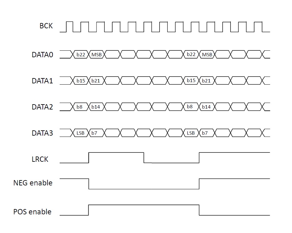

There is a big difference:
- I answer all the questions from the users
- I did not ask the designer to share the schematic, I did ask a few infos in order to implement the update, there is no need he shares the schematic
- I have published a diagram and a data protocol for confirmation, so he could simply reply yes or no
- and I will publish the protocols used in our new FIFO Lite and DAC Lite for the members who like to tweak the boards

I have just discovered that the protocol I have published (coming from a quick view of the board without gears) is not correct, so I have to waste more time powering the board and analyzing data by the oscilloscope.
The voltage level shifting was obtained by AC coupling of all the signals coming from the FPGA followed by a resistor reference voltage for the 595s (positive or negative).
That's quick and cheap way but not what one expects from an absolute DAC.
The dirty signals (BCK and DATA) share the ground of the crucial signal (Latch) for a R2R DAC.

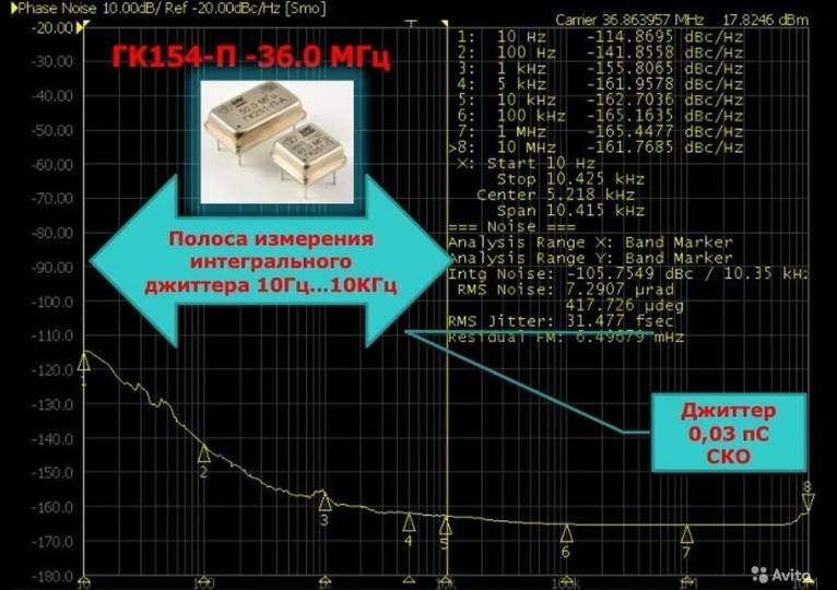

It depends exclusively on the phase noise of the output masterclock, since the latch comes directly from the master clock and it's well isolated from the FPGA and the micro, so from the input.
And ours oscillators are really low phase noise, in the region of BVA and BT ULN.
