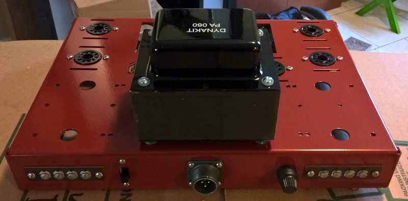

Good Thursday everyone,
This is how I solved using a 3 wire power cable. This is a standard military/industrial connector. You can find them for $10 or less on "that" auction site. I found the mating connector with power cord already attached for $1/per. Bought 25 though I will never, ever use 25.
Ray

That's quite a nice solution, and those military connectors are bulletproof.
Also, because idiots keep doing it, please, please, please do not use XLR or SpeakON connectors for power applications. I see people in upper-level EE classes doing it, and it drives me insane. Aside from the obvious safety concerns, someone will inevitably plug that XLR into the input of a power amp or (worse) a console and blow it up.
Wow, that's a staggeringly bad idea "let's use a low level signal connector for a high voltage source capable of delivering high current"
