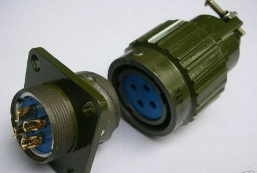

Here's a nice solution, bayonet MIL AC connector set. 500V 25A, $7 set
1-set Military Gold 4-Pin Male Radio Female Circular Connector Y2M4ZJ + Y2M4TK | eBay
I think for an authentic "retro" look tube amp though, I would still want something like the old Amphenols. And they are so practical besides. Round chassis hole, fits an extension cord. Bullet-proof.

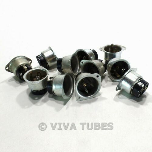

Not sure about knock-offs, but the original Amphenol multipins connectors are bulletproof.
I'm not a fan of those old Amphenol chassis mount "Edison" plugs. I'm sure they work great, I just can't stand the look of them.

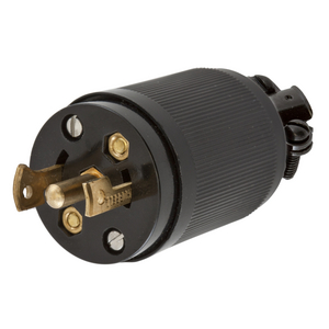

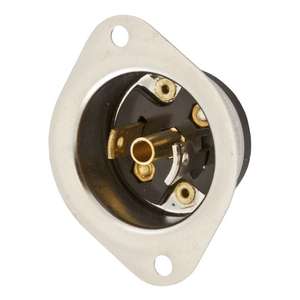

Finally found what I've been looking for. Mini Twist-Lock connectors. (Hubbell) 1.19 inch diameter.

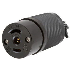

I saw something like these on an old sewing machine once (even smaller, like 0.75 inch diameter). But searching for sewing machine connectors was futile. Seems Hubbell has a new take on this now, with an extended center ground pin for safety when inserting or removing a "HOT" cord. (pics 4 and 5)
NEMA standards:
NEMA ML-3P and ML-3R were the older 3 pin version, without the safety -extended- ground pin.
NEMA ML-2P and ML-2R are a newer 3 pin version, with the -extended- safety ground pin. These would be ideal for DIY audio amps, just what the doctor ordered. A round mounting hole, you can get a steel or SS mounting shell. Like a miniature version of the old Amphenol / Edison connector.

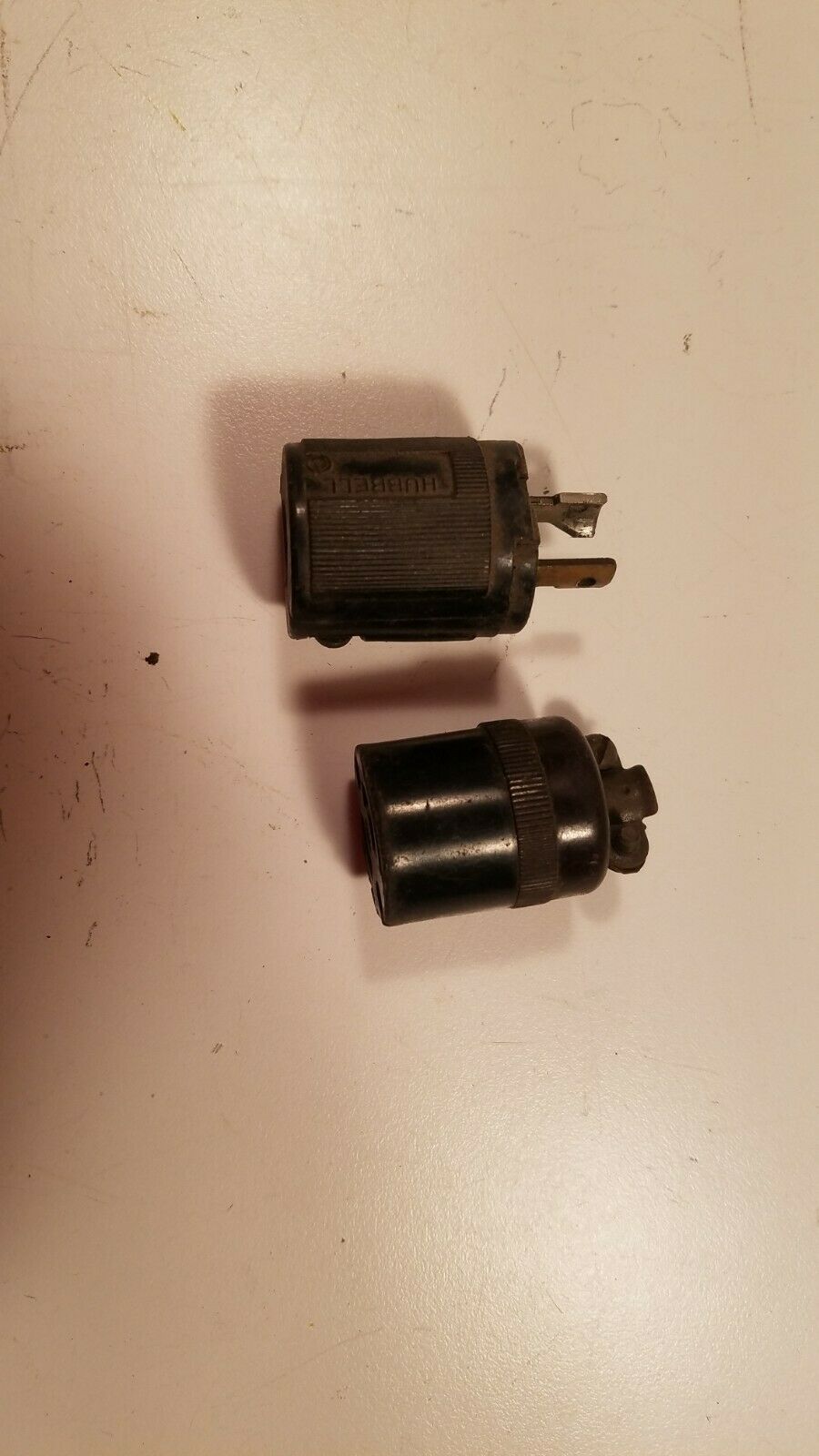

AHa, here is the old sewing machine connector. 3/4 inch diameter. Two prong. Probably Bakelite, instead of the Nylon now.
Vintage Hubbell Small Twist Lock Electrical Plug Connector | eBay

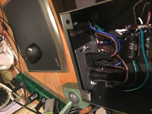

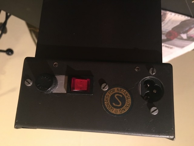

It worked out well! Managed to convert a Quad II to use an IEC C5/C6 connector with no metal work, apart from some 1mm alu plate to mount the socket, and also an illuminated switch and fuse.
