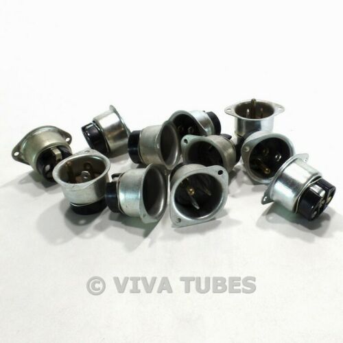

Used to be able to get these Amphenol AC power chassis plugs, mounted on a typical metal Octal chassis plate. I don't recall if they made a 3 prong version.

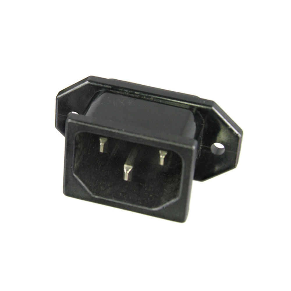

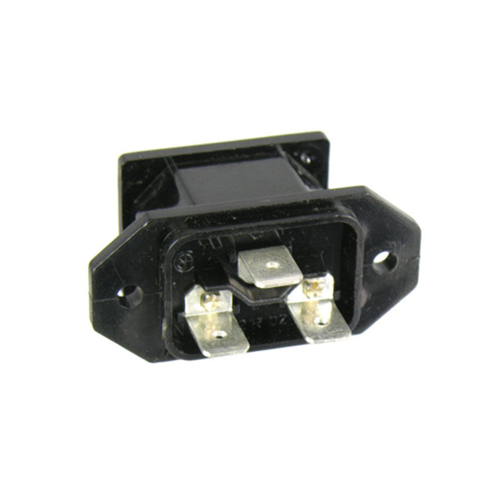

Another scheme could be to get an IEC connector that has -just- push-on wire flat tabs on the back. (no rectangular body thru chassis) Then just punch 3 holes with the corresponding pattern for the tabs to come through the chassis, plus the two small mounting screw holes.
Well, Amphenol -DID- make 3 prong power chassis connectors. Recessed ones even. Can just use an extension cord with these.

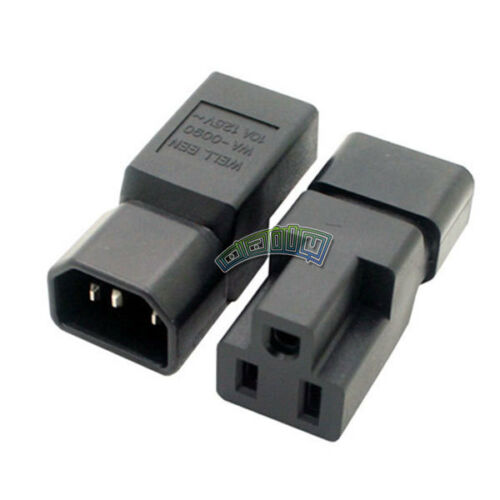

Some one needs to make an IEC version like this. Easy to mount with a circular punch out. Maybe it already exists? Here is an adapter.

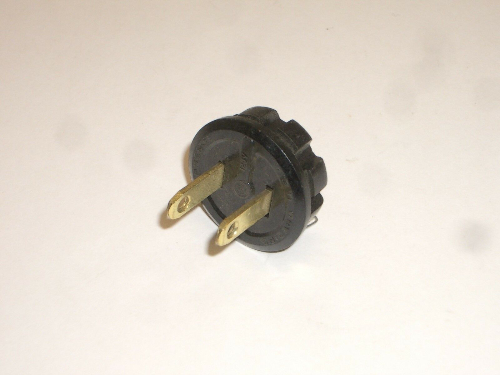

I had forgotten about those round Amphenol. Kinda cool. Didn't they make a 2 prong version that was used for years?
Yep, 2 prong oldies, then the 3 prong ones came out.
Some of the really old scopes and test equipment had the 2 prong ones. Later, 3 prong.
