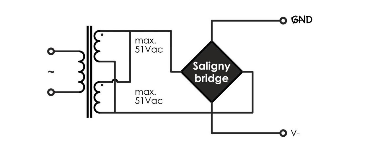

Hi tvicol
May i connect the Saligny like this, to use just the negative voltage.
