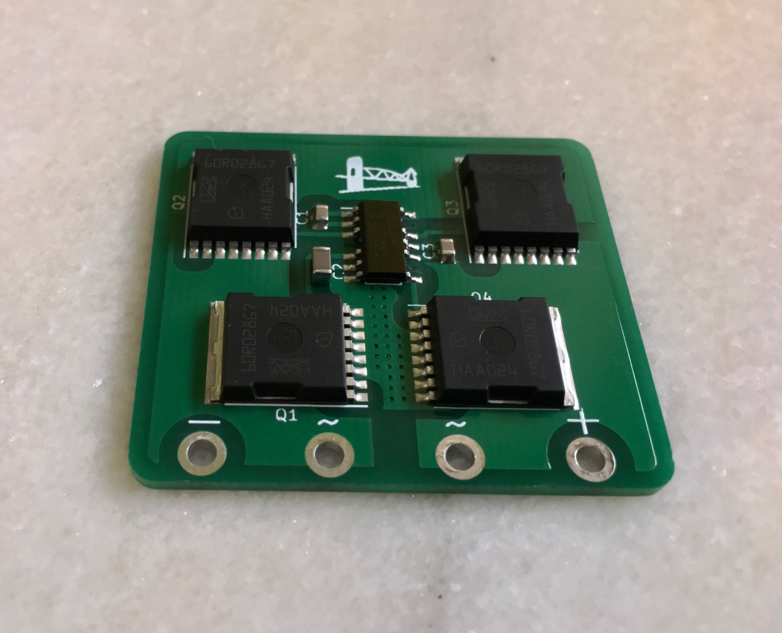

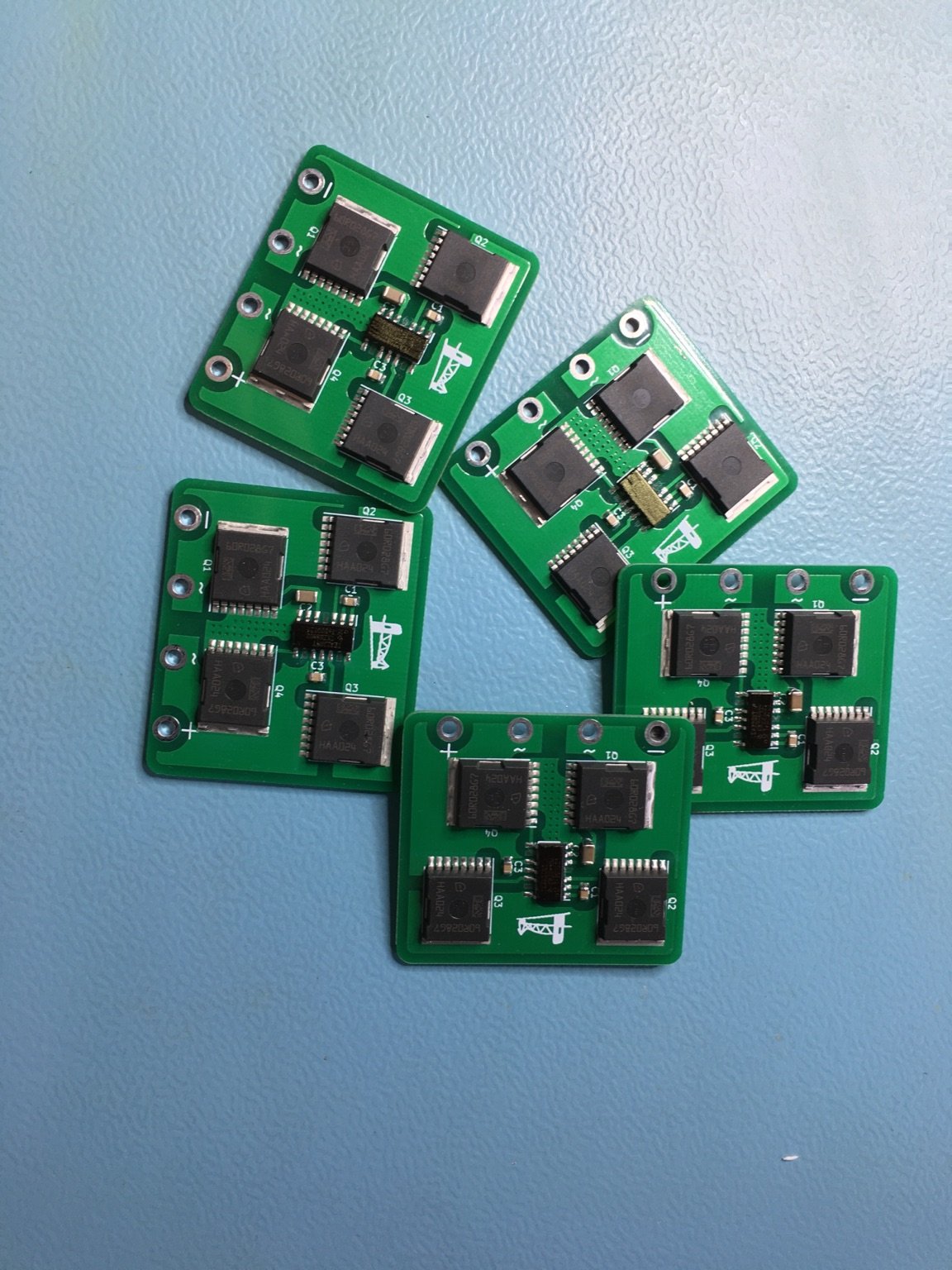

New product Saligny HVHC
SalignyHVHC - synchronous bridge high voltage high current
maximum output voltage 450Vdc
maximum operating frequency 200Hz
maximum sustained output current 22A
peak current output over 100A
Will be available in 3-rd group buy.
