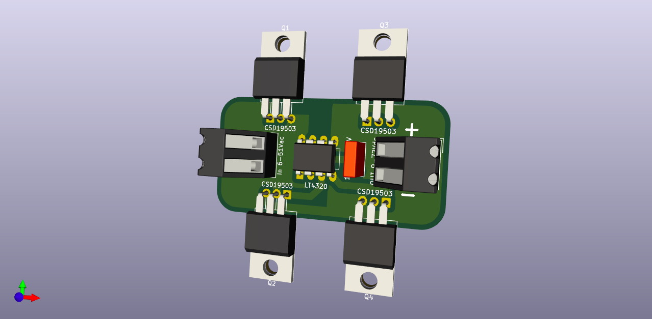

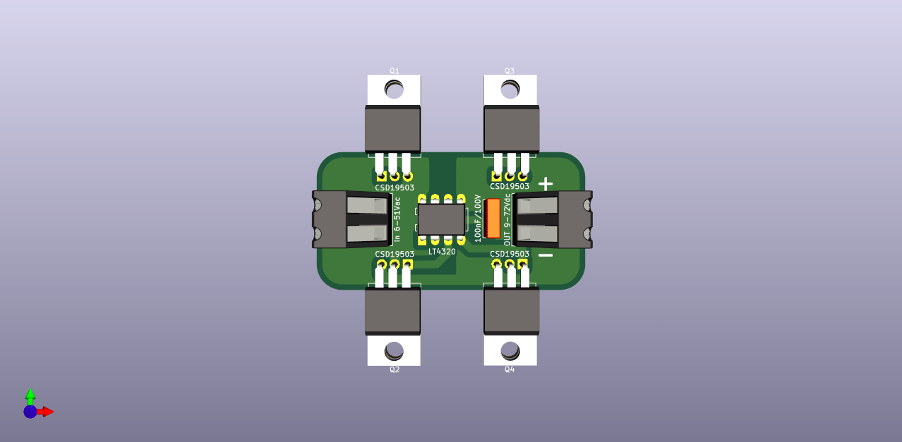

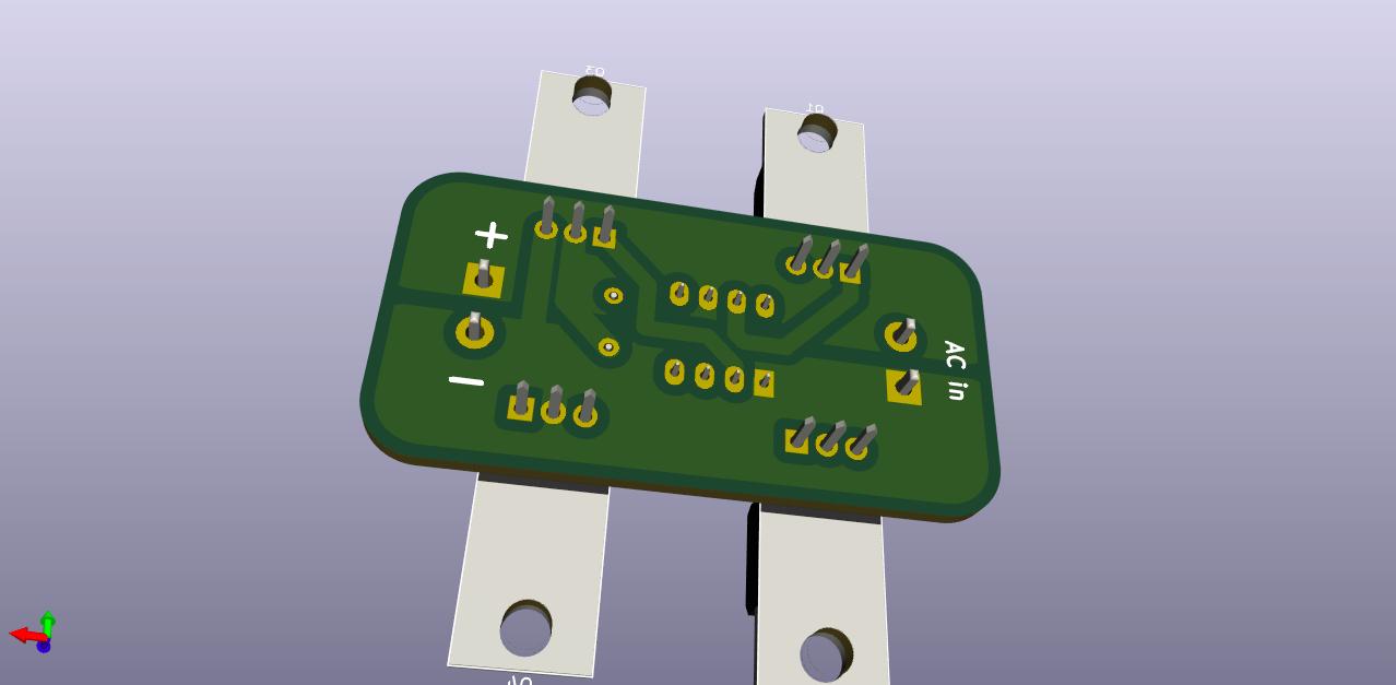

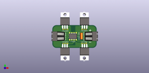

Fo those who are looking for a THT version here is Saligny THT as open-source.
Archive contain source files and gerber ready for production.
Feel free to use and modify for your DIY projects !
Tibi
  • SalignyTHT.zip
    SalignyTHT.zip

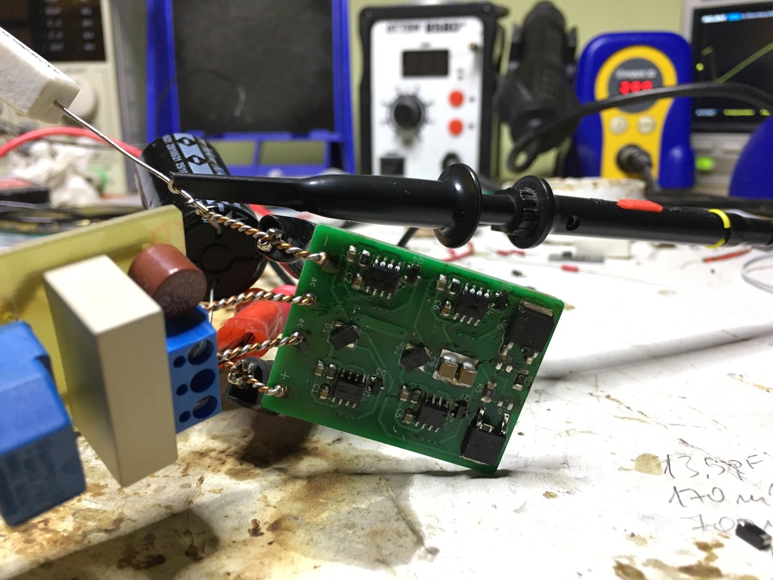

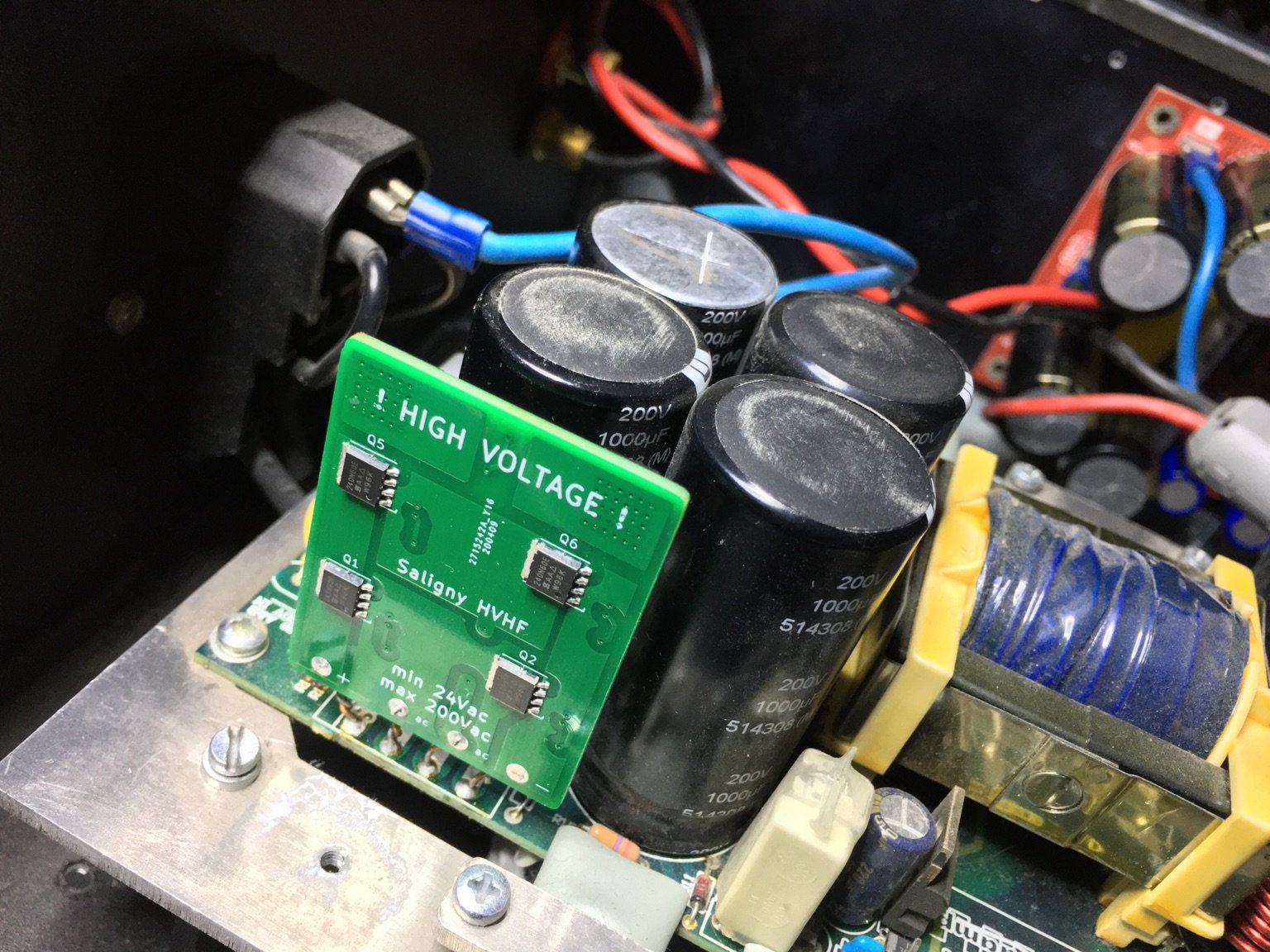

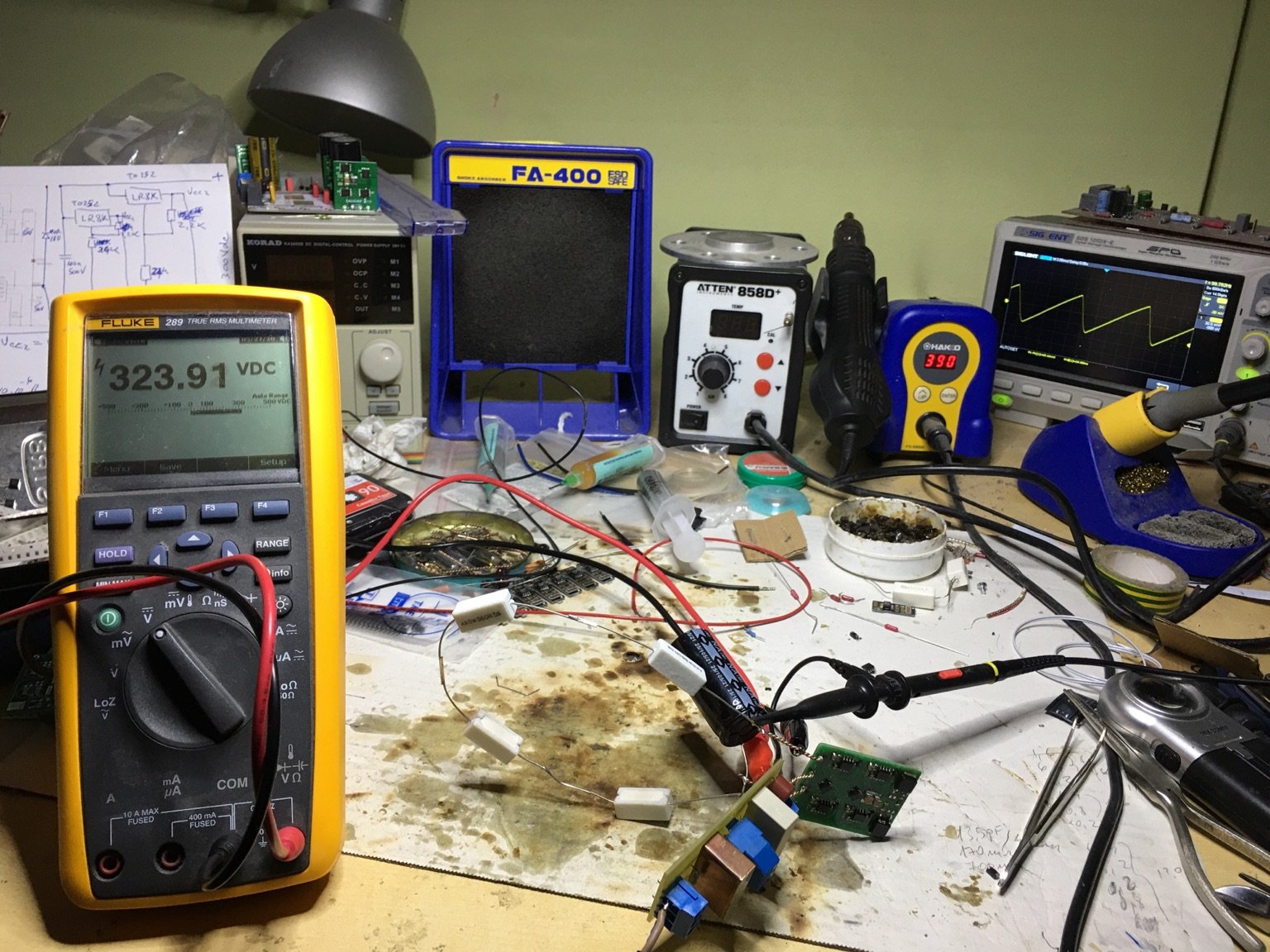

Saligny-HVHF exceeded my expectations. This is the best bridge I have designed.
As it is, will run up to 600V at max 100Hz and with external 15V@4A power supply will run up to 500KHz.
It may be used in almost any amplifier and will bring important improvement.
Compared with LT4320, the drivers I have used in Saligny-HVHF are able to drive the most demanding mosfets with large gate charge and capacitance.
The fantastic part is that I have tested this bridge in several SMPS and every time the output noise almost vanished on my scope. Right now I rediscover my amplifier. Noise floor is soooo low.
Now I'm confident that I have a very good product and will open second Ideal Bridge Group buy.
Tibi

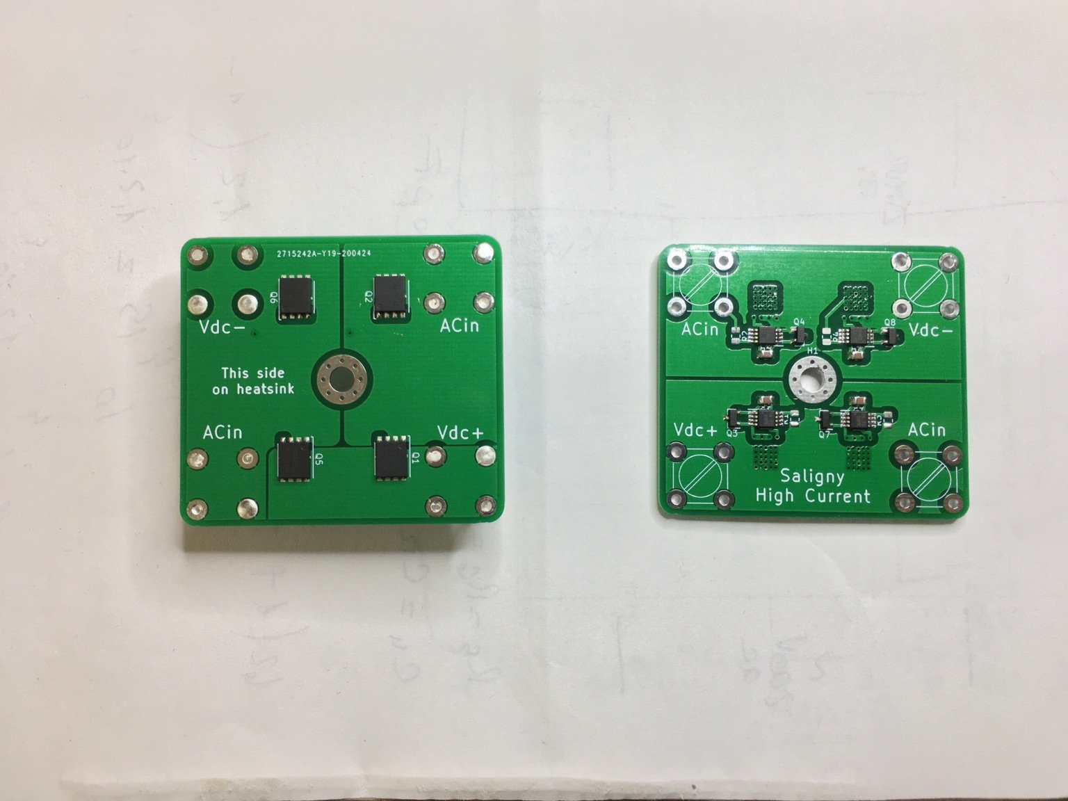

While I have enjoyed my "new" amplifier with Saligny HVHF, a new bridge has been born.
Proudly present you Saligny HC - High Current. A beast that make use of under miliohm mosfet's to deliver 100A with only 8W power dissipation. In fact mosfet's are rated at 382A continuous.
This bridge will save you when you are hungry for power and I mean really hungry. 🙂)
The downside is that will run up to 30Vac rms.
Tibi

Another good news.
Saligny HVHF and Saligny HC will run in any topology. This include centre tapped transformers.
Yessssssss!!!!!
Tibi
