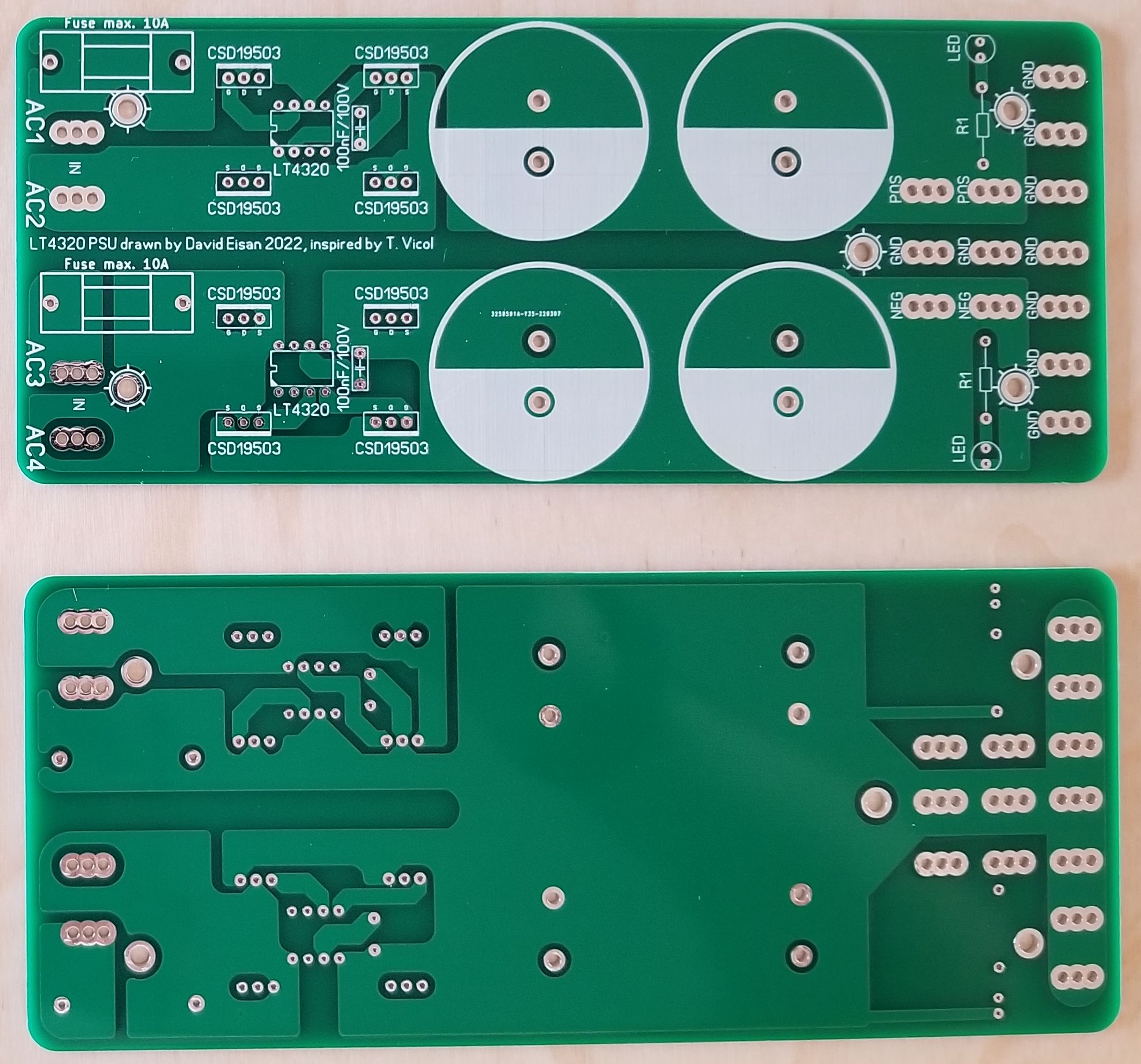

Here is the LT4320 THT PSU I came up with based on some of the work tvicol has posted here in this thread and on his web site.
I have not soldered up a board and tested it yet, so I hope it works like I expect...

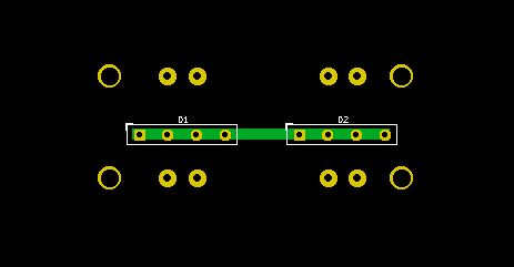

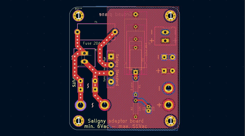

I'd like to have a PCB for proper mounting of my Saligny Standard.
It's my first PCB design, could someone open the gerber and confirm it's correct?
I'll be installing terminal blocks for AC & DC.
Any advantage to double the copper traces (parallel traces on top and bottom)?
Traces that are going to mosfet gates do not need to be thick, in fact a thin trace that have some resistance, is recommended.
Use top and bottom traces and viases, to minimise resistance where is needed.
Screw holes are too close to fuses and power connector, this may lead to hazard issues. ...
On large capacitors use thermal pad, otherwise soldering will be very difficult.
On bottom, remove ground-plane from input and make it continuous in the rest of the board - follow my design.
Tibi

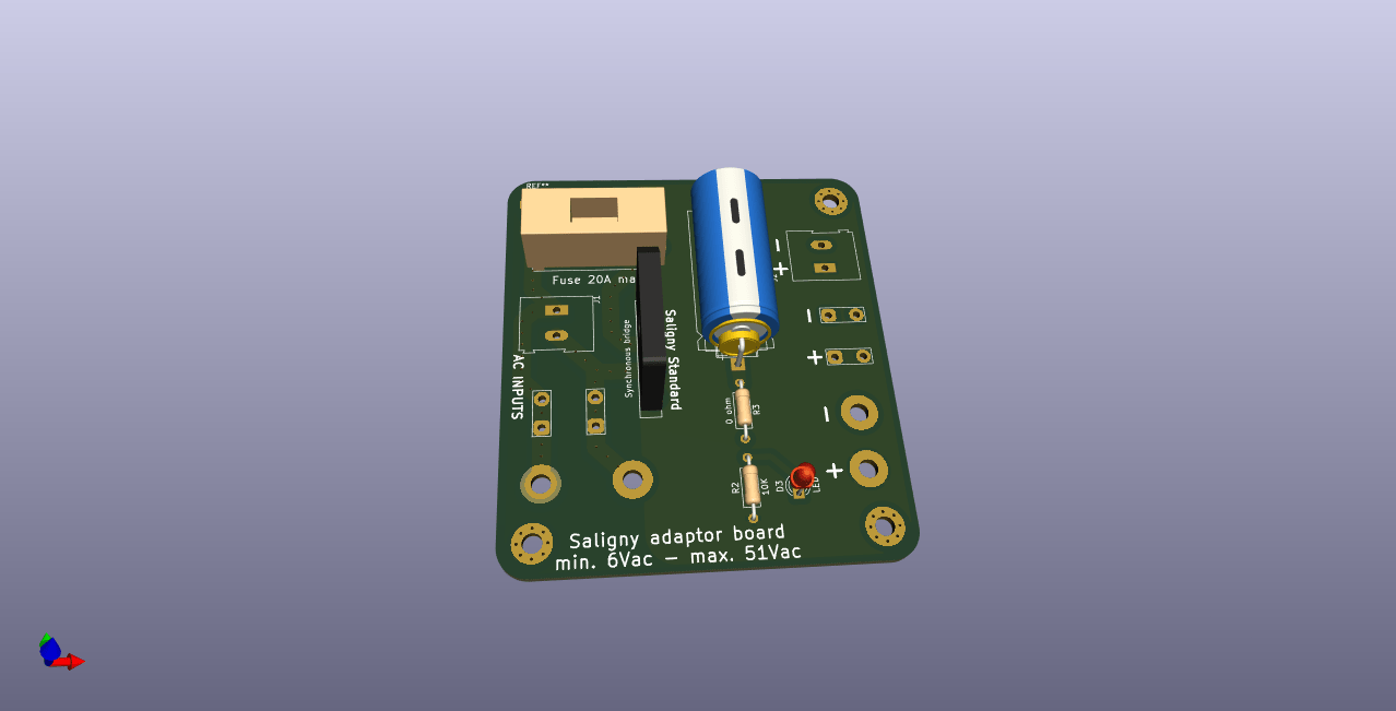

I'd like to replace the four mopnolithic bridges with the Salignys, but with a clean and proper mount.
For now, they are mounted the ugly way, with plastic standoffs to pinch them in place, and exposed wires at the pins.
The actual CRC PCB stay at the same place, I just want an additional PCB between the toroids and the PSU boards.
Here is a project I made some time ago.
It is Saligny Standard, an optional MKP capacitor and a led + resistor as indicator. Please note that R3 - 0 ohm is there only in case a normal diode bridge is used and in that case must be adjusted to form a snubber. For Saligny rectifiers R3 is 0 ohm and a wire can be used.
It allow screw connector, bananas and direct wire soldering.
Hope this is what you need.
