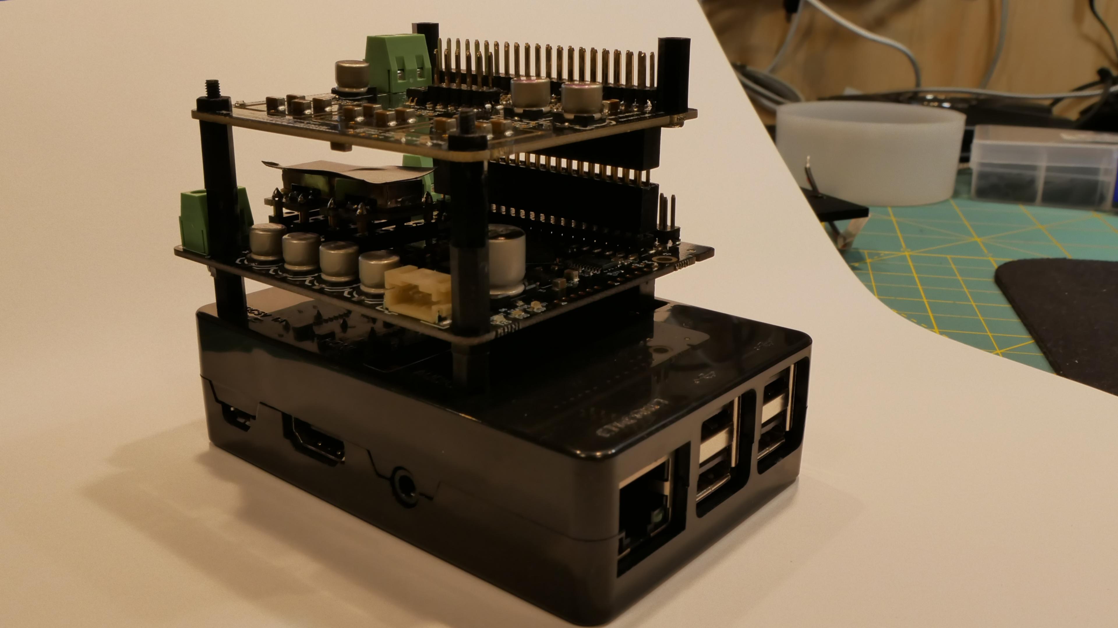

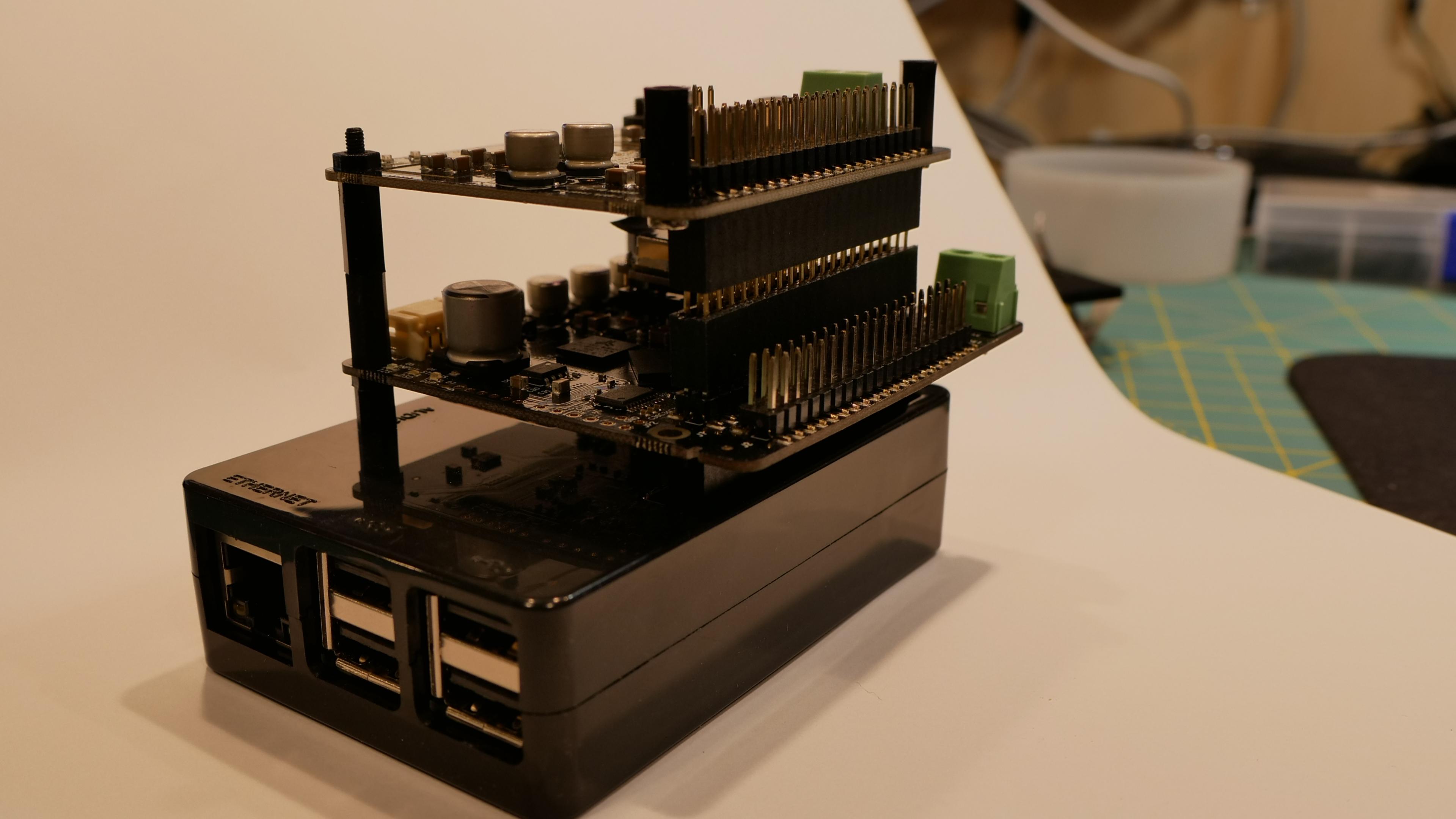

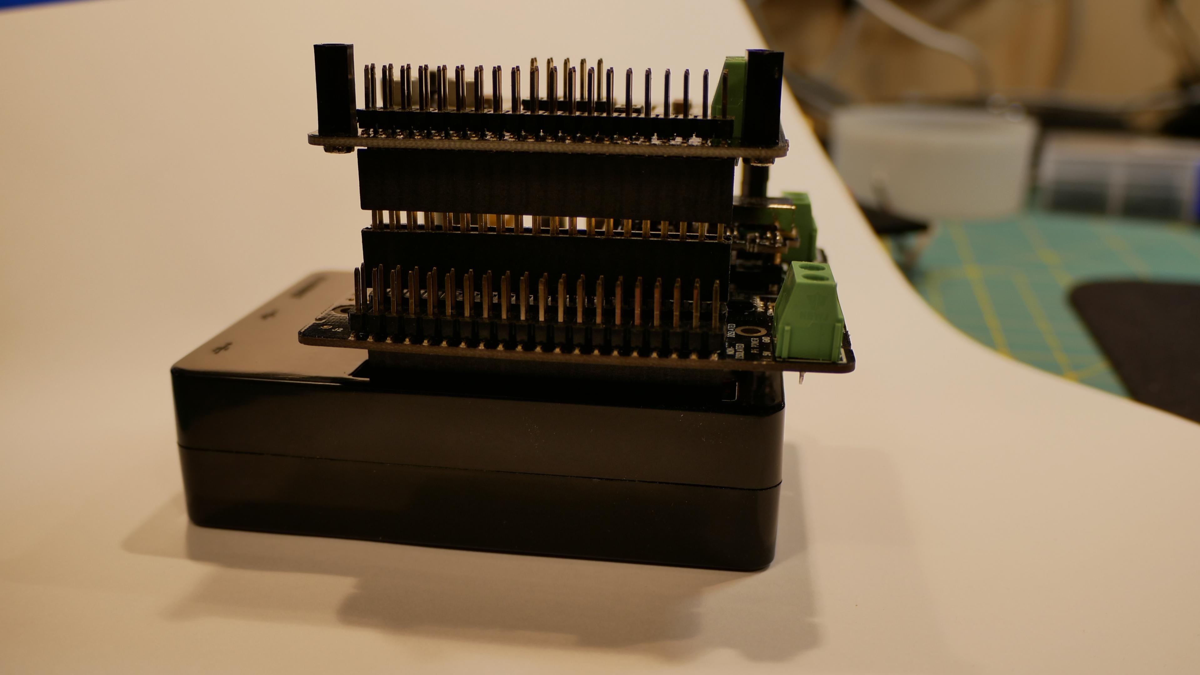

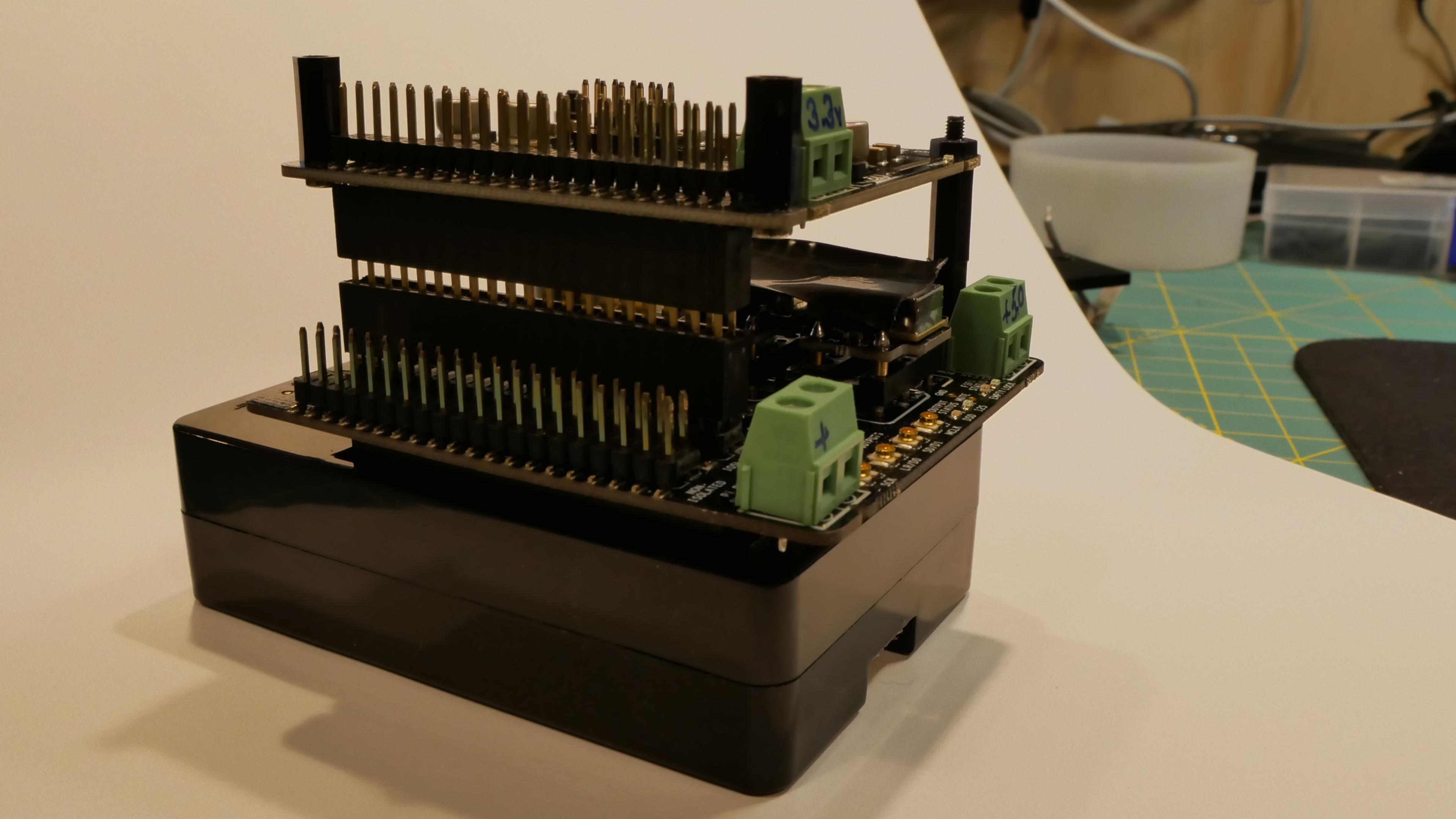

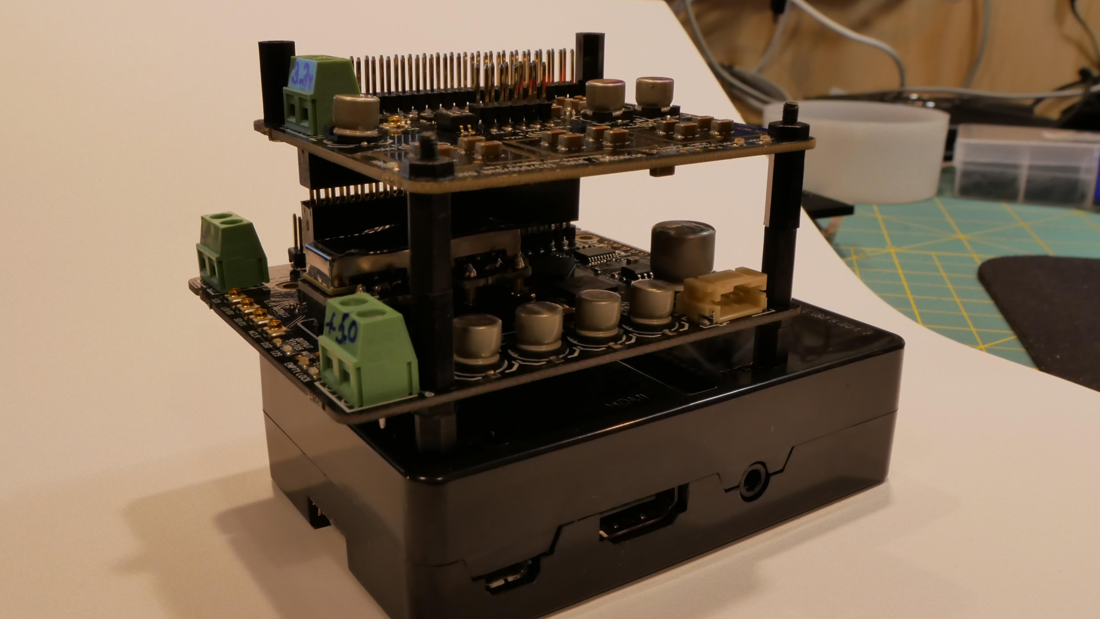

Wanted to post a proposed "DAC stack' customized for my planned enclosure. Using some 40-pin socket extenders (both 8.5 and 11mm), I was able to get the RPi, FifoPi and Dual DAC boards separated some, and the overall height to come in under my case height constraint of ~84mm.
As you can see from the pics, I took one of my plastic RPi cases that already had the opening for the GPIO connector that was very minimalistic to start as my base. Just to help with any stray RFI, I made a Faraday cage simply by lining the pi case with copper foil. I then added the first extender to raise the FifoPi roughly 15mm from the Pi (8mm from the plastic top). I then added another extender to raise the DAC board about 11mm above the Crystek clocks. Previously, they were so close to the DAC I had to use a small piece of electrical tape as an insulator so as to avoid any potential shorting with the bottom of the DAC.
I think this arrangement will work as it separates the boards and leaves enough room to the side of the DAC for regulator(s) I plan on adding. The I/V Std board will be connected with a piece of ribbon cable from the 10-pin header on the DAC. This way, everything will clear the top of my enclosure fine. The small ESS controller display will be moved to the front panel using the extender kit Ian offered in the GB. Anyone see any issues with this layout?
So far I'm very happy with the sound and it's made listening to older CDs (ripped to FLAC), and played using roon a real joy. Just about everything I've done to the DAC has made an improvement. Thanks to Markw4 for his added encouragement and guidance.
Rick

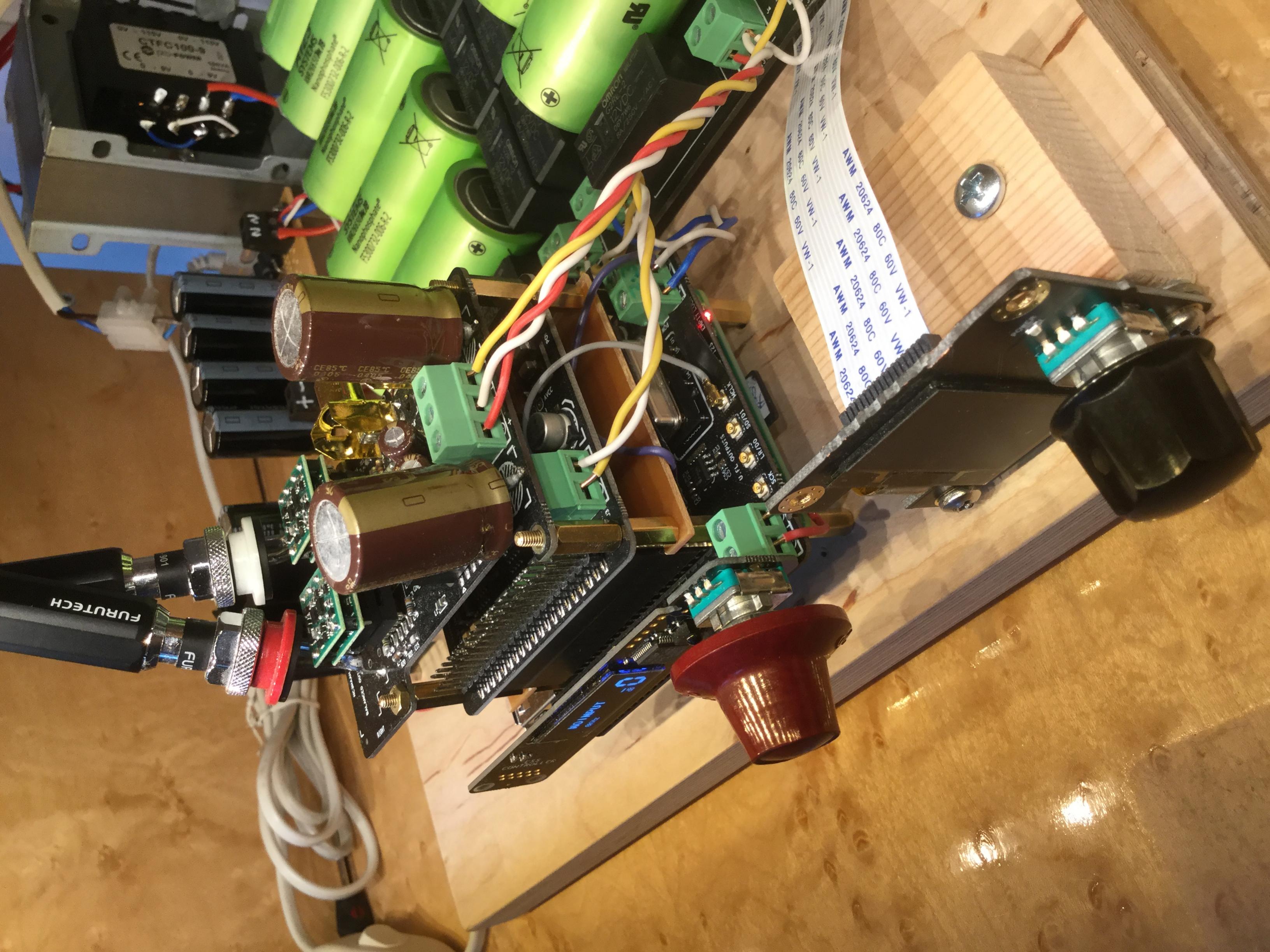

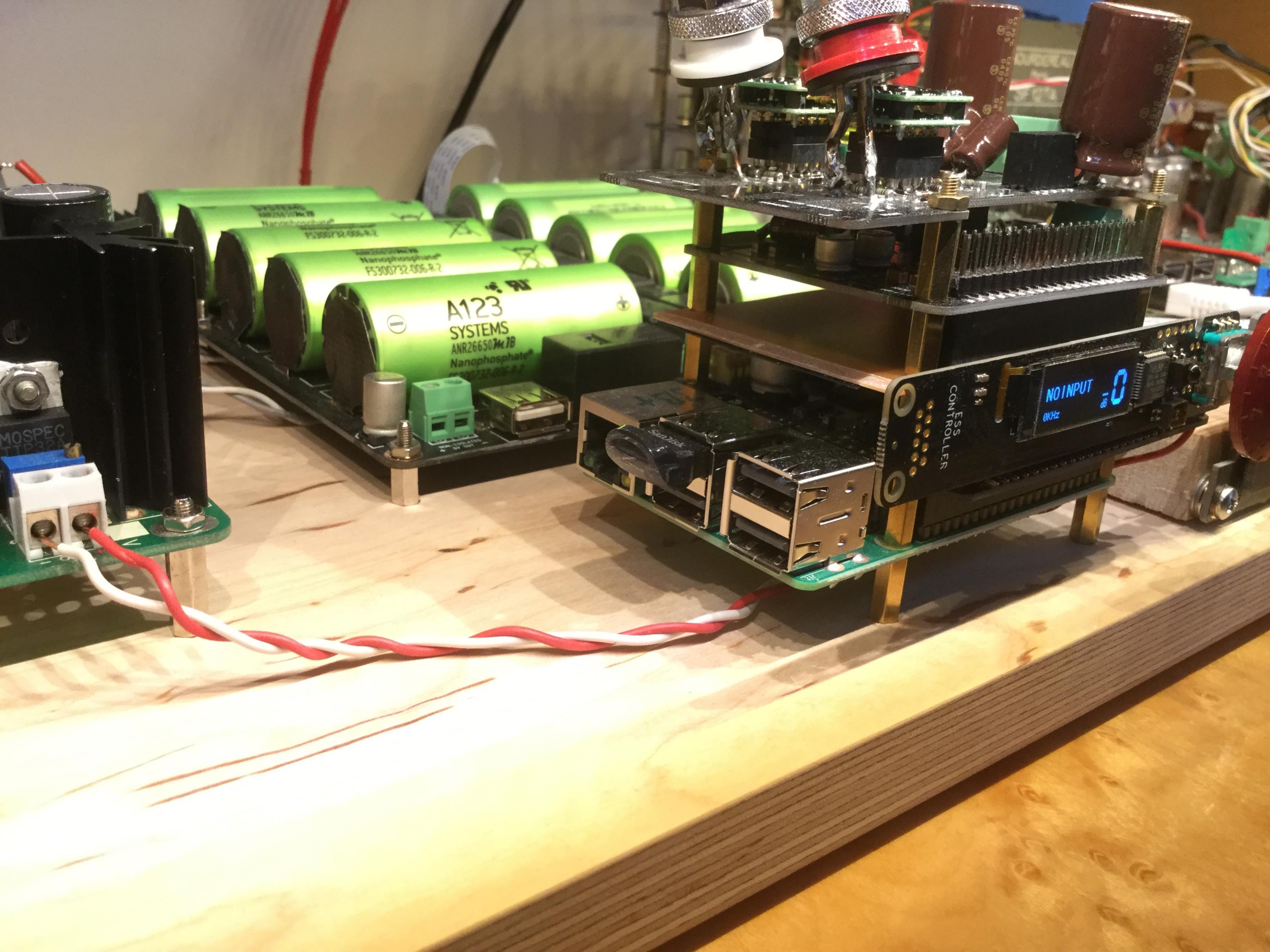

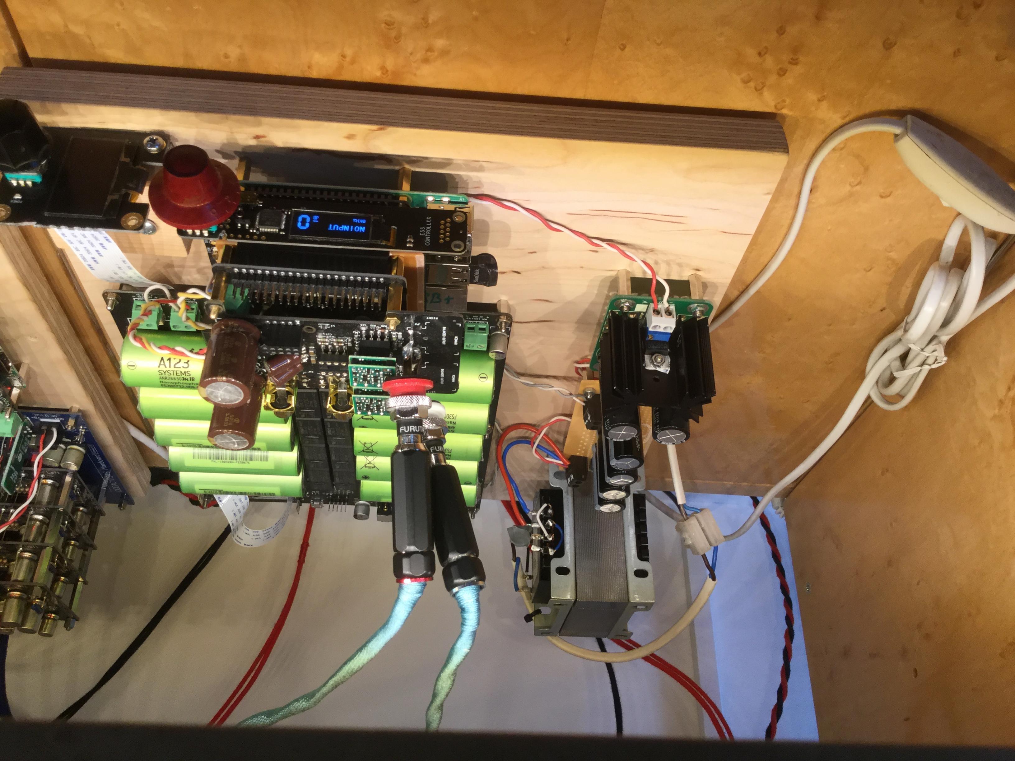

Isolation shielding
I have made a nice isolation shielding out of a bare pcb plate (one covered with copper surface and without holes, used to etch pcb’s)
The shield is placed above the fifopi and connected to ground (purple wire) of the fifopi (I do not know if it is the best place to ground).
I did not make comparisons yet, but it looks nice. An extra gpio pin header is used for more clearance (this must have a negative effect due to longer data paths)
I also made a simple linear power supply with a 100va transformer, some shottkey diodes and capacitors. The small ps in front is for powering the rpi.

Nice isolation innovations
Two very cool approaches to isolation.
redjr sounds like you are enjoying some great sound.
Supersurfer, that looks like a 4 level DDDAC in the back ground. When you get Ian's stack all sorted, it would be interesting to get your impressions of the sounds of the two sources, particularly when they have similar clocks. I used the same PCB stock for isolation. Your implementation is quite neat.

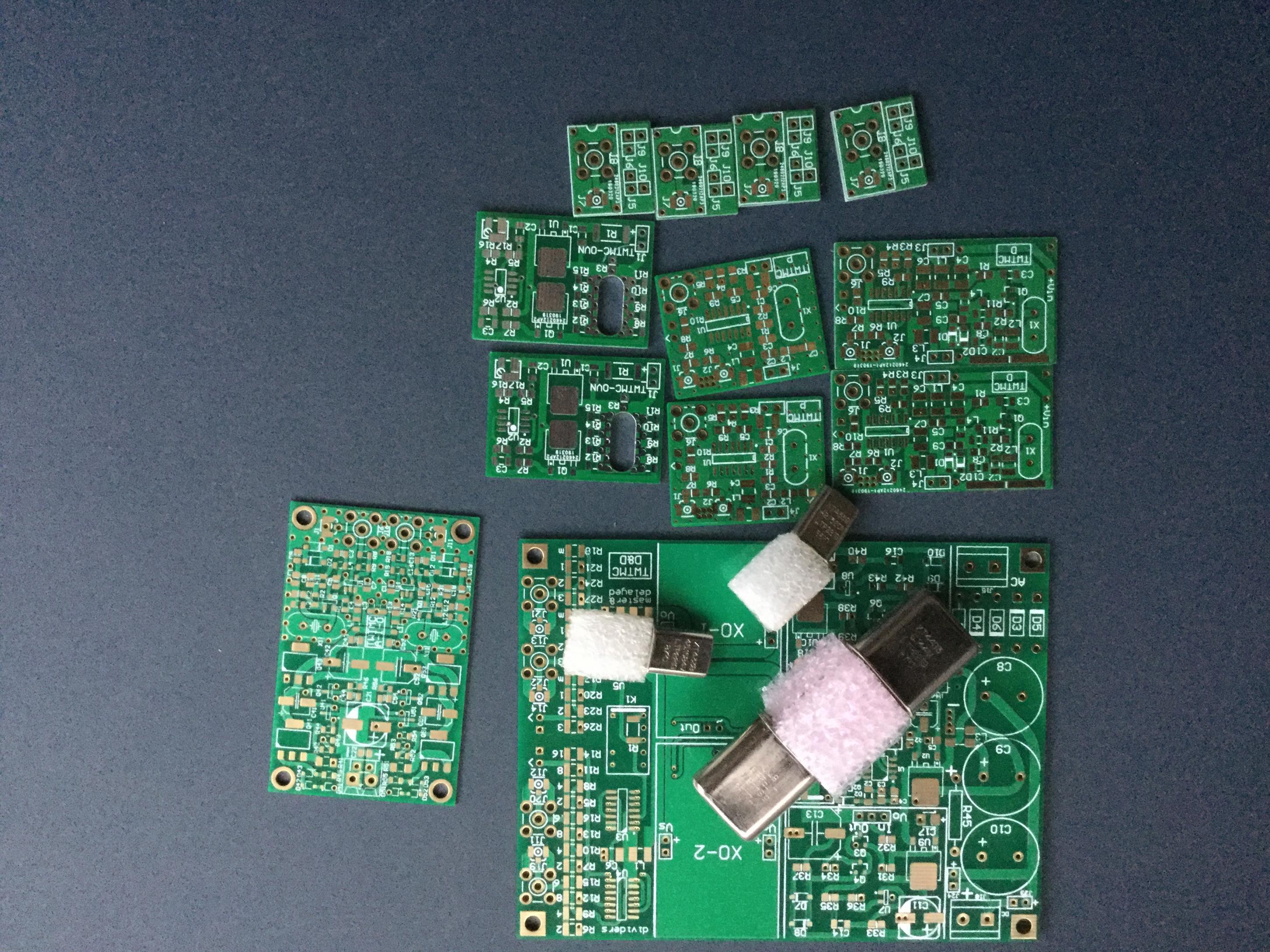

Hi Wlowes,
If I remember well you were also present on the dddac thread some years ago. The dddac is modified by me to a great extent with a big improvement in sound, Doede has implemented some of my mods in his latest revision of the dac boards. It is interesting to have an ESS and Doede’s NOS dac next to each other; two completely different approaches.
I am not finished with tweaking the ESS dac but it is playing pretty well already, although the dddac is still the better one in detail retrieval, the ESS is very smooth in comparison (probably for a great part due to the AC and battery PS difference)
I just received the Andrea Mori crystals, so up to the next improvement!

Supersurfer
I found the DDDAC project most interesting. While I never built one, I got a number of ideas that went into my dac project.
I will follow your clock upgrade with similar interest. I am waiting delivery of a 45/49 SC + oven. Initially I will replace the 45 NDK SDA with the 45 SC clock. In hindsight I probably should have just ordered a single 5mhz clock as I really only ever listen to redbook and the specs are compelling….future project. Should be a fun adventure.
The alternate test dac I started working on is getting pretty close to finished. It is sounding very, very good using HQplayer's highest quality upsampling to DSD512 settings. Really, it leaves any RPi dac in the dust for now, at least until there is a way to do RPi DSD512 (and with stereo AVCC). I keep trying to explain that power supplies, caps, and clocks can only do so much. Some people here are spending a lot on exotic parts for what in the end can only be mediocre sound quality, IMHO, given the limitations mentioned above. Pics can be seen here: https://www.diyaudio.com/forums/digital-line-level/314935-es9038q2m-board-454.html#post5817792
If anyone would be interested in building a dac more or less like that one, I would be happy to advise on mods and or settings that are found to help.
